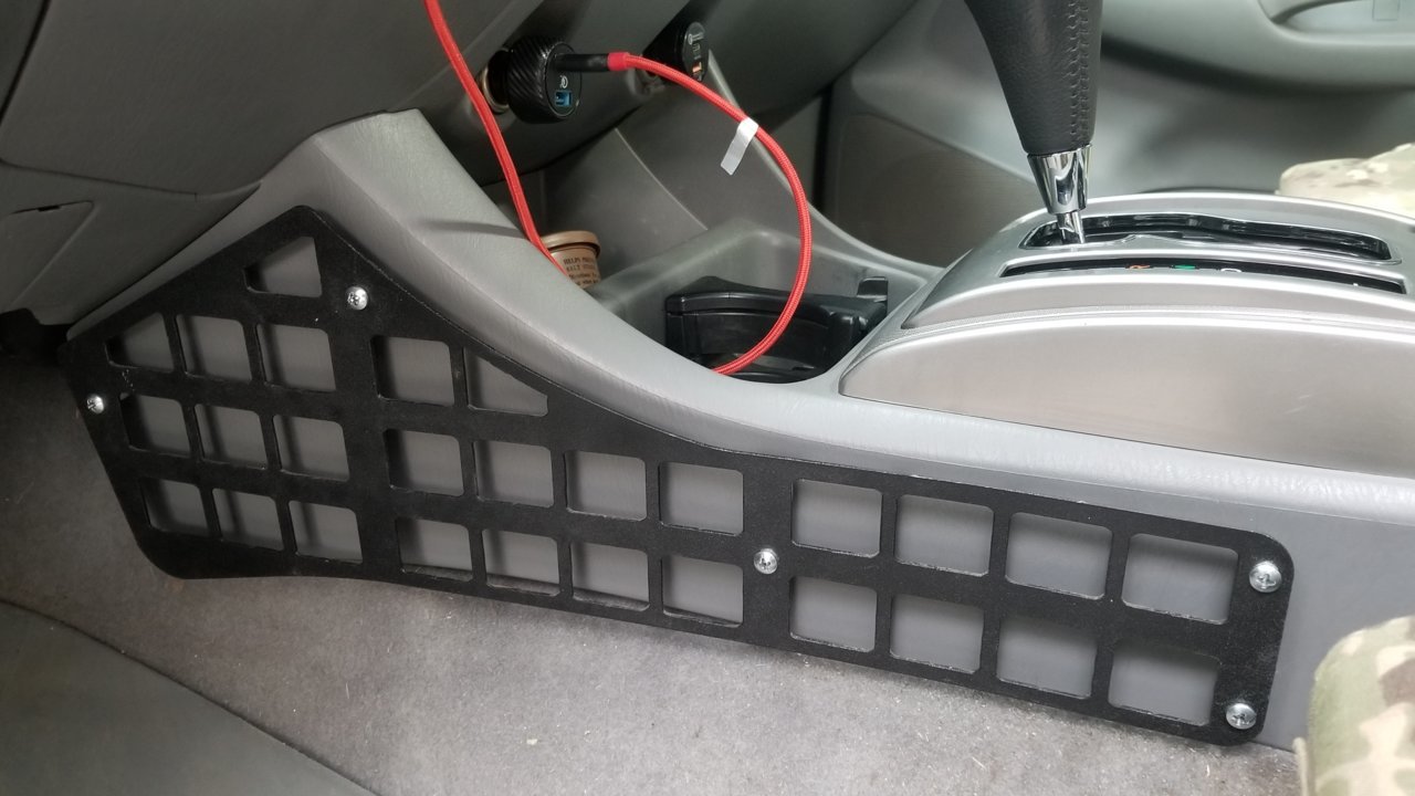

    Haven't made it on yet, have tried quite a few times!
    Got my @HolyHandGrenade's used second hand molle panels mounted:

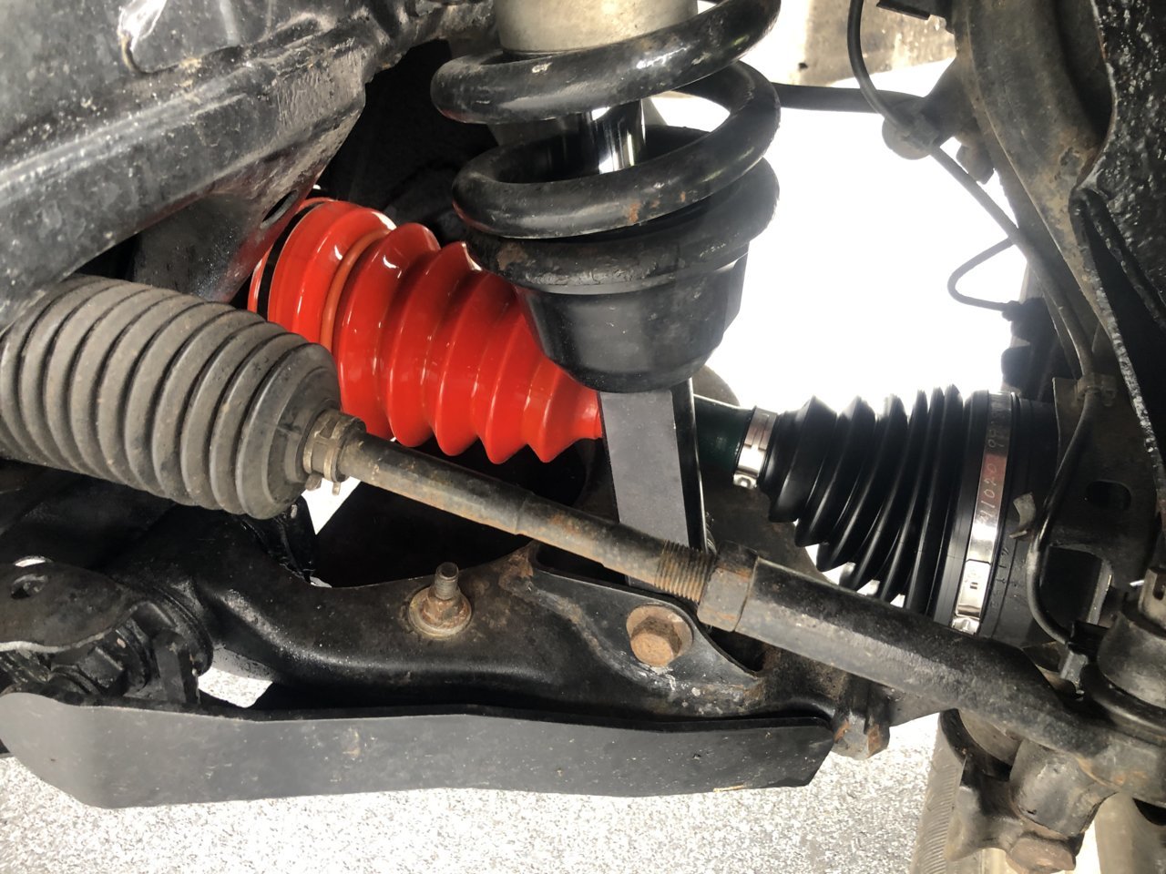

    Well got the ECGS bushing, axle seals and CVJ axles in! Drained and filled the oil too instead of just topping it off. I thought I messed up and pushed the bushing in too far, but it turns out my gusseted spindles contact stock wheels. Needless to say I was so relieved.
    oh and I sound deadened and upgraded all the speakers and tweeters too lol

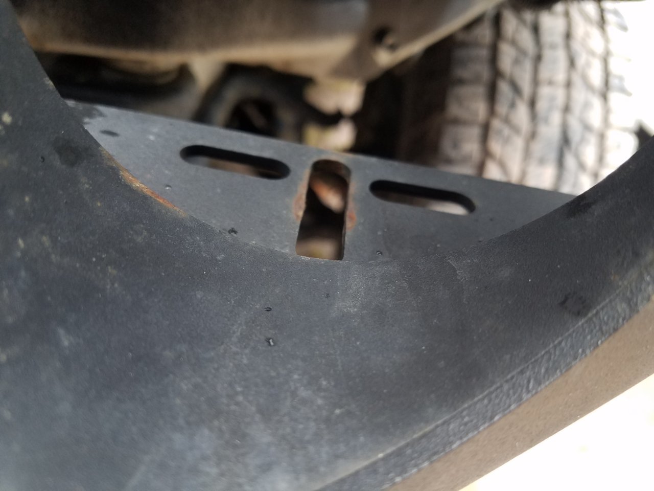

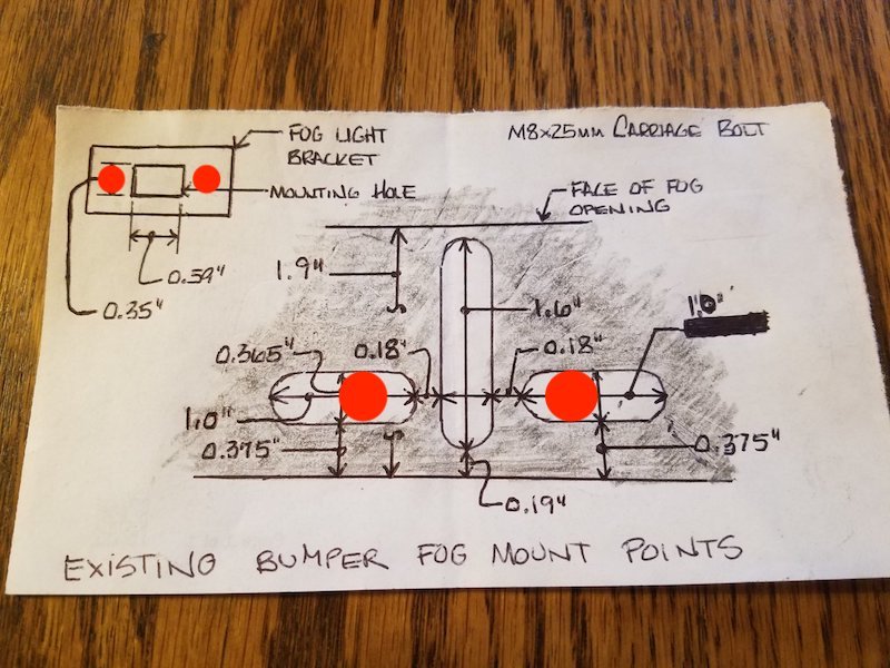

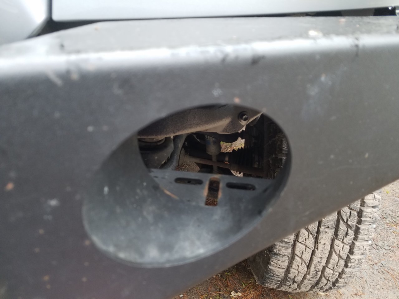

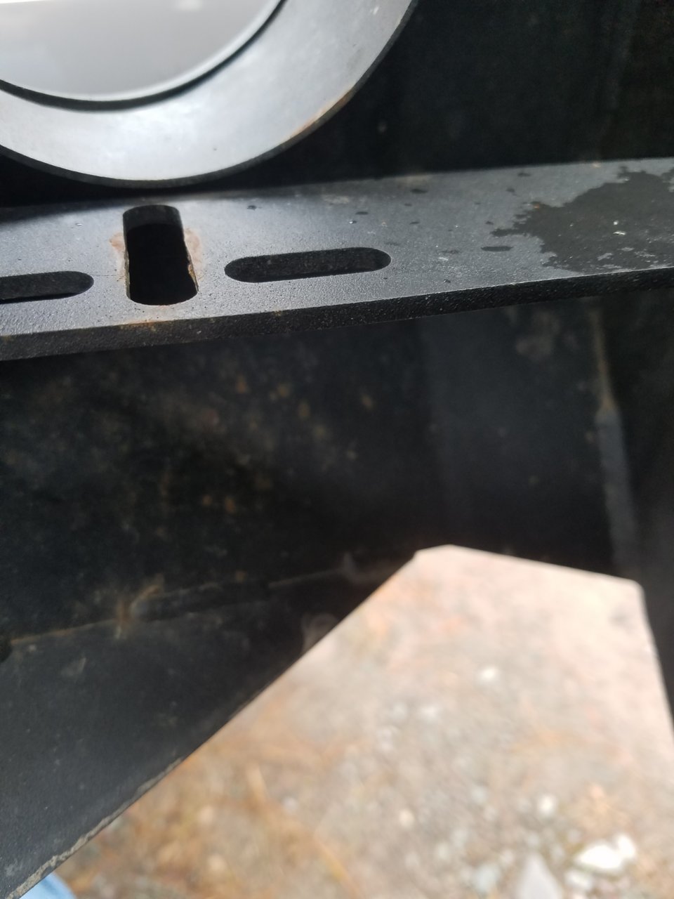

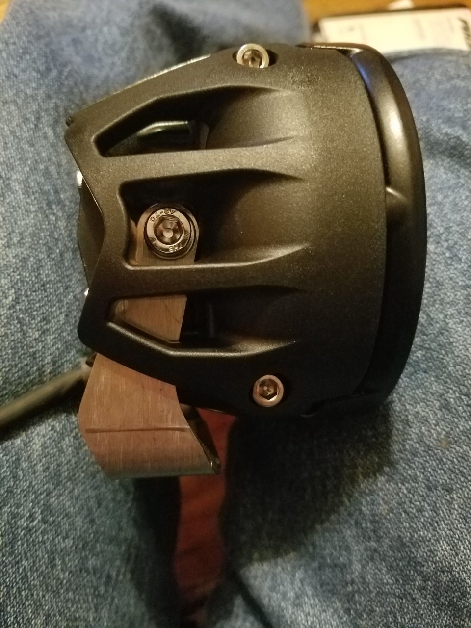

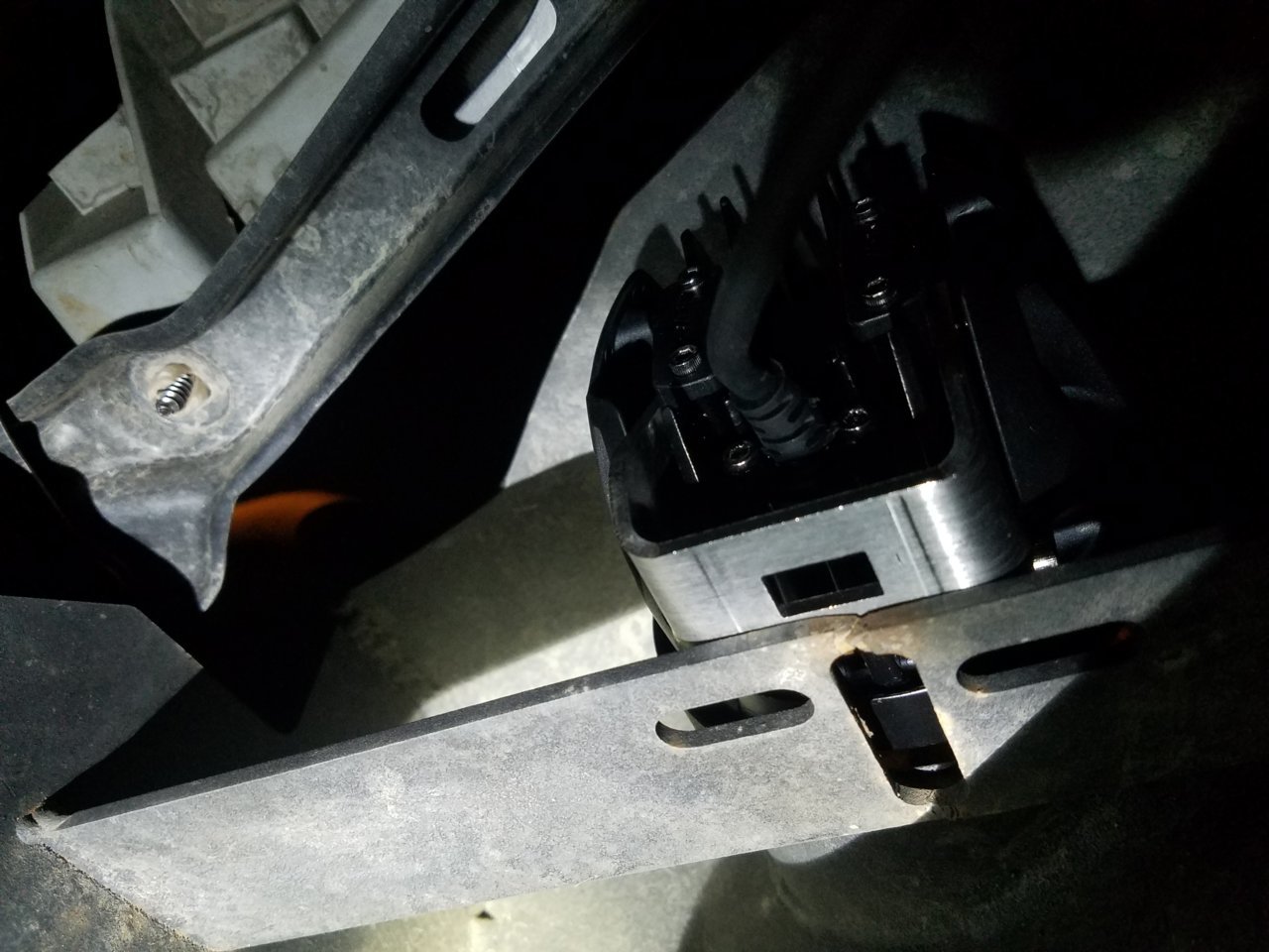

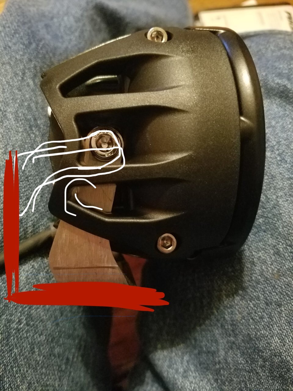

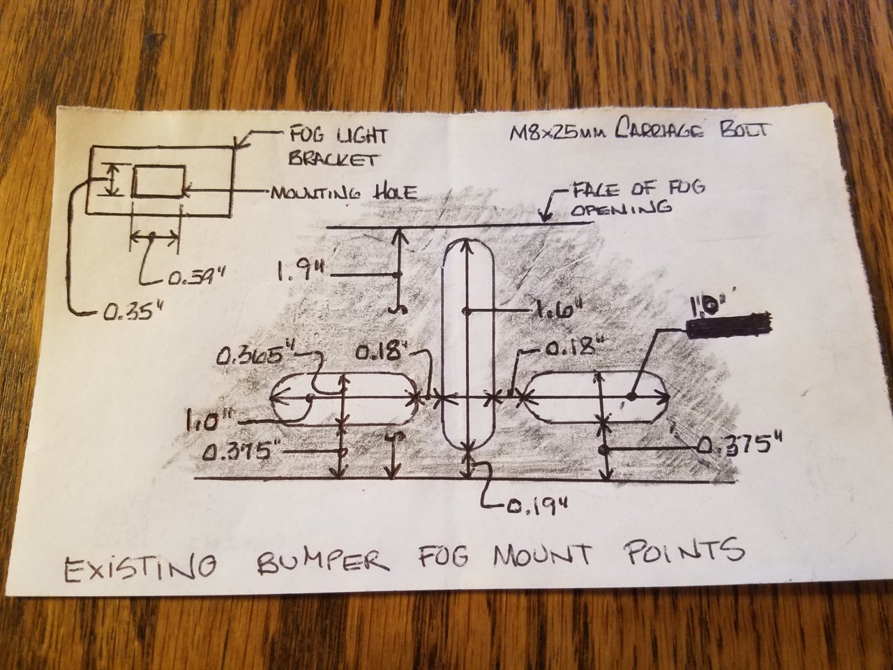

    So....any of you fab guys out there have a suggestion for a custom mounting solution for some Rigid 360s?
    The mounting point on my Demello is too close to the shroud.
    Pics are attached for reference:
    20191128_142118.jpg 20191128_142206.jpg 20191128_142133.jpg 20191120_185248.jpg 20191120_190330.jpg 20191128_144321.jpg
    Let me know what you think...

    L brackets like the eBay bumper.
    take current mount and turn in 90
    L bracket in Red

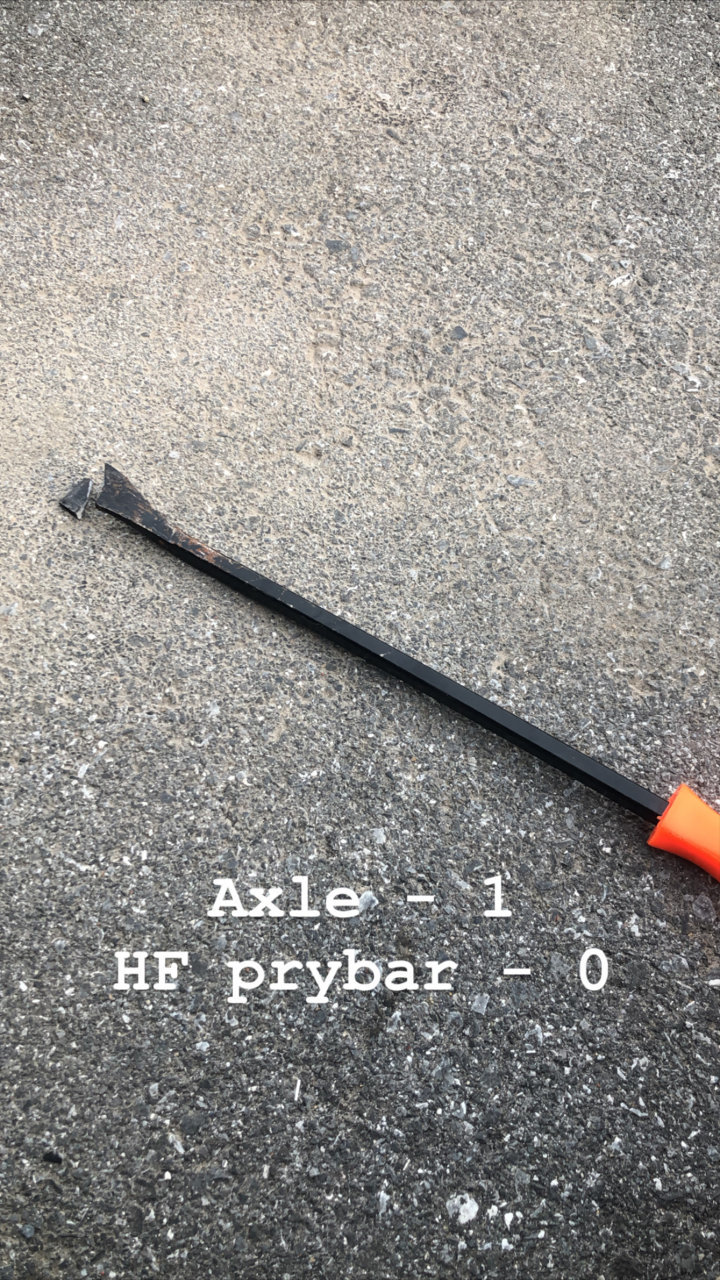

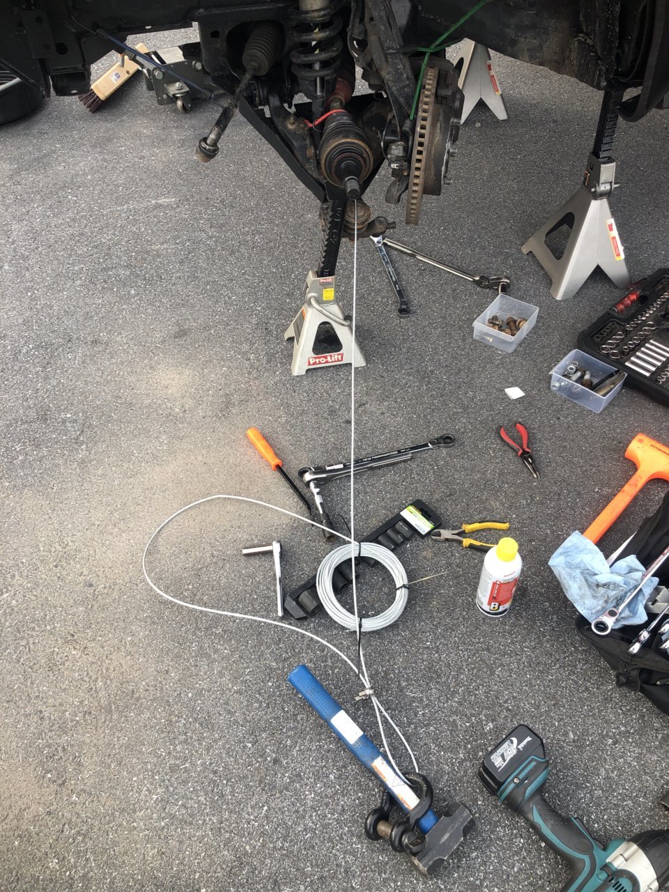

    nice! I learned that a Jack handle on the end of the seal driver makes quick work of the ECGS bushing, especially if it’s been in the freezer.
    cable, D ring and hammer make quick work of the axles. Better than my cheap prybar

    I tried a home made thingy like that I pulled the CV axle apart .
    It was long ago and my First ever CV axle removal.

    my passenger side one Separated as well, but only after it popped out lol

    New holes may line up?

    Thought of that but Pic #4 shows how much the bracket sticks off the back when face tight to bumper piece.
