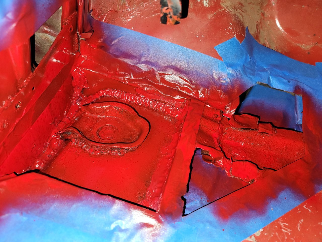

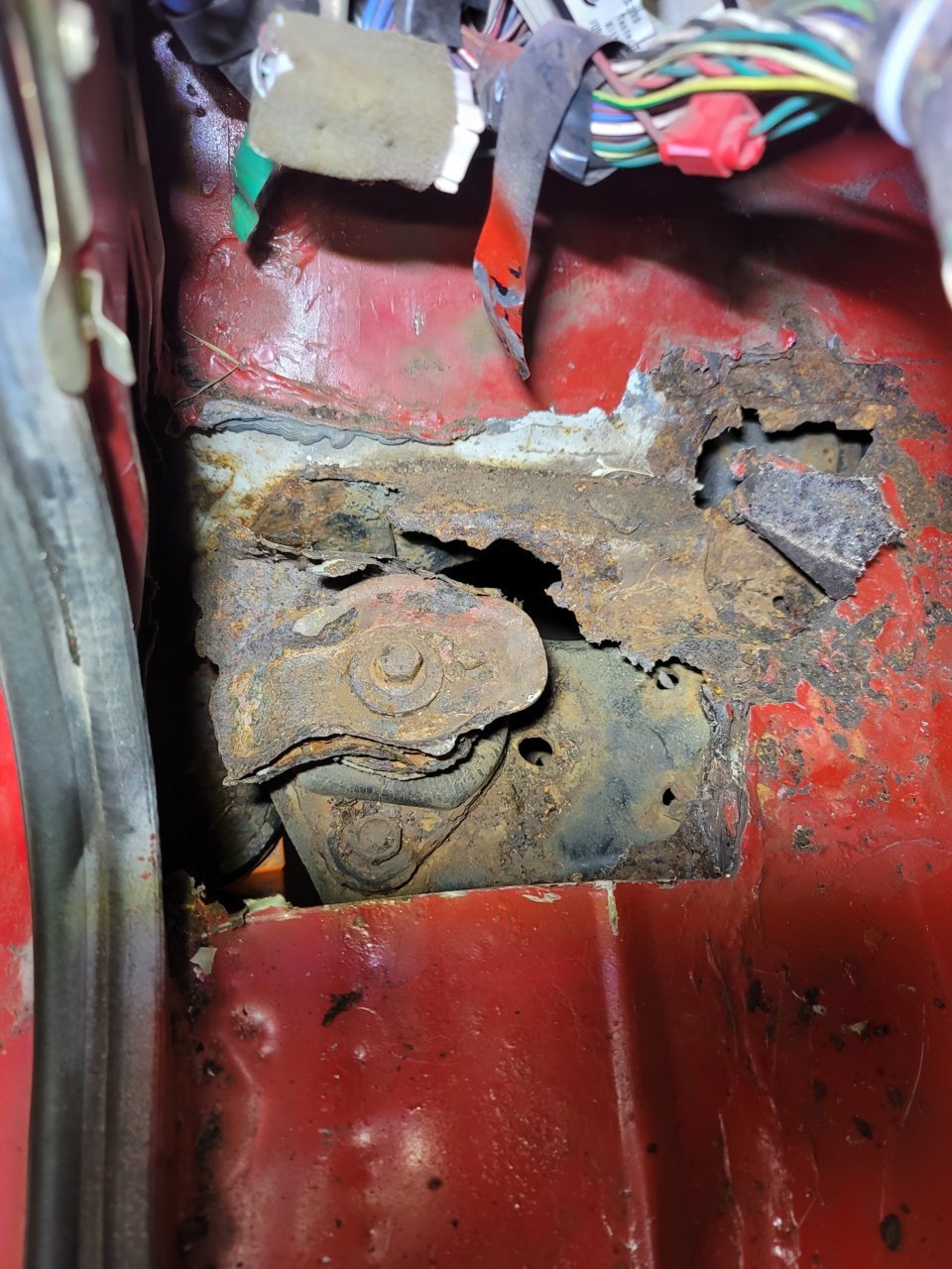

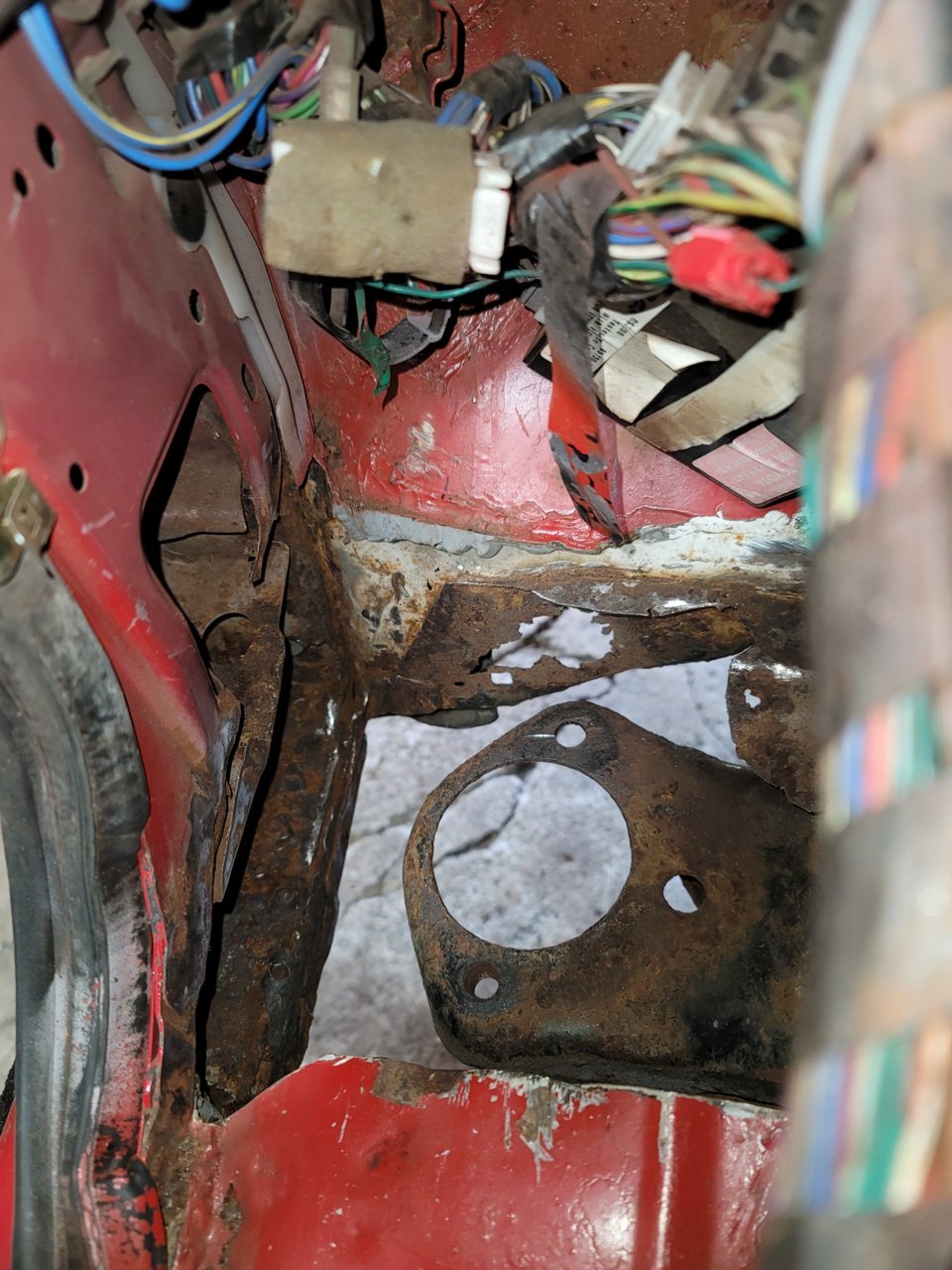

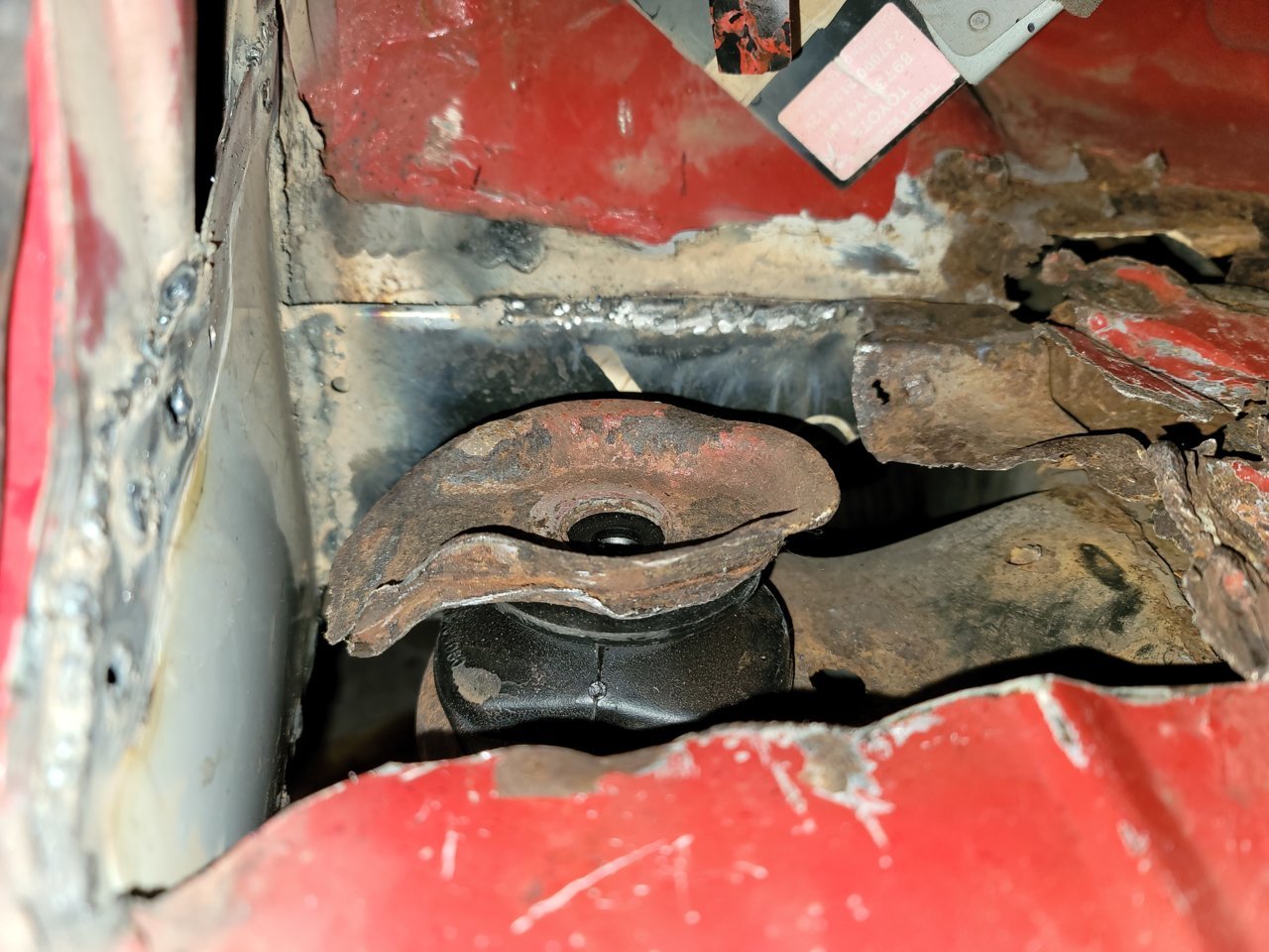

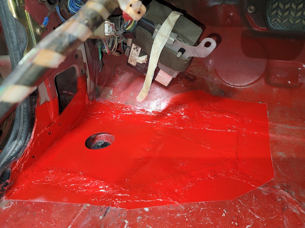

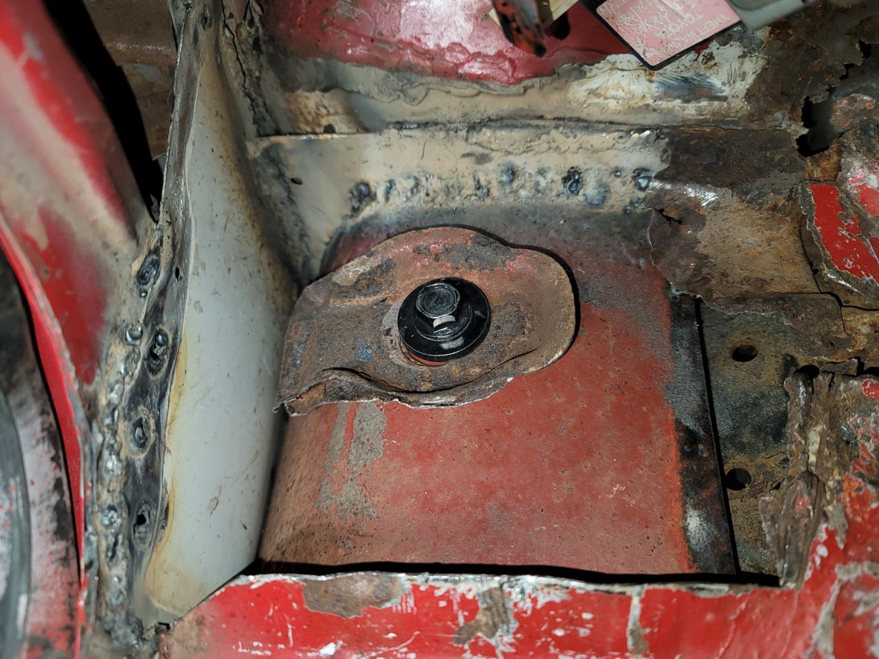

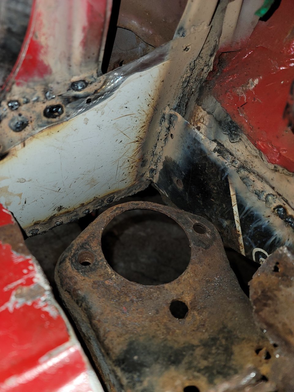

    Body mount repair is done!
    20211025_205025.jpg 20211107_141142.jpg 20211107_171914.jpg 20211107_173433.jpg 20211108_233629.jpg 20211113_202248.jpg 20211115_172636.jpg

    I'm impressed, especially using flux core on sheet metal! I tried the same thing with my old Craftsman flux welder and promptly burned through everything I touched. Wound up spending $800 on a gas mig setup :laugh:

    Thanks!
    Hmmm... what gives it away, i.e. my using flux core rather than something with a cover gas or tig or such?
    Metal gauge I have no idea about... The one with white paint on it is washer/dryer casing thickness, pretty sturdy, I believe the same thickness as the interior/exterior metal of the body. The other 3 sides (i.e. the front and back wall vertically of that region, as well as the actual horizontal base the mount touches... the red painted stuff in the 5th picture) are all beefier metal, about twice the thickness of the washer/dryer metal. The black painted front part was off a exit shoot of a lawnmower left at my house from the former owner, and the red stuff I cut out of metal car ramps my dad was going to throw away years ago for being a little bent.

    I can tell from the splatter and orangish dust it was flux core. We used alot of that out in the field on my previous job. It has its place.
    You're lucky you were in an area you could use "scrap" sheet metal. I have to use clean new metal for what I'm doing. Now if you want to you can help me put this mess back together!

    So, I think this is what I am using, or something extremely similar. That, and INE (inetub) brand 0.030" gassless flux core wire. Most of this work was on the 2V setting, with a slower feed of about 20-30. Hitting the thick stuff to the thick stuff I could crank it to the 4V setting.
