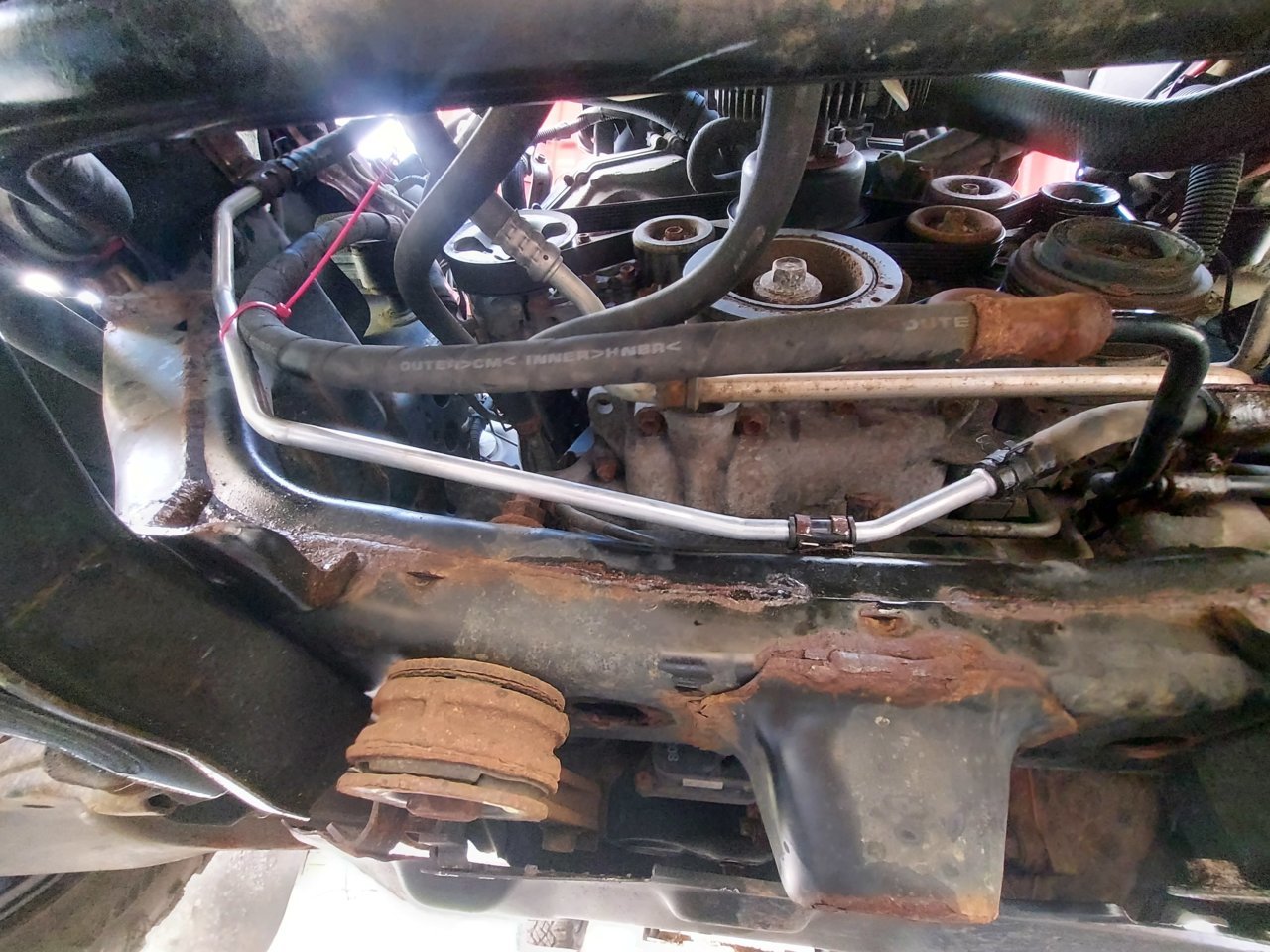

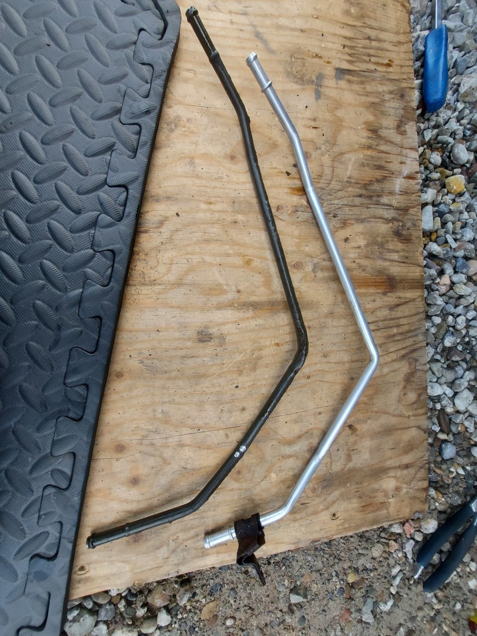

    Between my lack of patience and urge to fix things that are broken I couldn't wait until Saturday to do the repair I can do today. Not a bad job, could've done without the rusty bolts holding the line brackets to the crosssmember and frame but PB Blaster made quick work of them. $45 for the new line kit from Autozone ($55- $10 discount off of $60) not bad. The kit came with new rubber hoses, rubber isolator grommets and clamps. Didn't use the hoses this time.

    How did the bleed go ? I kind of thought they bleed themselves after a couple of turns back n forth ?

    Yep, just topped off the reservoir, jacked up the front tires off the ground and had my wife slowly turned the steering wheel lock to lock left to right while I watched the reservoir. Went out for a drive, everything is good.

    Easy peasy ! And beautiful weather to wrench.

    With the engine running, forgot to mention that.
