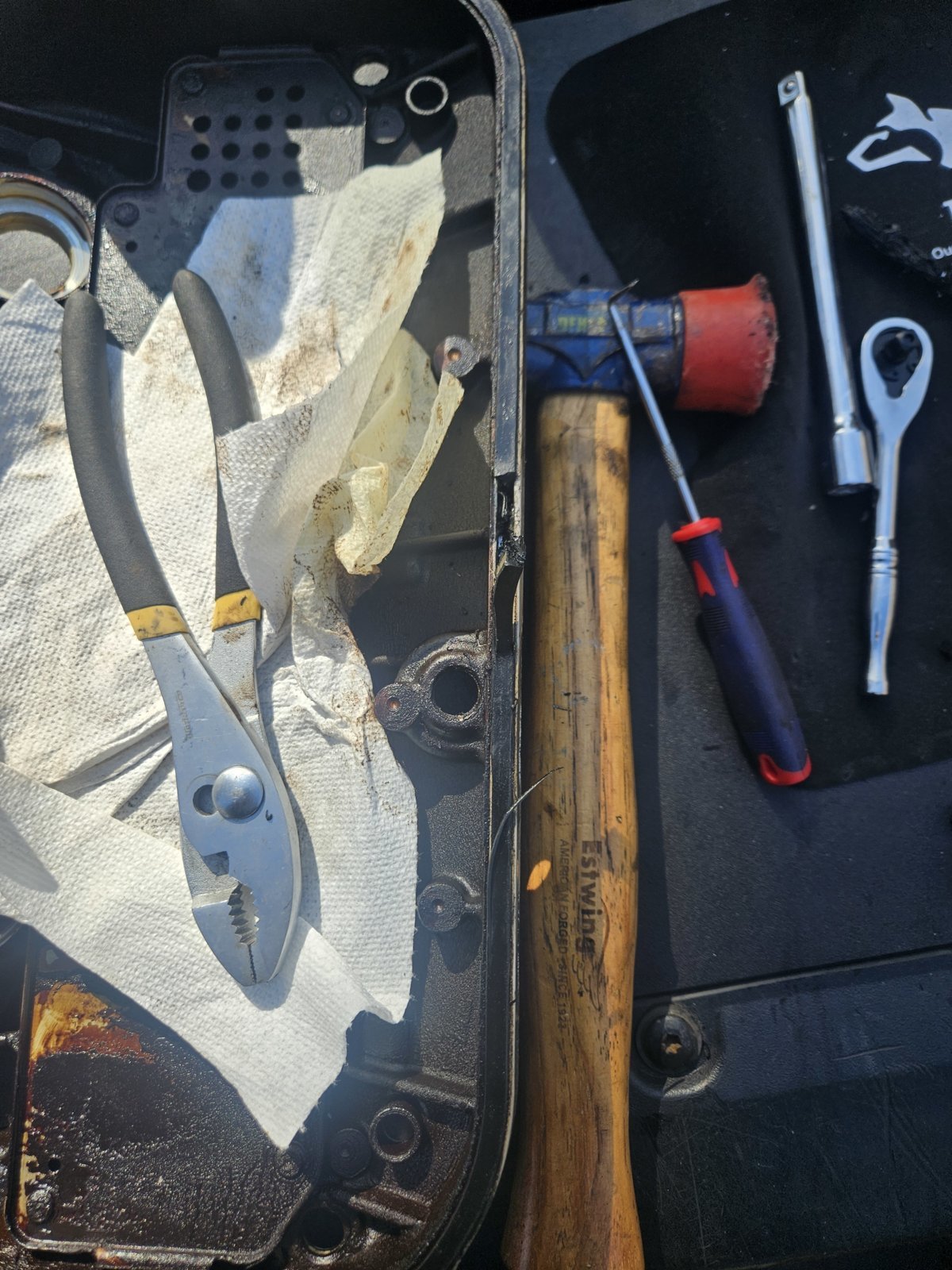

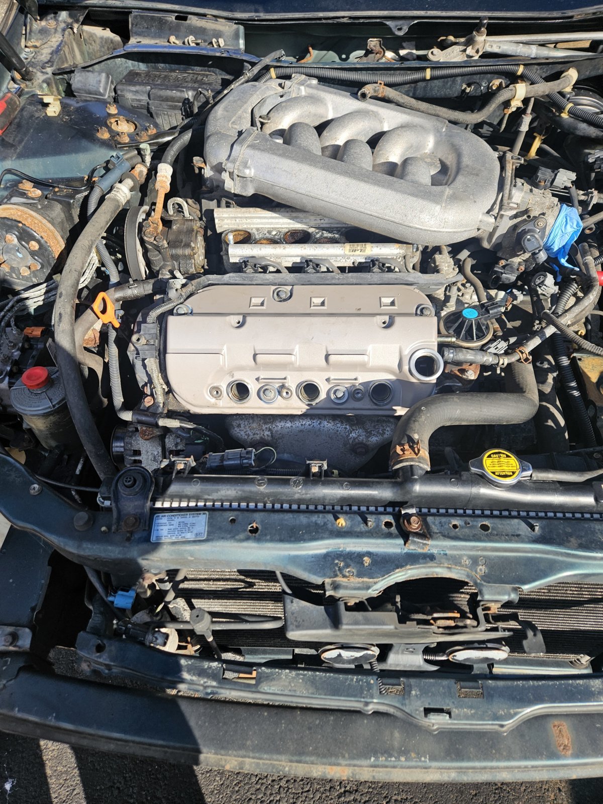

    Yes. First time ever doing a valve cover gasket. I unfortunately had to reuse and old spark plug seal as I ripped a new one. Bummer. Fingers crossed it doesn't leak. 1 side almost done on to the other side
    I should have read the install instructions lol. It said to use white lithium grease to help ease the install. Dummy me.

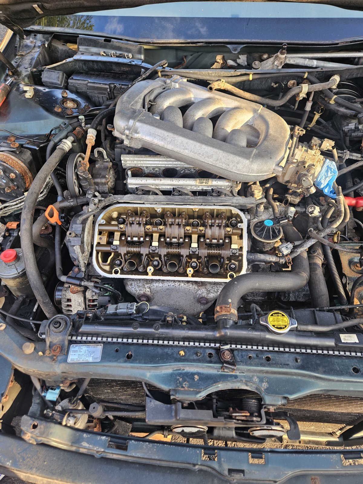

    That engine is shockingly clean for something of that vintage o_O

    I sprayed it down with foaming gunk engine degreaser like 6 times the other day before I started even working out it.

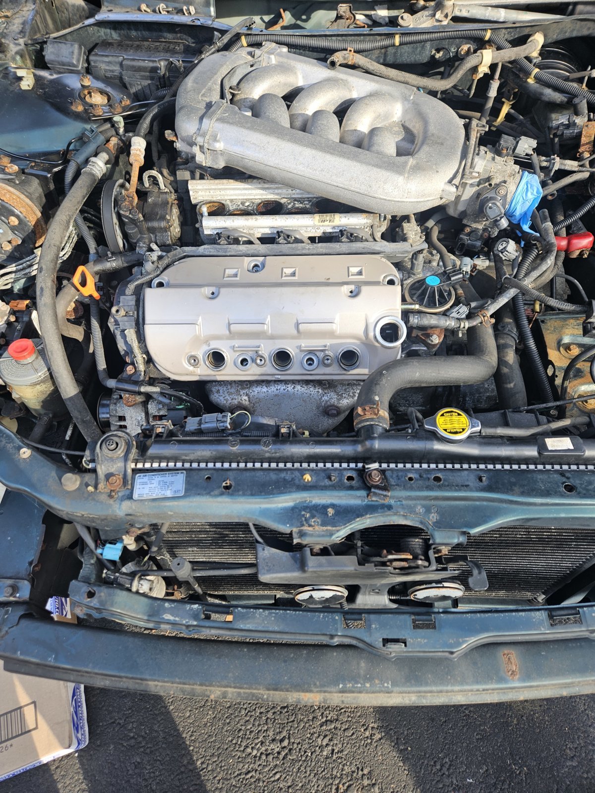

    Front side done.

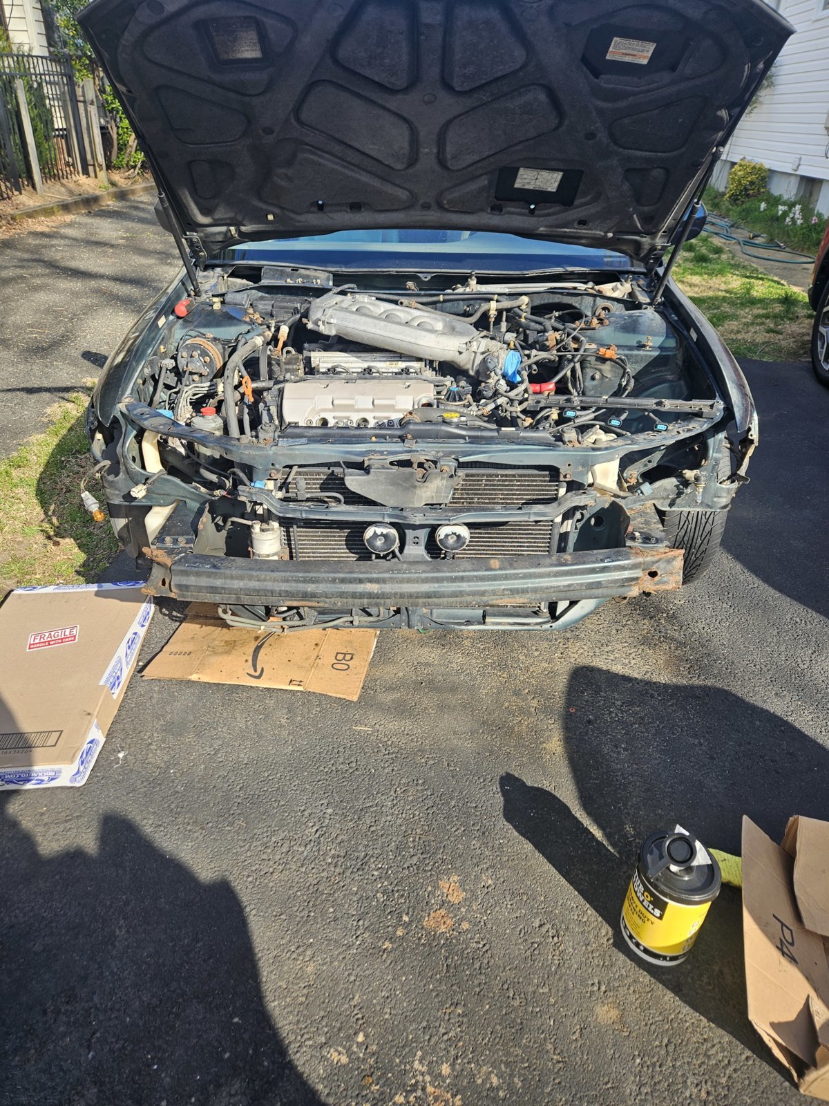

    Front of the car is in rough shape. New headlights should be in today. But before I even put it back together gotta to the engine and trans mounts.

    I was actually referring to the inside. Someone cared for that car at one time and kept up with the oil changes.

    Ahh I gotcha. Yes it was actually very clean on the inside. I didn't touch any of that.

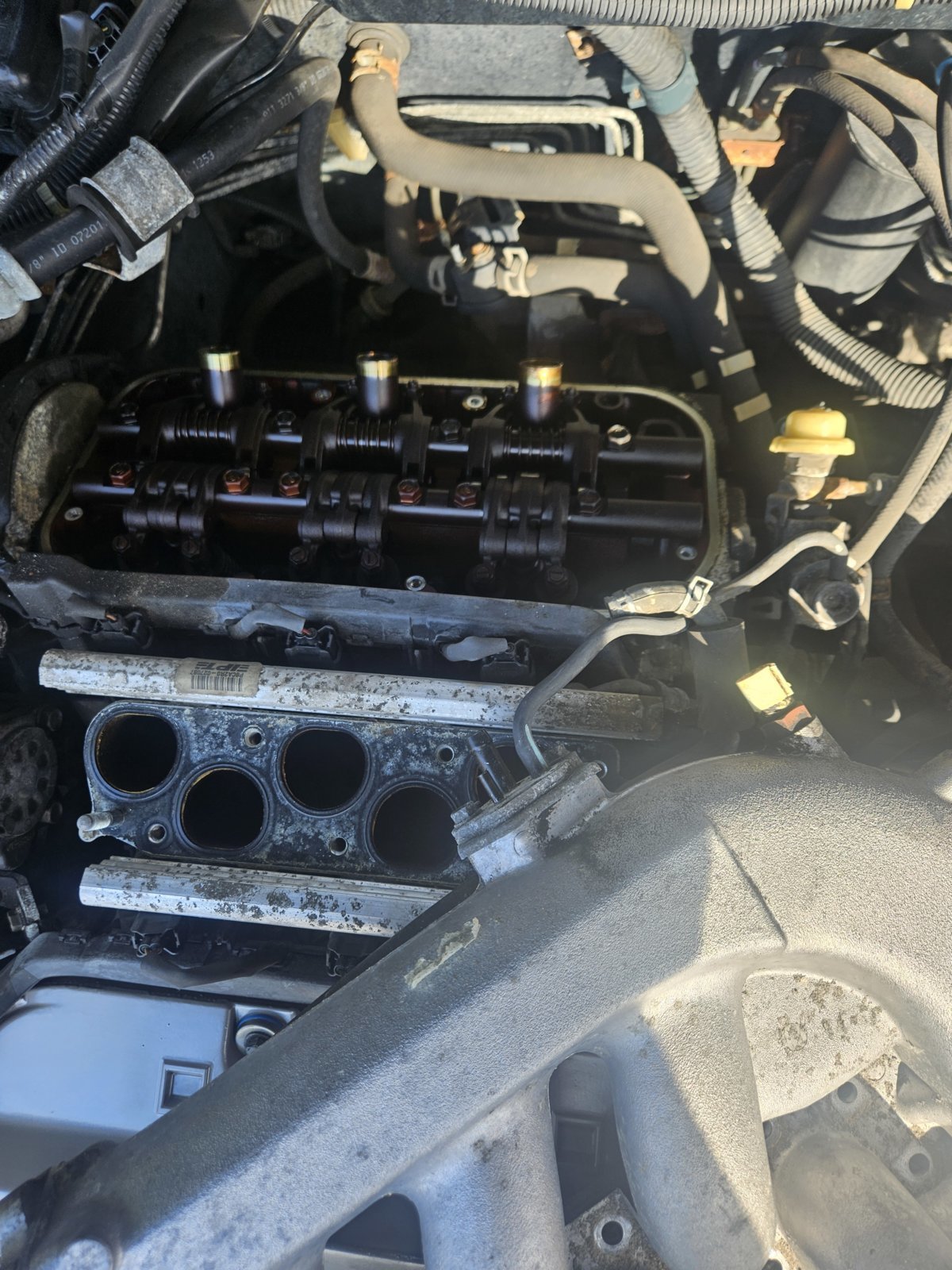

    Back side isn't as clean. And the old gasket it putting up a great fight

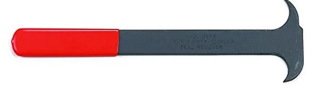

    Anybody have any tips or tricks to get a stubborn old valve cover gasket out.

    These work pretty well in my experience

    Talked to my friend that is a honda tech he said that it's normal for the exhaust side to look darker. Which makes sense now.

    I cant tell you how much time I have scrapping off old gaskets in my life time . Sooner or later I'm reaching for a razor blade and brake clean. Sometimes a brass or metal brush, sandpaper, steel wool ....helps but have to watch for aluminum surfaces. Good luck, time consuming for sure.

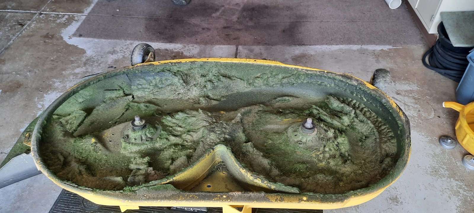

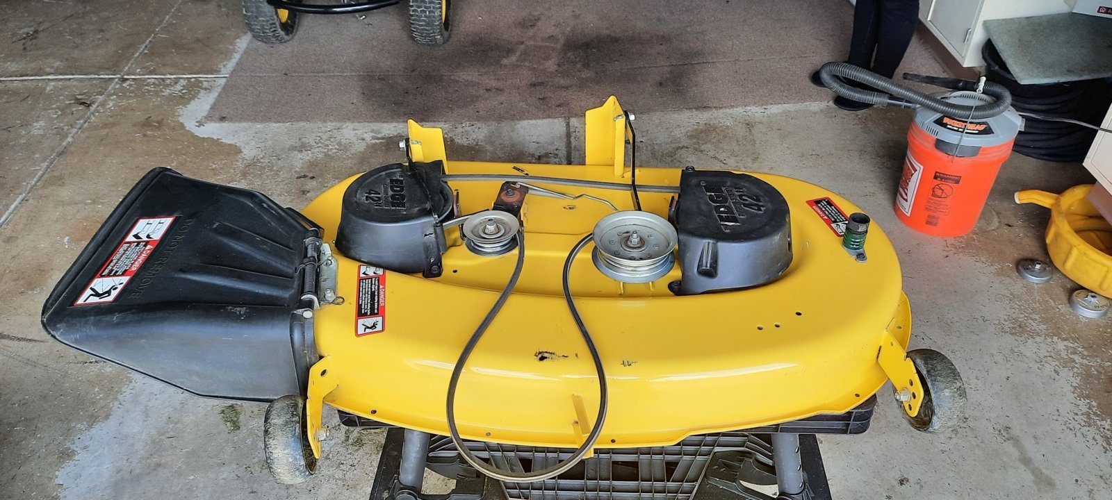

    I am minus the stogie , just putzzing around in garage. Gonna pull the deck off the rider to clean and change blades . They are from 2018.

    Cleaning the deck, 2 new blades, greased the 2 spindles , 2 hrs ..... or 1 Randolph Scott movie on Grit TV.

    Do you have a shallow pan or some way to soak the gasket area with a solvent? Might make tomorrow a lot easier.

    these work really good I’ve used them couple time and beats the razor method
