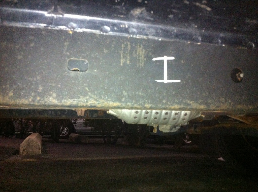

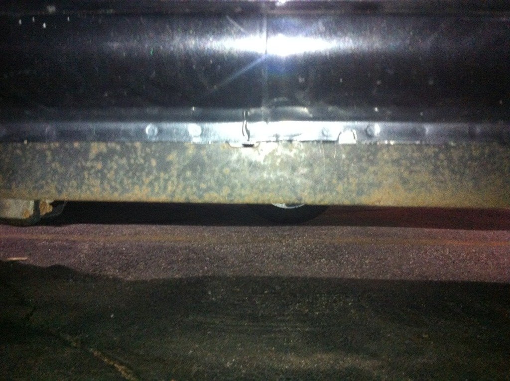

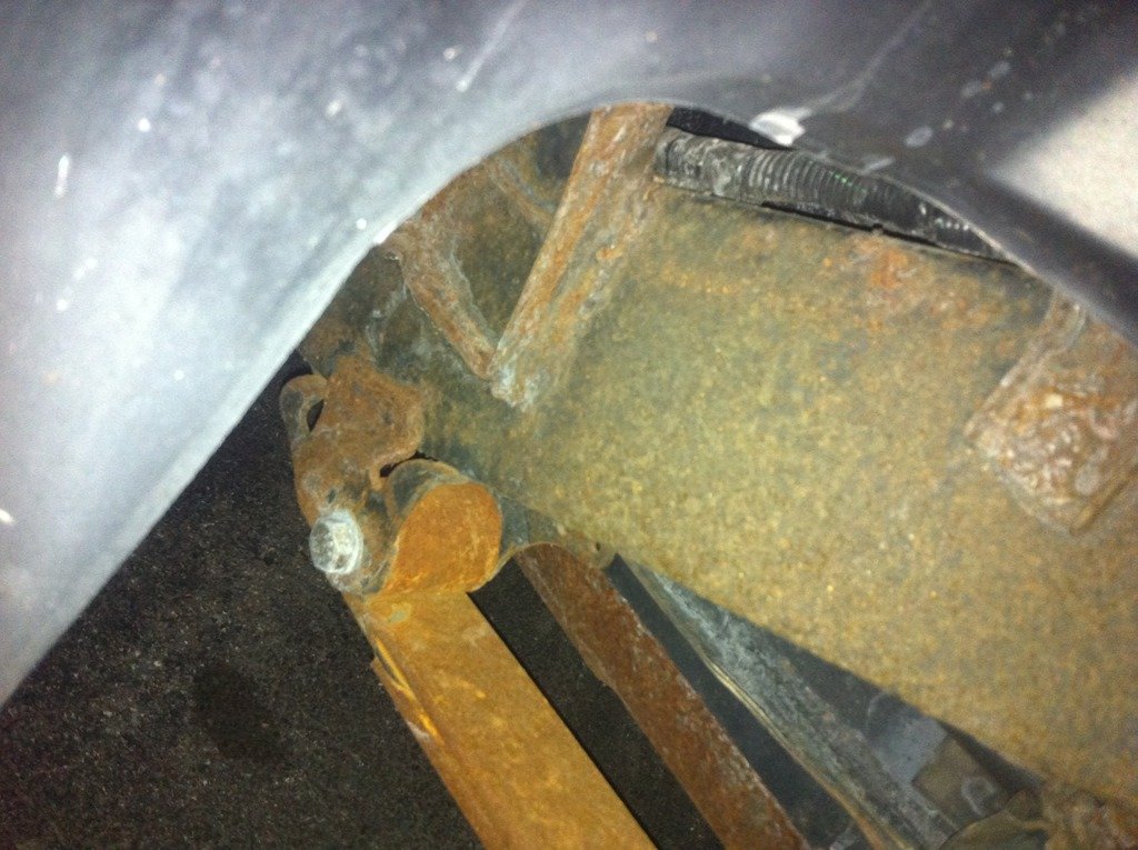

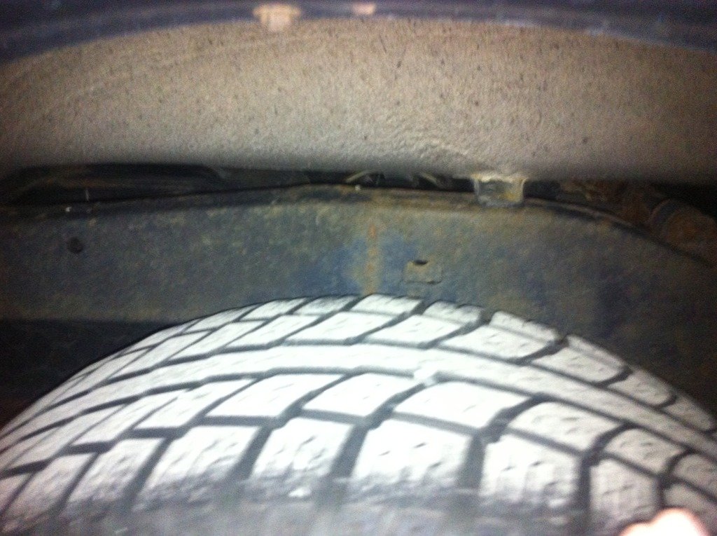

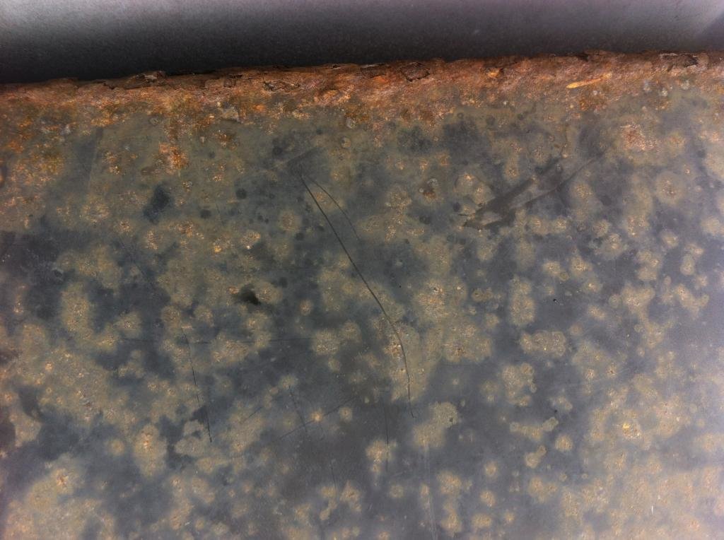

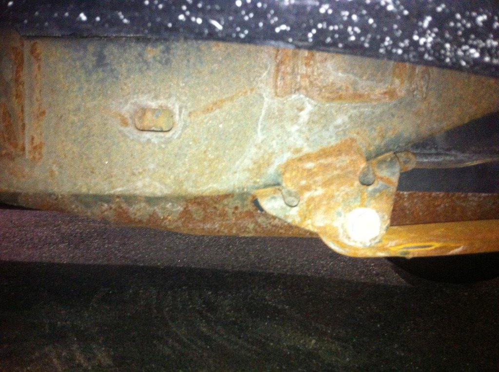

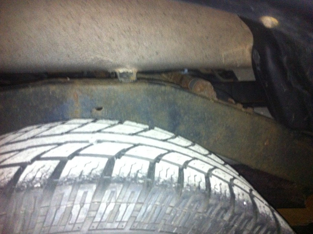

    Yeah that makes sense. However the rust on my truck doesn't haha. More surface rust on the drivers side for whatever reason. The passengers is a lot cleaner. But I did notice that I had some inner rust near the leaf spring mount and had kind of freaked out... I know thats a bad spot to have rust. But I took a screw driver and tried to see if it would give at all. Luckily it is just surface scale.. My truck is structurally sound but these forums with all the horror stories make you worry more haha.
    Basically, after performing the Toyota TSB, by hitting the frame with a hammer all over I was not able to find any soft spots on the frame. Which is good. But I do however have frame rust and scale at several portions of the frame. In some places more serious then others. See pictures...
    Drivers side top of frame rail
    Drivers Side bottom of frame rail
    The other side of the frame looks the same. The inside of this portion of the frame is rust free.
    Rear Drivers side- Leaf Springs
    Rear Drivers Side
    Passenger side rear
    This spot was very concerning for me, but this is where I tested the frame with a screwdriver and a hammer. No structural defects or weakness. Inner rust is scale.
    Passenger Side middle of frame
    Like I said before I have no doubt in my mind that the trucks frame is safe and structurally sound. But that does not change the fact I have frame rust, that needs to be addressed. Unfortunately the original owner was a dummy and never took the truck in to be sprayed. So I cant get a new frame ever. But I don't think it would matter regardless because the warranty for me would have been up in three years and my truck is no where as bad as others I have seen.
    I guess my question is does this rust warrant the use of POR-15?
