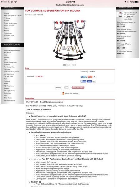

    Ok I finally unboxed my sliders and LCA skids from bamf .......they are fucking heavy and I still need to add full skid plates,front and rear bumper. So my question is how hard is it to get heavier springs installed on my overcoils and what lb rating should I get? Guessing I'll be adding over 500lbs of armor
    I plan to get all pro expedition leaf pack for rear.

    If you're adding plate bumper on front, probably 650 lb springs, if adding a winch to the front, and upgrading to a marine battery, 700lb Springs should cover it. I would also recommend going to a 2.5 inch diameter coilover. Spring length will depend on what brand and the amount of preload that you want for lift.

    image.jpg This is the kit I have but I'm not sure what the spring rating is ? 600lb maybe. Do they make 750lb spring that fit my fox 2.5 over coils?

    What's the factory load rating? I 've only used OME, if you look them up2884,2885,2886,2887 OEM also have additional weight your adding as the load rating. Some other springs manufacturers do a similar thing .

    I think fox come with a 600lb spring but not sure how much I'll need after all the added weight.

    Toytec is good to work with using a few phone calls, don't waste your time with emails, they are not good with them. I'm not very experienced with Fox products so I will not guess. Stock Springs are 545-560 IIRC depending on year and model. Simply divide added weight by 2 and add. I have not seen many references to 750lbs, I went with 700lbs and an extra inch of spring length to use as preload.
