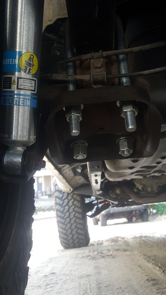

    Just a friendly public notice:
    If you do anothing to the suspension of your vehicle, or any work for that matter. Check your bolts. I heard the slightest click when tapping the brakes in my truck. Didn't think much of it. Looked under the rear and noticed the nuts to the u-bolts nearly fell off. These were just torqued to spec yesterday, and I've put about 80 miles on the truck since. No torque wrench on my right now so for now they are at German spec "gutentight". Gonna keep an eye on everything over this week and probably go over everything again this weekend.

    I'd probably get a torque wrench on em dude, thank you tho I will check, appreciate the heads up!

    For now I torqued them with a 2 foot breaker bar. All my tools are at my parents house in jersey so I did what I could.

    You actually are supposed to re-torque u bolts after 50 miles or so when you work on them. Glad you found it when you did before it got ugly! :thumbsup:

    So the u-bolts are tight but the clicking noise still exists. I localized it to the front of the truck, it seems to happen at low speeds, usually when braking, but not every time. also happens when reversing with no brakes applied, again not every time. finally it happens over bumps at low speeds, but not every time. my thoughts are it is either brake related or ive done some research and found out the bumper crash bar can crack and make a similar sound. i checked all the suspension bolts and shook everything i could but could not create the sound.
