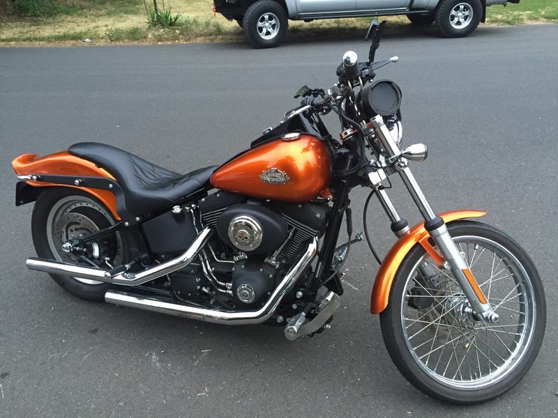

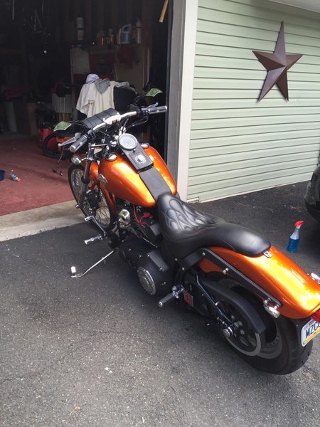

    :wave: whats up peeps.Checkin in haven't been on much,been out playin with my new toy.

    watch out for idiots Jerry!

    I approve of anything two wheels. Awesome Jerry!

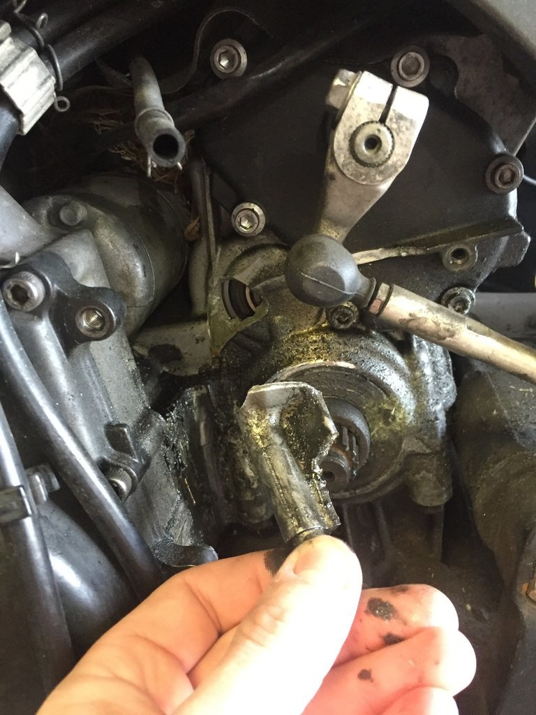

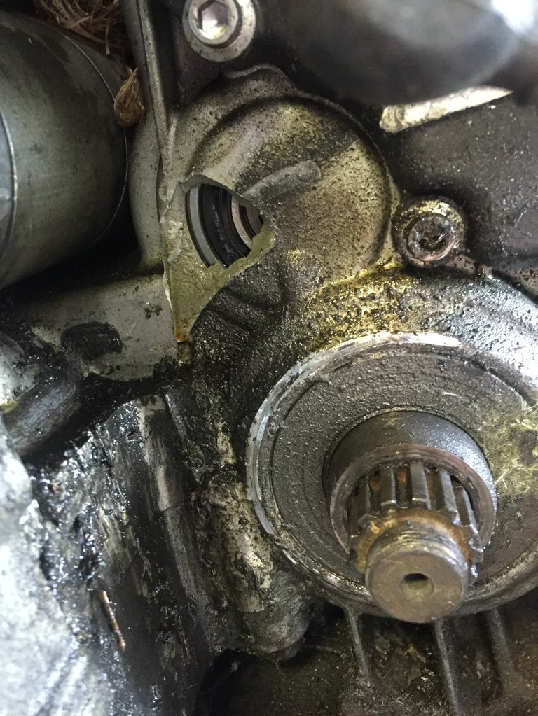

    I finally started mine again after a broken chain put a hole in the motor. I used steel stick to try to seal it and it didn't hold. I'll be dropping the motor and splitting the cases soon because of it.

    No clearance, but it's a relatively clean break. Can def be welded by the right person.

    Blocks are cast aluminum so gotta get tig'd but other owners who have had it happen have had it successfully welded. I can probably get it welded without tearing down the motor but risk fucking the bearing behind it up from the heat.

    Speaking from Experience getting that clean enough for a good weld is going to be interesting.
    Once it is clean the welding is the easy part

    Shouldn't be an issue if I split the cases. Can even soak it in a parts cleaner or something really.
