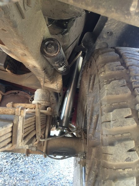

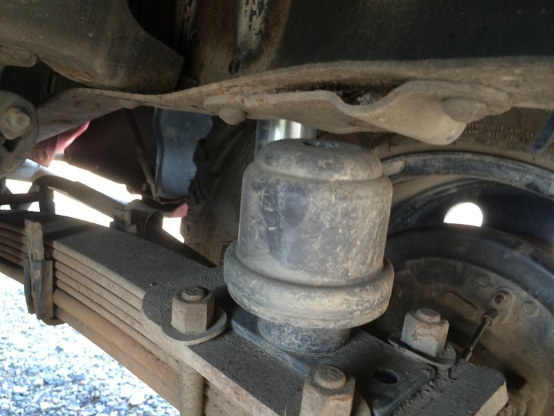

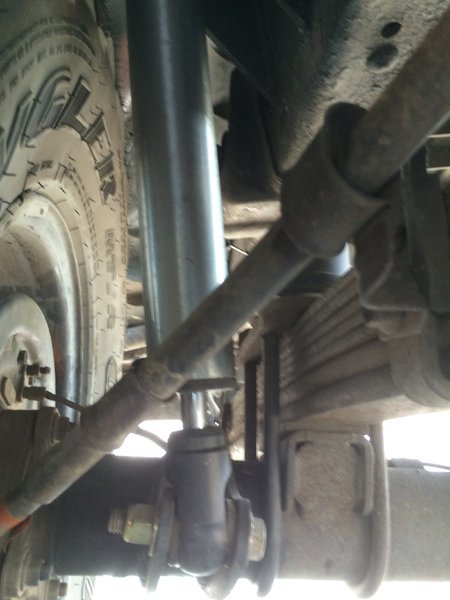

    Tried to flex it out to be sure the bumps are compressed. But can't flex it enough to see. I can get it to about a quarter inch between bump and frame. And the shock looks like it has just enough travel left. But I'm gonna get some 1/4" plate and make a spacer for my bumps. image.jpgimage.jpg The bamf kit also puts the tire very close to the shock when flexing. image.jpg

    Honestly I think you need at least a half inch spacer. Those bumps will compress a bit too and I think you will most definitely risk bottoming the shocks out.

    Yeah that's what I'm thinking laying two pieces of 1/4" plate down for my spacer.

    I'm not too worried about it though. Need to flex it the whole way to see what it looks like. Plus I don't think it'll hurt them too much to fully compress the shocks as long as I go slow the shocks also have a rubber? Washer to help cushion the blow if you compress them fully. That being said as soon as I can I'm gonna get the spacers on.
