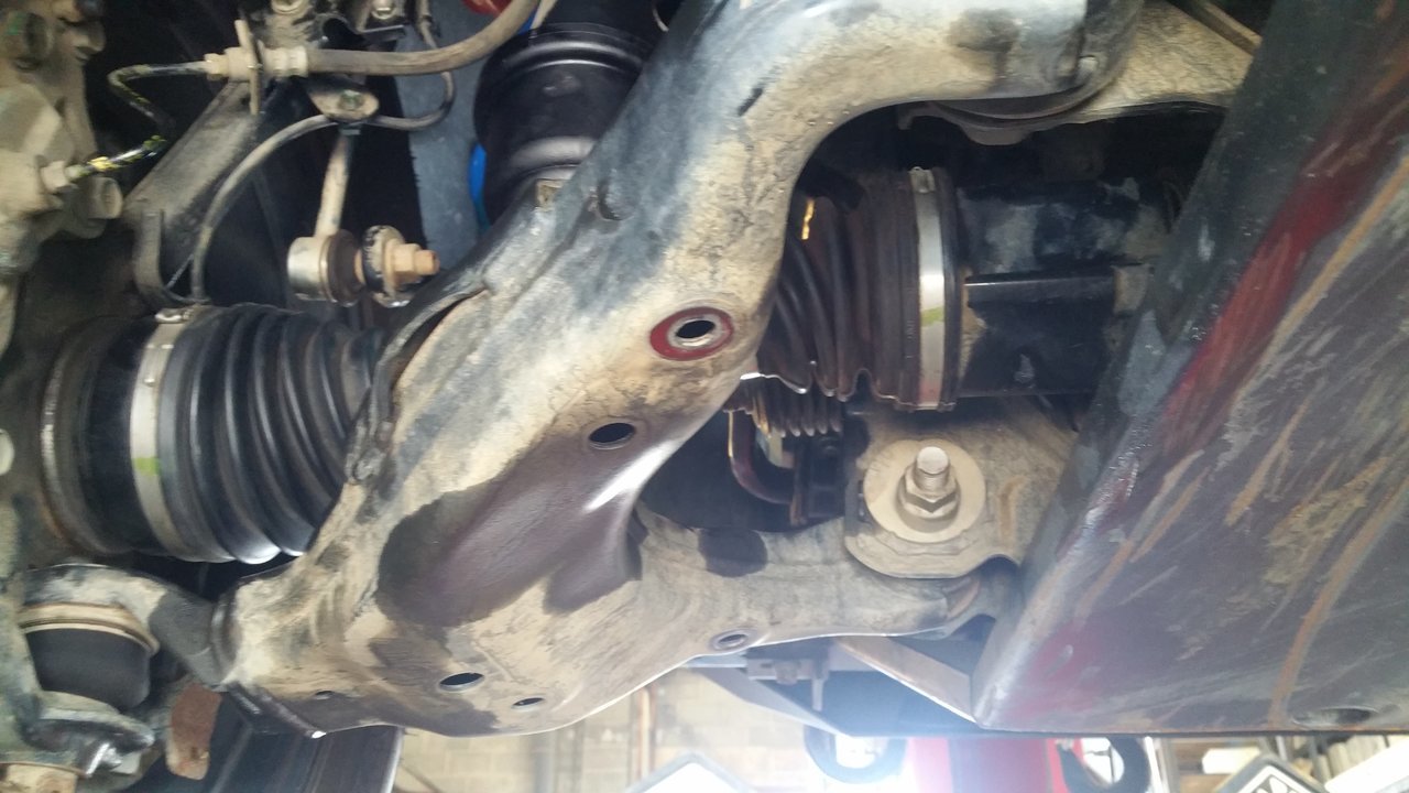

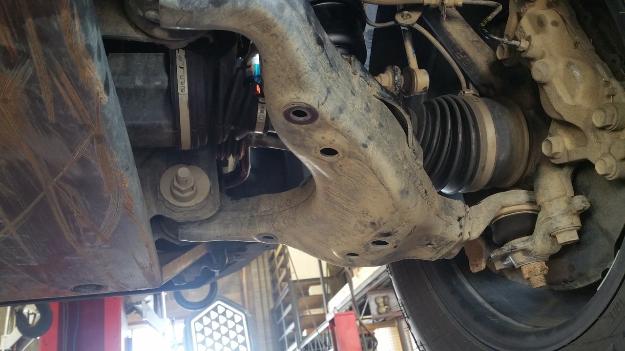

    @stairgod @Blackout14 @Wyoming09 here is what has been done:
    Removed carrier drop kit. No change
    Removed new battery replace with factory. No change.
    Took drive shaft out placed in 4 wheel high. No change.

    @Braves95 I have to applaud your approach to the problem by looking at ways to isolate the vibration by disconnecting or swapping items one at a time.
    Yes you can remove the rear driveshaft and carrier bearing and run on 4hi, you do not have to limit your speed to less than 50, but the front diff wasn't really designed to do 90 for long periods of time.
    @stairgod is probably correct in focusing on the rear, as you were in 2hi when you had the vibes.
    The notorious taco lean comes from the driver front having a higher percentage of the load and the passenger rear doing most of the work.
    A simple test would be to add a load to the passenger rear, say 300 to 500lbs, and see if the vibe is reduced.
    I can tell you that I have vibes that appear at different speeds depending on the weight in the Bed. At 1000lbs the vibes are nearly gone.
    Axle wrap is tough to reduce, but proper torque on the u-bolts is a great first step.
