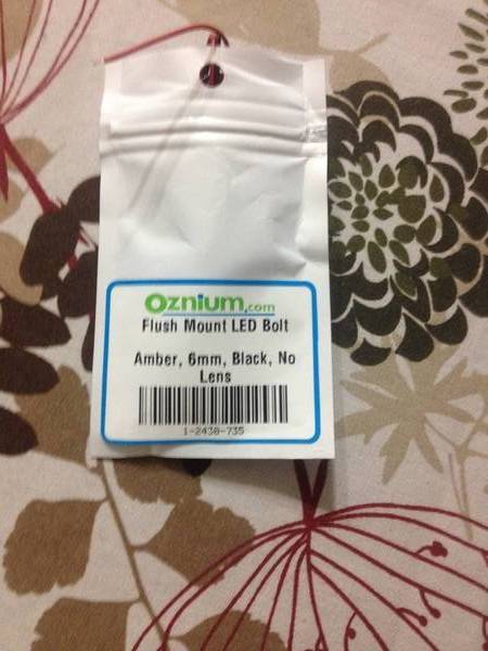

    Yup finally came in. Now to find time to install.

    Here are some steps I took to install 3 6mm amber LED lights:
    Tools:
    Tape Measure
    Cordless Drill
    Drill Bit size 15/64
    small Needle nose pliers
    Wire Cutter
    Wire Stripper
    Material:
    1/4" Flex Sleeve
    1/4" Heat shrink
    {17} Black Tie Wrap
    {2} 16-18awg ring wire connector
    {2} 16-18awg Spade wire connector
    {2} T-tap connector
    {3} 6mm LED Bolt
    http://www.oznium.com/led-bolt
    Steps:
    Cut 17 tie wraps
    Measure the middle of the grill
    mark 6 inches left and right of the middle of the grill, drill the 15/64 holes
    Install {3} amber LED Bolt Light tighten by hand or small Needle nose pliers.
    Install Flex sleeving over the wires
    Heat shrink the ends of the wires
    Install {17} Black Tie wraps to the grill
    Put Raptor grill back in and tighten tie wraps and cut off the extra ends off
    Route wires to the passenger side of the grill
    Remount raptor grill to the truck
    Run your wires in the hole next to the passenger headlamp and tap off of the
    parking lights green wire + white/black wire -.
    Enjoy
    The hardest part of the build is to drill into a Homer Taco Grill :D

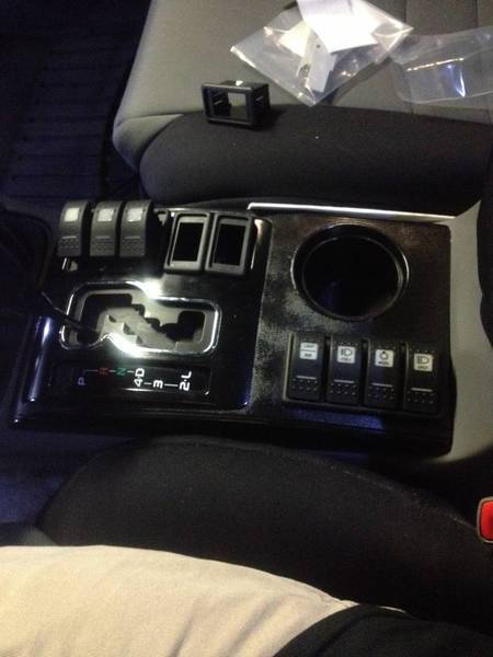

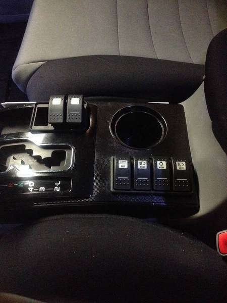

    Debating adding 3 more switches:
    Or 5 switches maybe 6 might fit gotta wait till my order comes in.
    What you guys think?

    Put in as many switches as you can! Then after that get that overhead console switch thingy :D

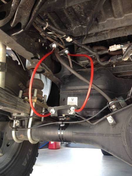

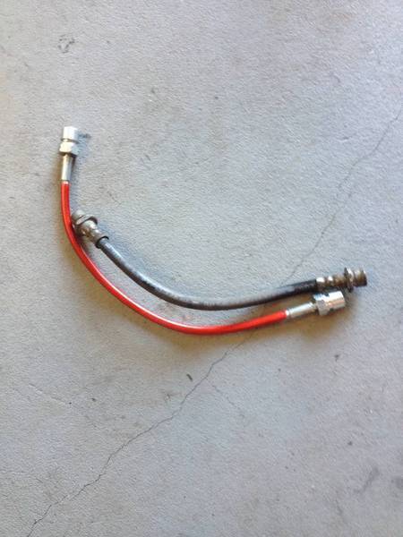

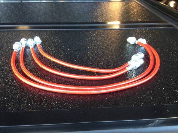

    Ok finally installed the extended brake lines. The rear was a pain in the rear to install. Thanks Blaine for the help today.
