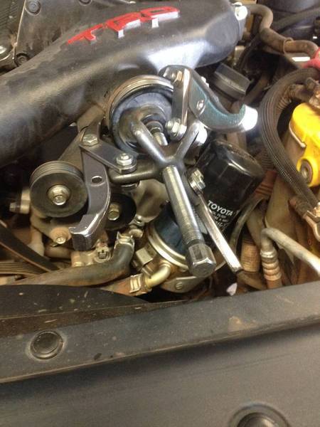

    First step take off old pulley

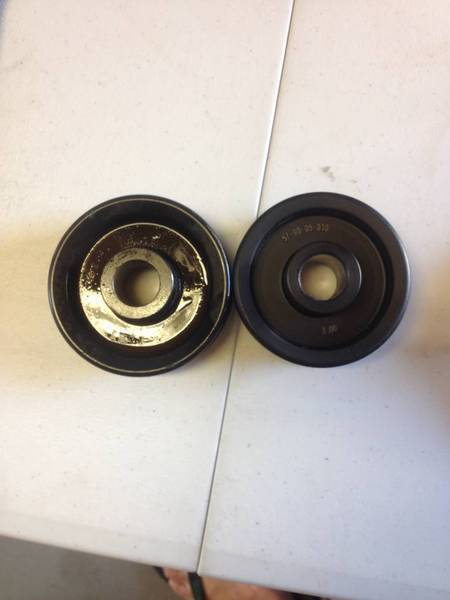

    Side by side of OEM pulley and URD 2.85 Pulley

    Thanks to Matt & Mike for help install.:D

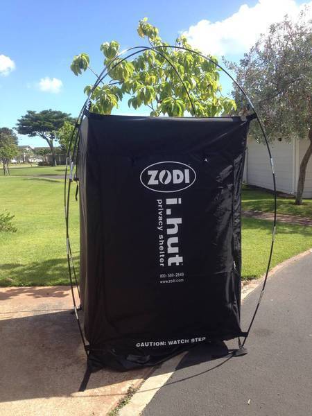

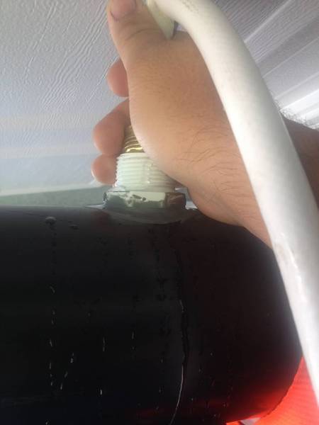

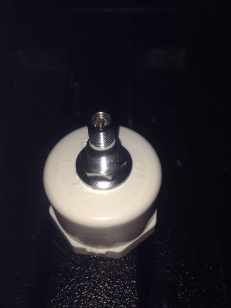

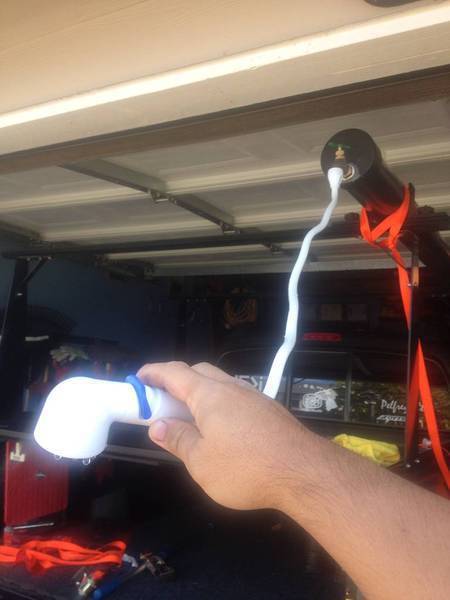

    Started with Black 4" 10ft PVC pipe, {2} 4" end caps, {1} 1" threaded cap, {1} 1 1/4" to 1" reducer, Valve stem, 1/2" Water valve, 25ft marine water hose, Shower head & Zodi I Hut. You will need to pressurize the pipe about 15 psi to deliver a good flow of water. This setup holds about 6.5 gallons of water. Going to be testing it out this upcoming camping trip. Will take some pictures.:D
