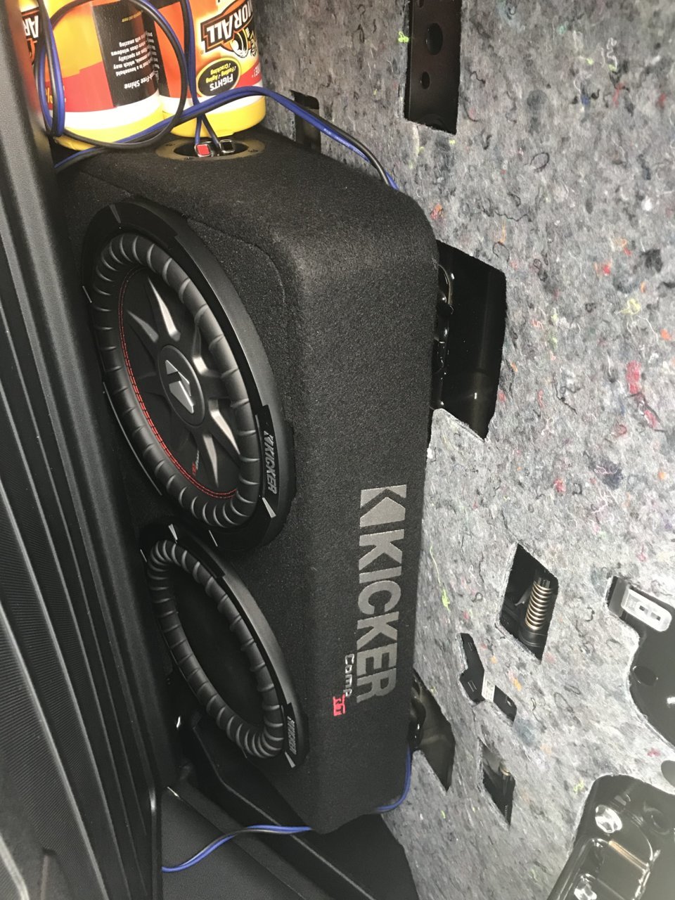

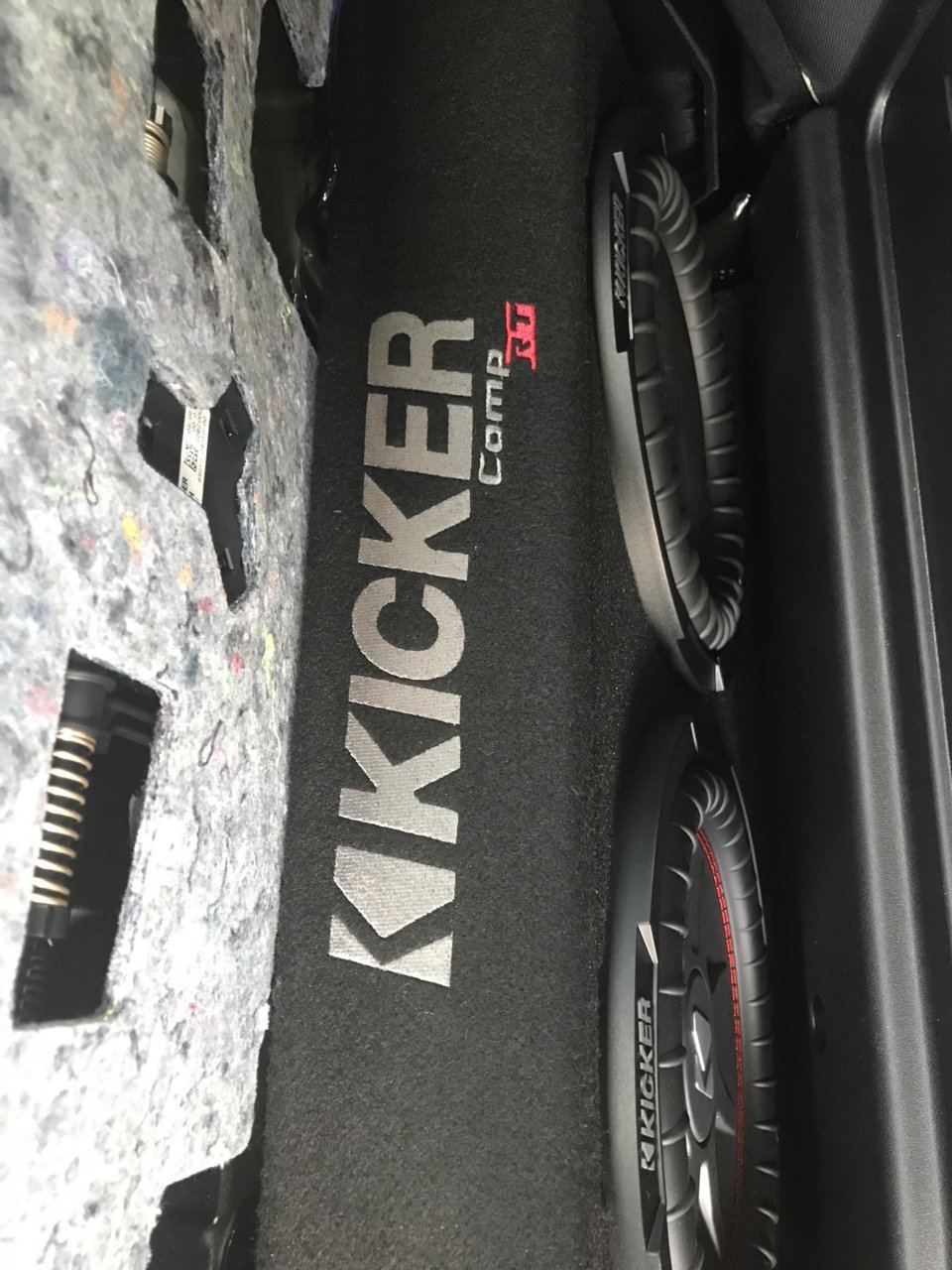

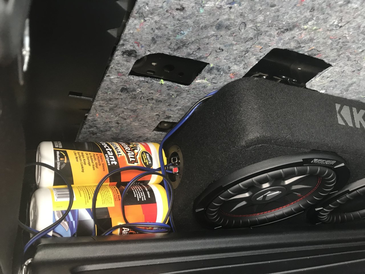

    Hey all,
    Just completed my install of a Kicker 43tcwrt102 (2ohm) subwoofer system. A big thanks to Matt3400 for answering some initial questions and giving me feedback and support.
    Searching the product you can see how Matt installed his, very neatly cutting the lip of the bin so the woofer wouldn’t hit. As a side note, for those curious the bin lip is around 3 1/4” so take that into consideration if you want to drop something in.
    My original idea was to see if I could prop op the box just enough so the sub surrounds would clear the lip and still close. I tried cutting some cardboard about 2 inches stacked. The box sat in there nicely, but the seat was no where close to closing.
    Plan B was to remove the bin and put behind passenger rear seat area. Tip- glad I watched some videos, you must remove drivers side rear bin first otherwise you might break something. This plan worked out really well, the box sits really nicely under the child safety hooks and the width is great leaving a nice little area I have my cleaning supplies stacked.
    I have it powered with an alpine 500 watt amp and after a little tweaking it fills out the 250 kicker speaker upgrade that’s amped with an alpine power pack.
    I’ll take some pictures but I’m beat after installing the amp under the drivers seat and getting everything put back.
    Feel free to ask questions. PS, these subs are currently on sale everywhere for $183, normally $229. Not the best sale historically but good and very competitive solution for the Tacoma.

    [​IMG] [​IMG]
    In case your wondering what I’m talking about, hope the image works

    :thumbsup: waiting on pics... you have JBL or Non-JBL set up?
  4. Mar 17, 2019 at 12:10 PM
    JCTacoma330
    JCTacoma330 [OP] Well-Known Member
    Feb 9, 2019
    #282382
    84
    Justin
    2019 Black Tacoma DCSB OR MT
    None
    Hey, thanks for the message. Just went out and snapped some photos. I have the non-JBL premium entune system.
