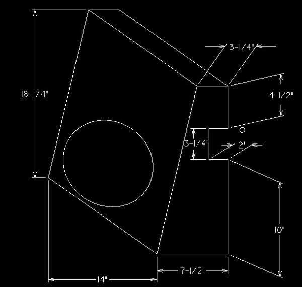

    I was thinking about putting in my old 8' L7 I had laying around in my 08 dbl cab. Has anyone manage to put one of these guys in there dbl cab? I like the other subs also but since I have this laying around I want to throw this instead of spending more money. I want to install on the passenger side which has more room so any suggestion would be helpful, sub box dimension.
    Thanks

    MJonAgs32,
    Love the box dude, but it looks to tricky to build, I might have to take it down to a shop to build it for me with your specs.
  11. Apr 4, 2012 at 7:28 AM
    MJonaGS32
    MJonaGS32 MJ on a GS
    Apr 14, 2009
    #15949
    11,465
    MJ
    SF Bay Area (East)
    07 Mid-Travel 4x4 DCSB 6spd
    Kings Mid Travel, BAMF bed rack, RTT, dual battery, OBA, ARB locker, 4.56 gears
    The box wasn't too hard to make. If you have a basic table saw you can pump it out.
    The plus about this design is you can keep the child hooks behind there. The channel on the back of the box fits right over it. That way if you decide to remove the sub, everything is still in tact.

    Thanks for the info, will gonna have to find time this week to build it and see. Will post pix later when done.

    Will it seems that the build didn't go too well and came up looking bad. Well now going to find someone local to see if they can build me one. It was worth a try.

    Ahh sorry to hear that. Yeah just give them that diagram and they should be able to do it (or come up with their own)
