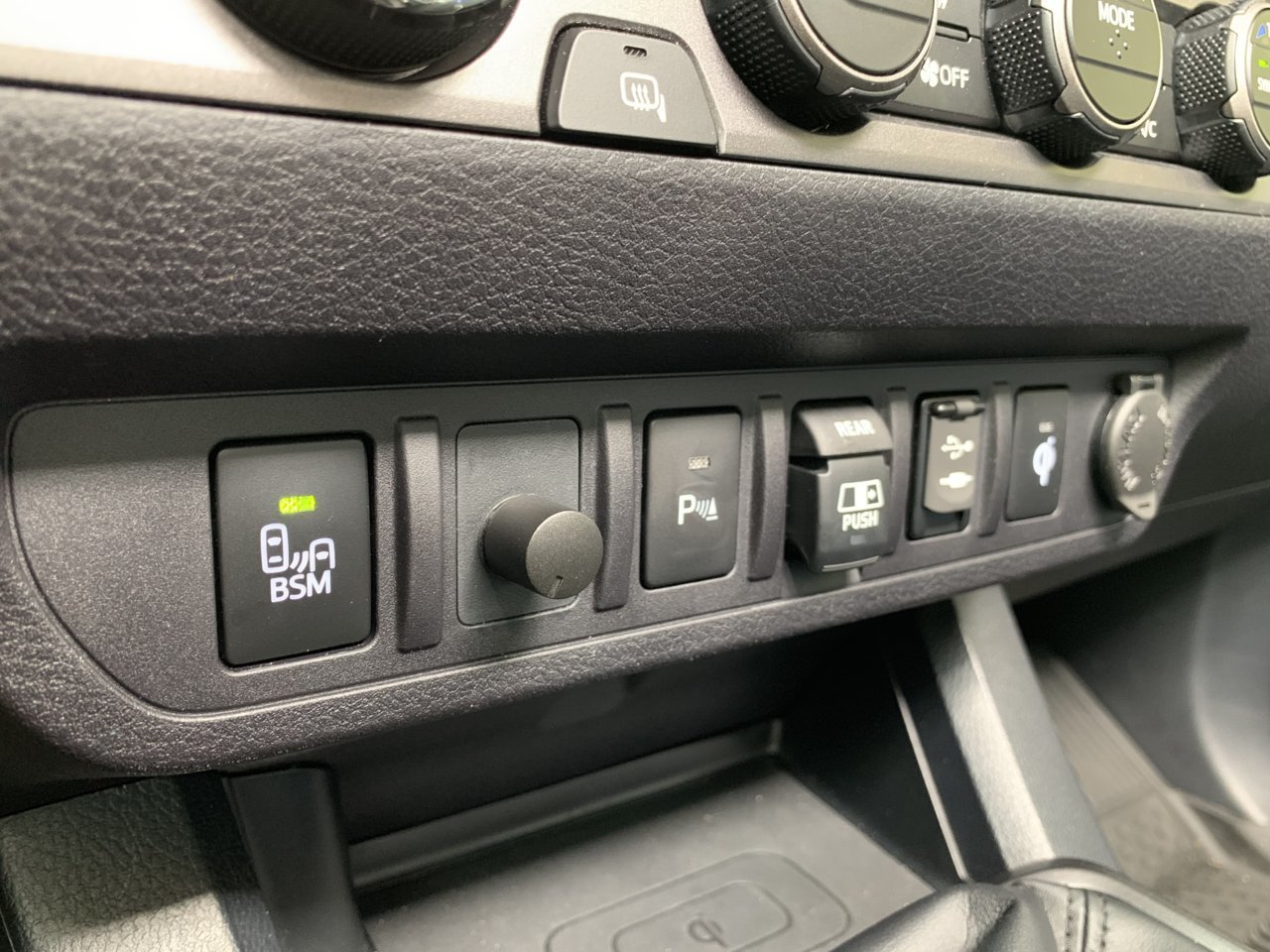

    Has anyone had luck disassembling their Kicker remote bass knob? I’m trying to mount it in a blank OEM switch location under the climate controls.
    I can’t seem to get the plastic knob off, I’m wondering if there’s a trick to it or maybe it has a barb inside that makes it impossible without destroying the knob. Thanks for any advice!
    Here’s the knob
    Here’s the result I’m looking for

    Finally got a chance to do this today, it worked perfectly, thank you for the advice!!
