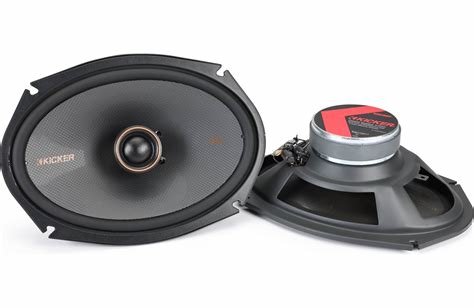

    Shortly after buying my 2020 I upgraded the door and dash speakers. I bought Kicker 46CSC6934 for the front doors and Kicker 46CSC674 for the rear doors.
