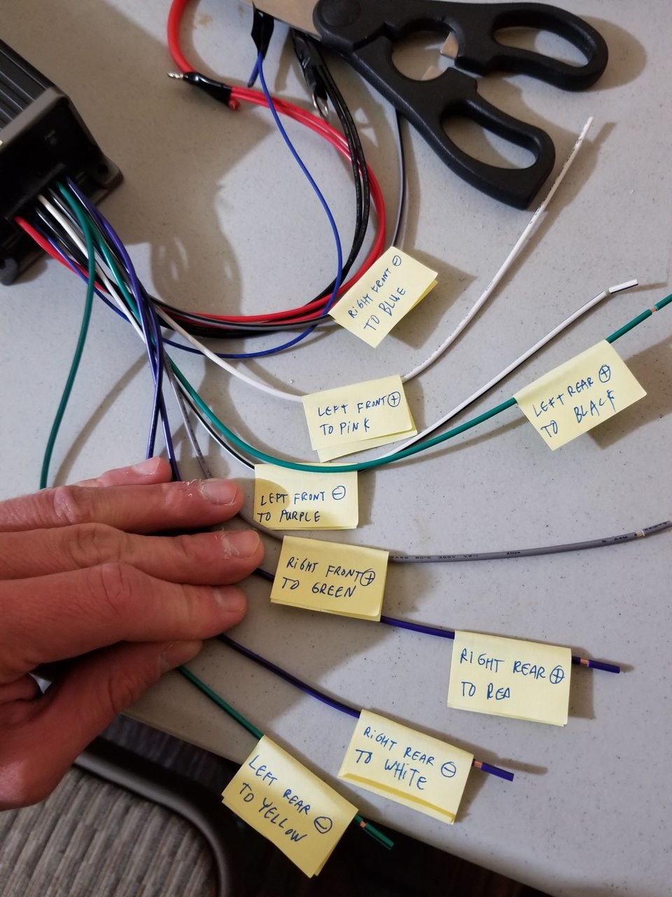

    Refer to the Metra packaging and the Kicker packaging. If you didn’t use the Metra harnesses then Google Toyota audio harness or something like that. I honestly can’t remember what connects to what without tearing my dash apart to look.

    Get the metra harnesses so you don’t have to cut your factory wiring. They’re too cheap to skimp on
