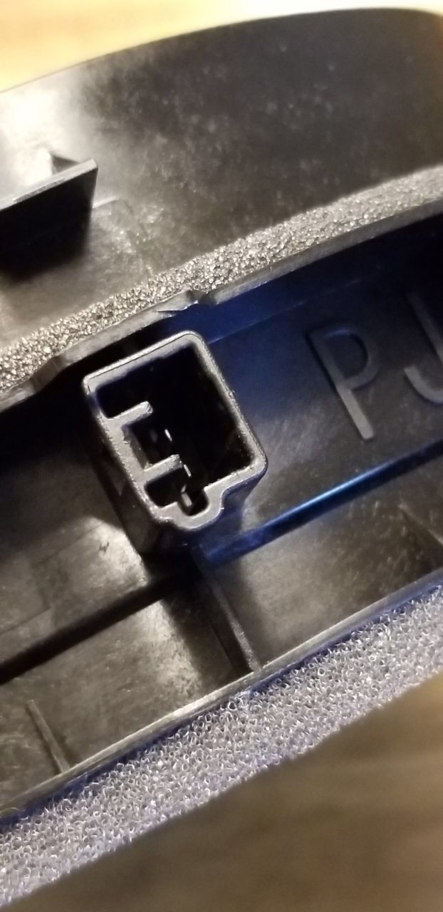

    Does anyone know what adapter I would need to use for the rear 6-3/4?
    For whatever reason the AT 2020 Pros came with JBL audio and the MT Pros came with "premium" audio and I can't figure out the part number.
    I'd rather not butcher the factory harness if I don't have to.

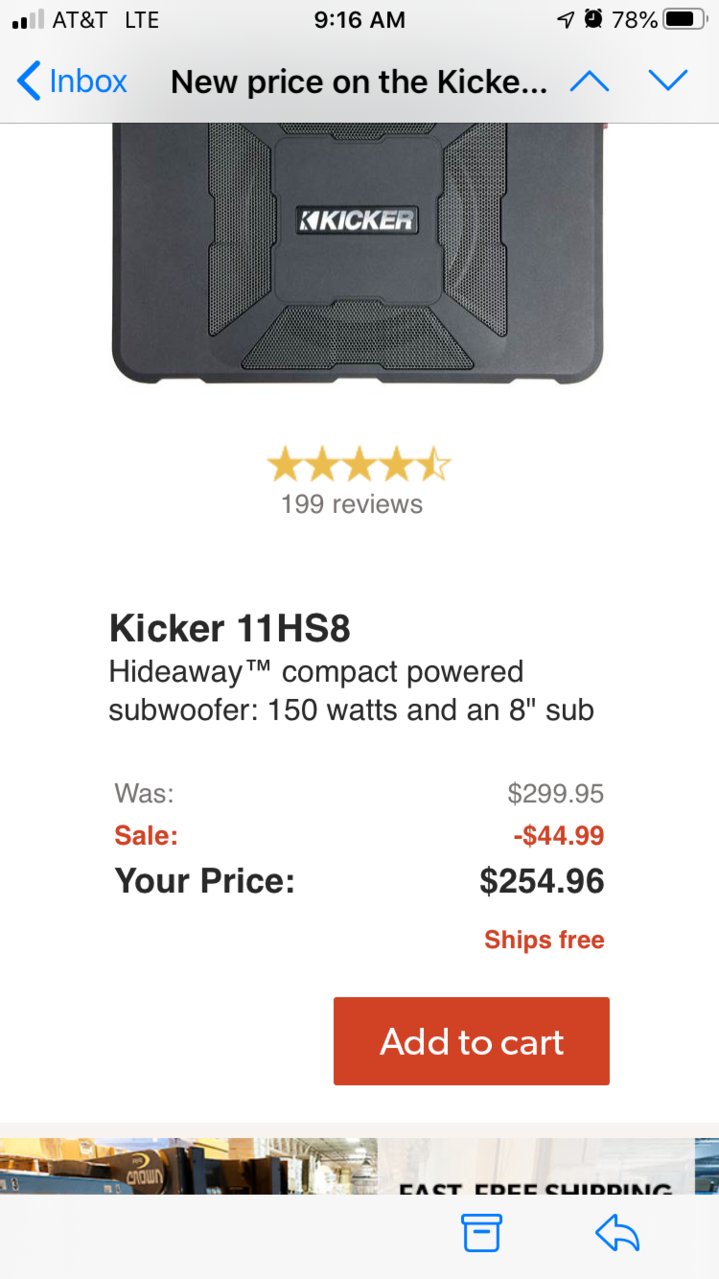

    On sale at Crutchfield

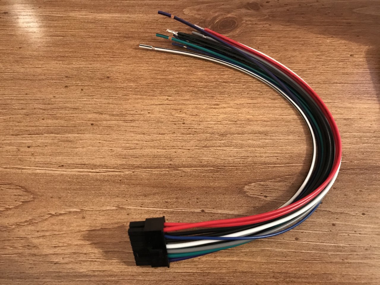

    Just wanting to make sure I am correct here. If I am going to wire for the hideaway sub only, no key amp, and I wanted to use the Metra harnesses, I just combine like colors and tee off off the white, white/black, grey, and grey/black for line level input, and off of the blue/white for a remote signal? Then power and ground go to their respective places outside of the harness.
    EDIT: Got the answer. Thanks Destin Meeks! The answer is yes, if anyone needs it...

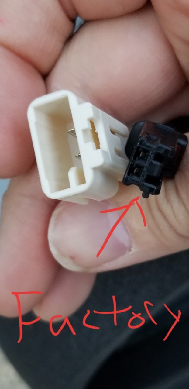

    So I'm not sure if this had been discussed before but I'm going to ask anyways. So I was replacing the front and back speakers in my 2019 and it must have rained beforehand and I noticed water is getting into the doors. I see there is weap holes for the water to drain out so I am guessing that it is supposed to happen but am wondering if the people that installed new speakers in front and back doors did anything to prevent the speakers from getting wet or just left as is. The only thing that I have seen is the speaker soft box that will protect the back but not sure if that would mess with the sound output.

    Speakers are designed to get wet with rain water. I personally only used stainless screws/bolts for this reason. The included screws with most speakers might work just fine, but I always tossed them straight into the recycle bin and grabbed my stainless hardware. But at this point, I’ve installed literally hundreds of pairs of speakers across nearly every major brand and haven’t seen any issues, and I’ve pulled literally hundreds of pairs of factory speakers out and very few have rust on them, even in 20+ year old vehicles.
    The ones I see rust or fail from water are the cheap brands (boss, Pyle, dual, etc)
