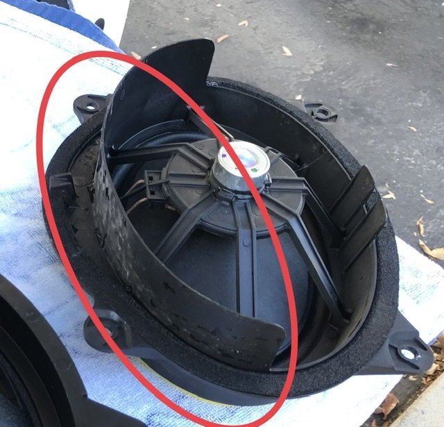

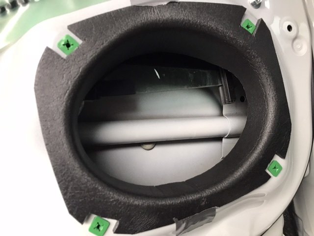

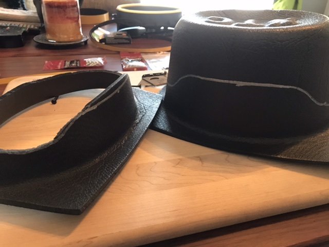

    If you want to replicate the plastic hood on the OEM speakers (circled below in red,) you can trim a foam speaker baffle to the same basic shape. An added benefit is that the foam between the door panel and plastic speaker bracket makes a perfect, rattle-free seal.

    Did you try it with the whole baffle intact first? Did it sound bad or good?

    I did not. Most posts about the baffles that I read on other threads stated that it made the sound quality worse.
    Edit* Now that I think about it, the full baffle wouldn't fit with the window rolled all the way down. The way you see mine cut is about as far back as it can go without interfering.
