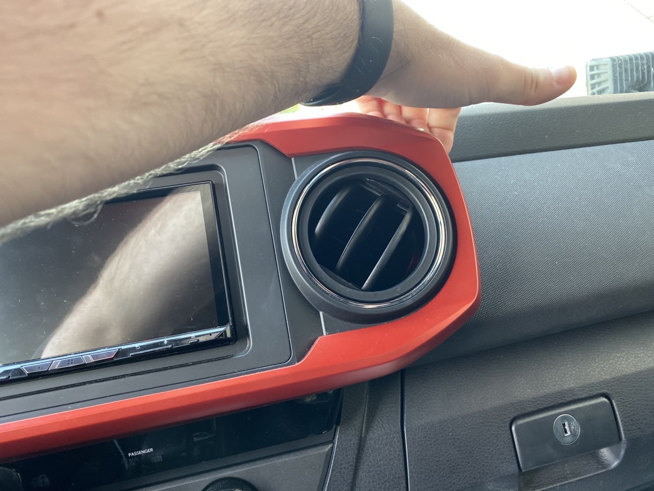

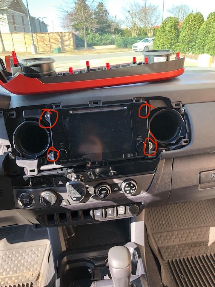

    Only need a 10mm socket
    pull trim off (orange plastic in my truck) and remove four 10mm bolts

    Thanks man. Your the king. I’ll jump on that tomorrow morning.
    From your picture, it looks like the trim just pops off with a good tug, right?

    Yep. Super easy

    Yes. REALLY easy. Look up MESO’s how to video for the start ring if you have any issues Craig.
