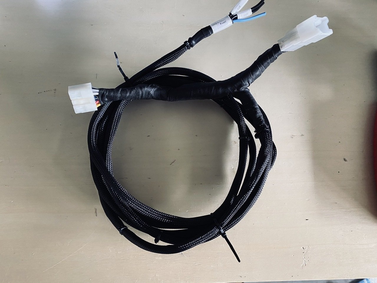

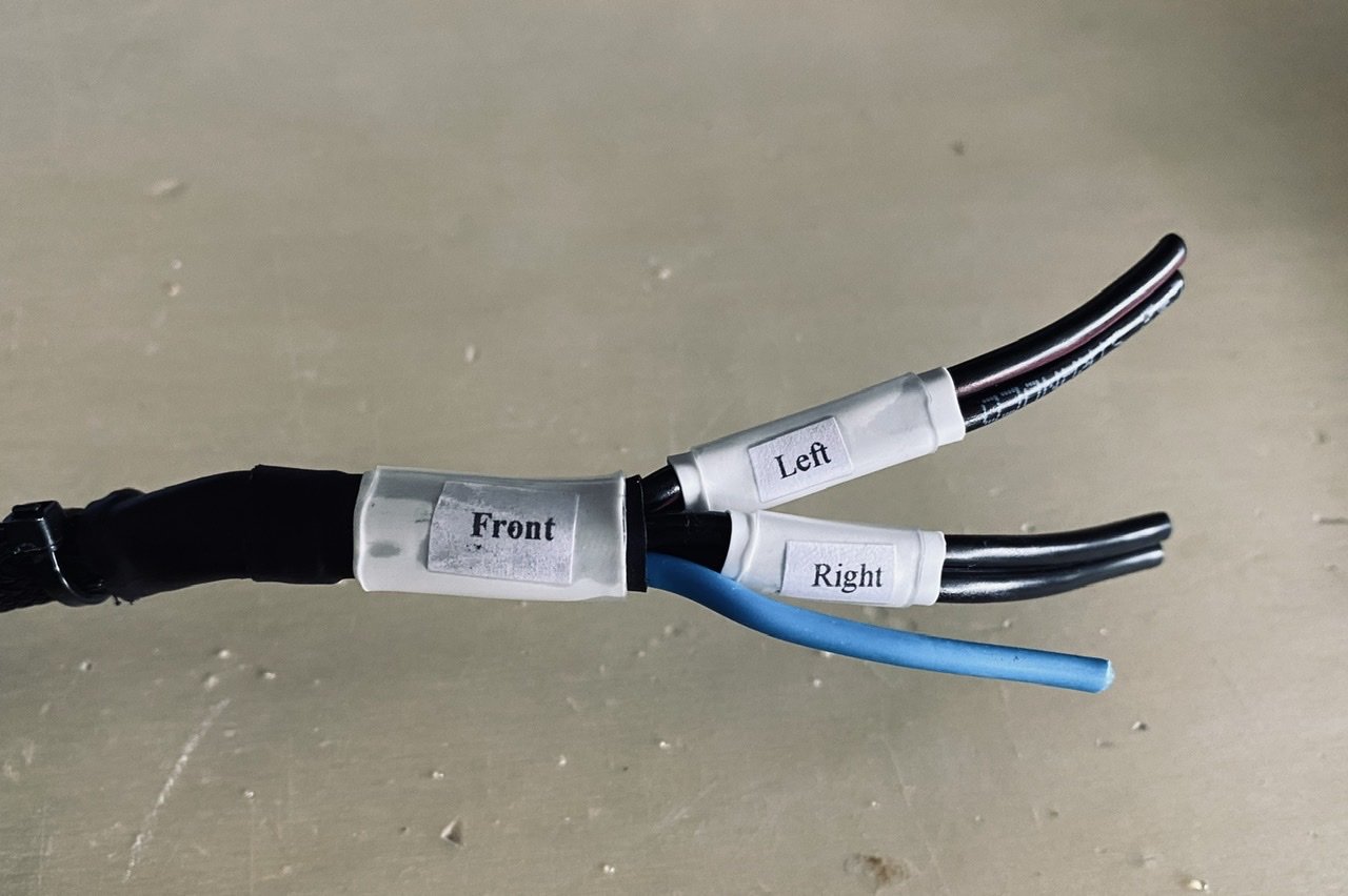

    @destin_meeks sorry to bother you, I know EVERYONE comes to you. If you get the chance can you see below and give me a thumbs up or down? Appreciate your time and all you do to answer questions for us!!

    Yeah looks right. Just make sure the wires from the male connectors (that would plug into the radio) go TO the amp/DSP, and that the wires from the female connectors (that connect to the factory wiring) are coming FROM your amp. Unless you plan on running new wiring to your speakers

    Yeah, I just did a t-harness with 5 leads (front- left/right and remote) as I am going to abandon the factory speaker wires and run new wires to all the doors. Thanks!
