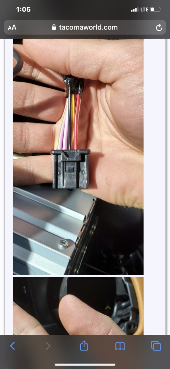

    Happy to report back that I finally got it to work! What I ended up doing was Posi Tapping into the speaker wire that I added which was thicker than the speaker wire coming out of the Headunit harness. I think the smaller wire didn’t have enough meat to make a solid connection.
    I really can’t thank this forum and especially @destin_meeks for the assistance. I am a lot more educated about our trucks audio because of you. I appreciate you all!

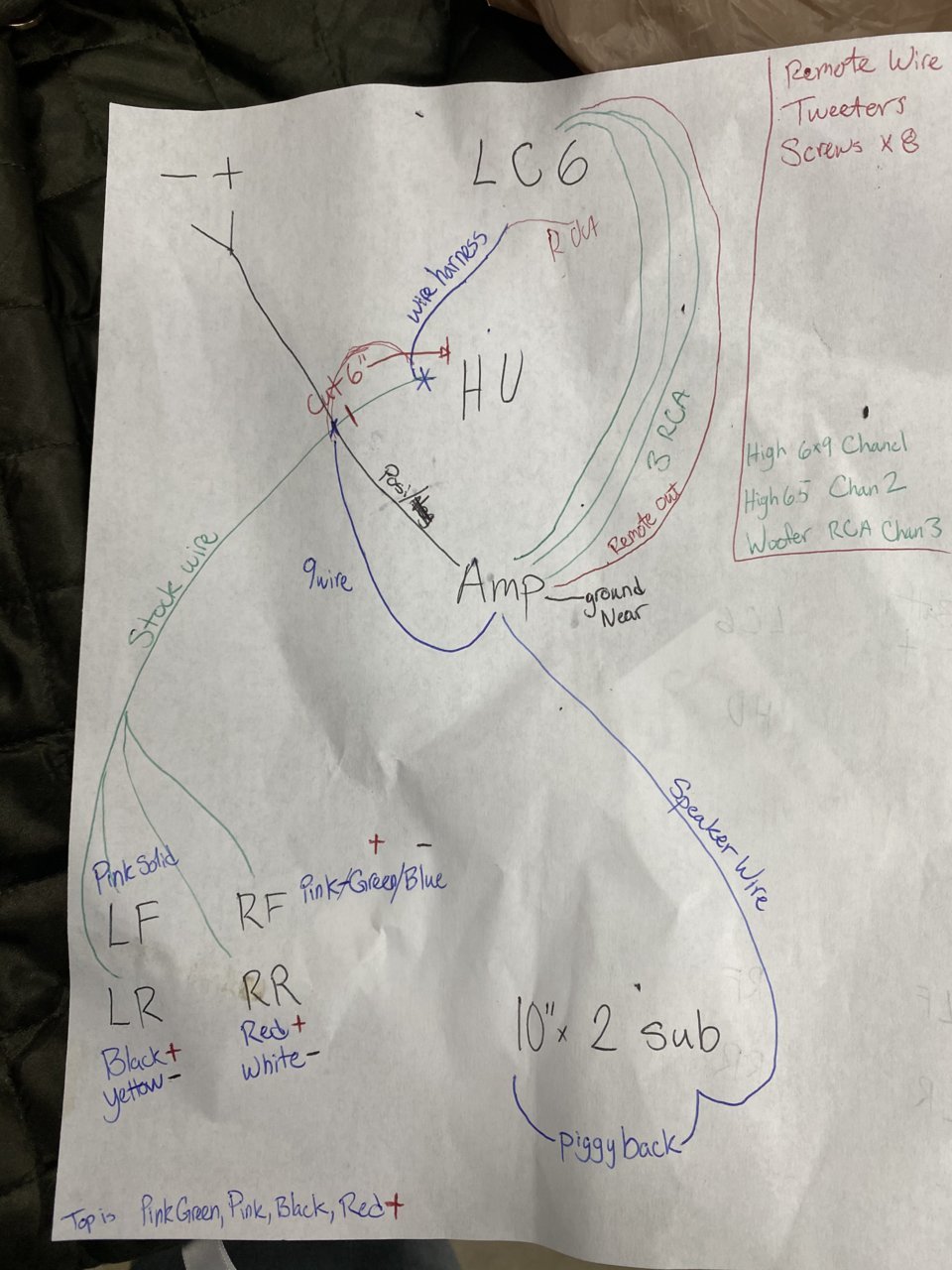

    Hi All, new here, just got my Tacoma a few days ago. Traded in my FJ Cruiser which I tore apart and rebuilt the entire stereo system in. that one was simper in concept for me since I pulled the entire existing system and built a new one from scratch. Been making lots of purchases for the new truck, and a few have been audio centered around what you all have been discussing. My plan is to do the Kicker speaker swap, add the hideaway and put in the key 180.4. I am a bit confused though on the hierarchy of how the harness' connect into the system.
    I have a number of questions:
    Does anyone know if the metra harness part numbers are still valid with a 2020, NON-JBL, 8" screen version of the Tacoma?
    Does one of the harness' plug into a spare on the back of the stereo? or do the two metra part numbers work together and act as a go between. E.G. Stereo--->Harness--->Back to factory wiring for dimming, common, switched power... while peeling off remote turn on and speaker wire for the Key and Hideaway amps?
    When pulling off leads for remote turn on, and speaker inputs to a key amp how are you adding the rear speaker. I thought that was off of a separate harness? The key is a 45X4 right, or are people bridge-ing it down and just running the front speakers?
    Lastly does anyone know of a good color coded wiring diagram for the 2020 non jbl stereo wiring, im an electrical engineer and looking at a wiring diagram would really help me visualize how all this ties together.
    Thanks for everything ive already read in this thread! Im excited to start this, loving my new truck and am excited to enjoy the stereo after the upgrade!

    E9D8C1AD-97A3-4318-A9F6-2601B3F8285E.jpg F7D2425F-495C-4FF3-A70C-2A1D8131E797.jpg

    Thanks, Taco Cabal, I think im starting to piece this whole thing together in my mind. I already installed the tweeters, they came early and I saw no reason to wait, took about 20 mins. I ended up ordering two metra harnesses for the 2020 head unit:
    70-1765
    71-1765
    To wire the key amp between so I don't need to hack into the factory wiring too much. Now I'm just waiting for my door speakers, and harnesses to arrive.
