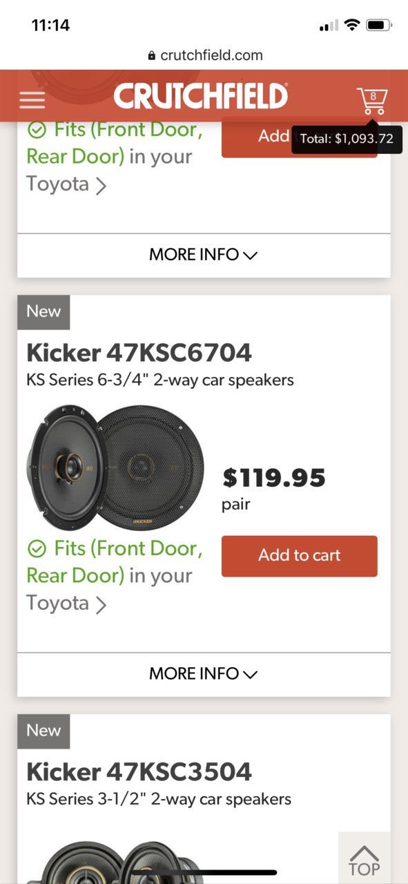

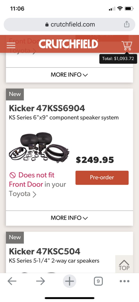

    So the tweeters in the KS component system would replace the Subaru tweeters? It says here that they don’t fit the Tacoma and they aren’t even available in Crutchfield. Then I guess I would get the 2 way KS for the rear. Probably just wait on the sub if I go this route. I’d rather do it right

    You are correct, that tweeter would replace the Subaru tweeter. They were just announced a few months ago and the official release got pushed back a tad from Covid, so they’re not out yet. Crutchfield (for some reason) says many of the KS line won’t fit (even though I and many others have them in their trucks and can confirm they fit fine.
