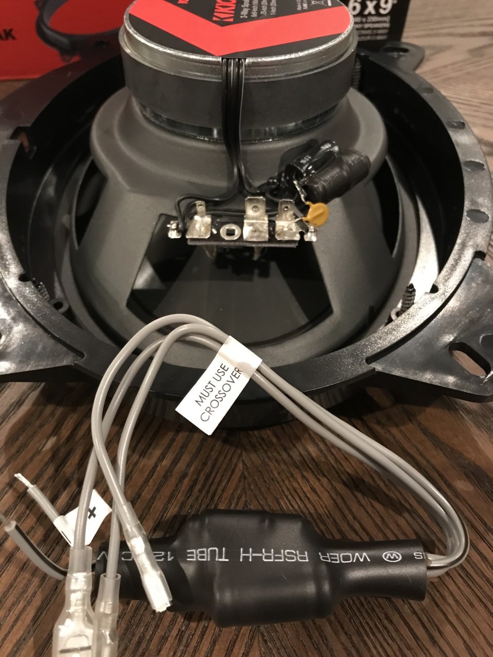

    I have a question, my Kicker 47KSC69304’s came with a “must use” crossover.
    Do I really need to use it or does the factory already have a crossover?

    So I need to wire in the supplied cross over to the factory plug harness?
    these 6x9’s have 3 terminals which is odd.

    Wait... you got the KSC (3-way coaxial) and it has an external crossover? I’m confused

    Yes exactly!
    now you know why I am asking, it has a cross over (assuming for the tweeter) on the terminals, but they came with an external crossover with a tag on them “must use”

    Would you mind posting a pic of that if you get a chance? I can’t find anything about that

    here you go

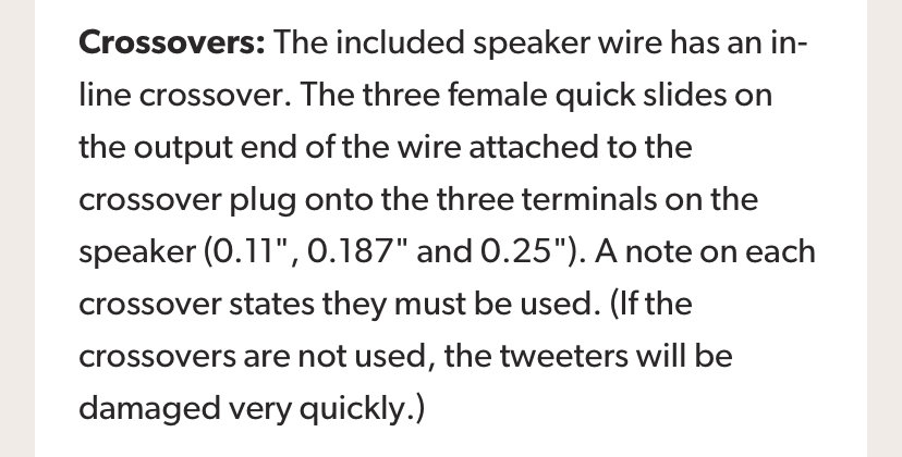

    This is what I found at Crutchfield.
    Sounds as if the three terminals may be different sizes to coincide with the three connections on the inline crossover. Owner’s manual doesn’t say anything helpful about them.

    I suppose that settles it, gonna wire the external crossover in before install!

    Wish I could be more helpful than using Google Fu. I’ve never heard of a coaxial speaker with an external crossover either.

    me neither and the reason I asked, thought it was odd.
    I mean they are not components right?

    Technically, a three way coaxial is composed of three separate drivers, the tweeter can’t handle a full range signal without getting smoked. I’m just more used to seeing capacitors (probably what that crossover is using) mounted to the actual speaker rather than separate.
    Only difference between what you have and a component set is the tweeters are collocated with the woofer, vs separately mounted as with a component set.
