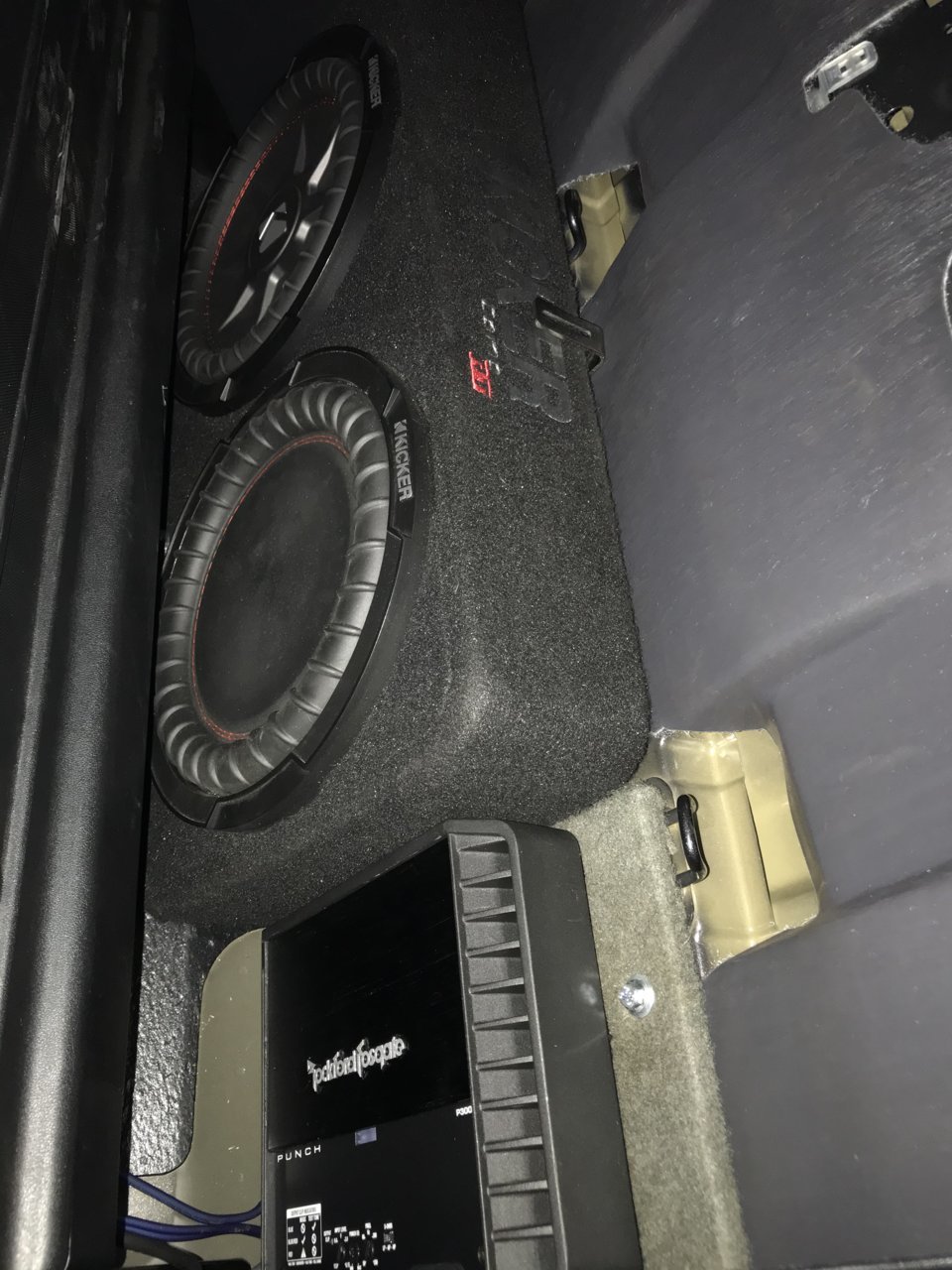

    For the 12 the bottom depth is 7 3/4”
    For the 10 the bottom depth is 7 3/8”
    measuring looks like the bottom back of the seat depth is 7 1/2” ish.

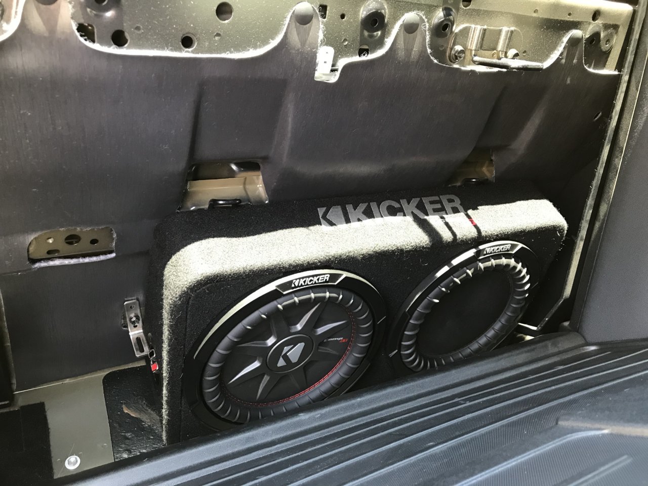

    It’s much bigger than my compRT 12 and that thing BARELY fits. I’ve tried to fit the 10” L7T when we got one in a while back and it wasn’t even close to fitting.
    And it’s not just the bottom depth you have to focus on. The top depth is very important too because the seat leans back
  6. Jul 3, 2020 at 3:45 PM

    Sadness, I will just stick with the original plan of CompRT10 and a 5 channel amp.
    Even the punch amp is too big!

    Change of plans, I was all set to get MrMarv to make me a single L7 enclosure when this refurbished CompRT 10” became available for cheap, I could not pass it up.
    I ordered a RF Punch amp, just need a wiring kit and I will be in the garage sweating it out.

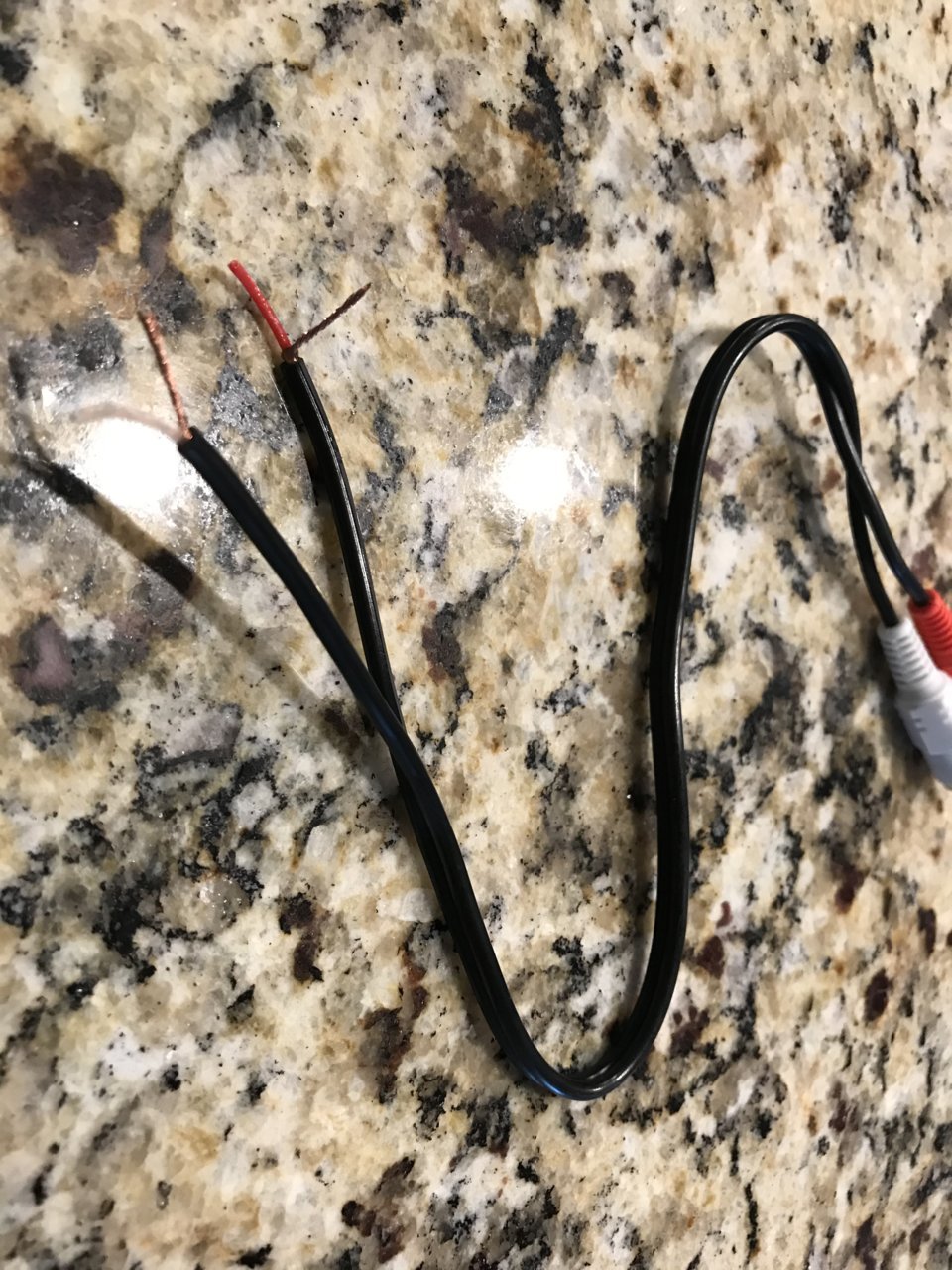

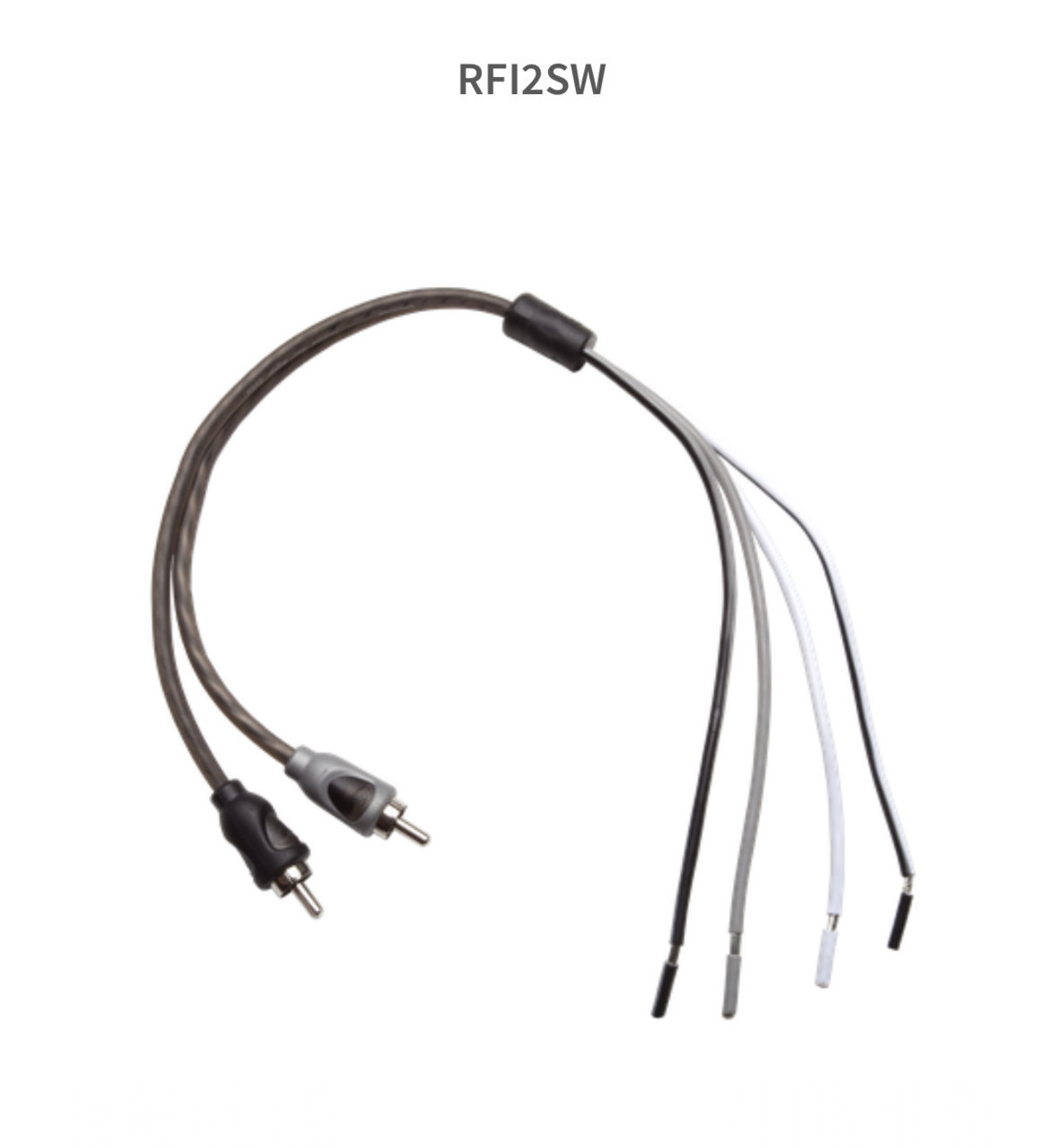

    4DB304A1-9288-49DE-BF5D-EEAB437E79DD.jpg I assume that the punch amp doesn’t come with this adapter, if I already have RCA’s couldn’t I make my own?

    You sure could.

    this is a test set - I believe the interior shielded wire is the negative (-) while the outer stands are the positive (+)
    Correct?
    Update: after googlefu - I have it backwards.
    The outer strand is the negative and the inner stand is the positive.
    Just on these cheap test cable the inner strand is so small compared to the outer strand.

    They’re thing because most RCA cables are made to vary very low-level audio. I personally wouldn’t use those if it was me. The RCA-to-speakerwire adapters are too cheap

    I have a good set of RCA’s that came with the wiring kit that I can use, but I wanted to cut an freebie RCA set to what I was getting myself into.

    Well RCA cables are all very thin wire, because they’re not designed or built to carry hi-level audio. So even the “good” set with your kit will still be very thin wire

    Punch Amp showed up today, confirmed it didn’t come with the high level RCA adapter.
    So it will be here Sunday.
