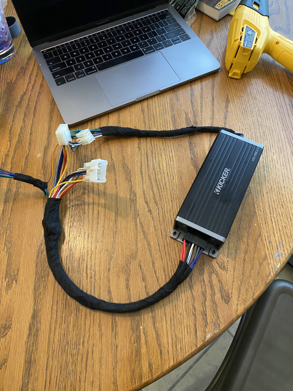

    Hope all of you are well! I've been adapting to virtual teaching the last few weeks but I'm ready to tackle the Hideaway install. I'm good on how to do the power and negative cable runs now but am curious how to go about doing the speaker wires and remote wires. I already have the t harness for my kicker key to splice into. IMG_0064.HEIC.jpg Any suggestions? T-taps, line splice, cut existing speaker wires and blue/white wire on harness and then add new wires from hideaway harness and solder? Thanks!

    Got it installed today! Negative ground went to grounding point underneath the drivers seat carpet. Ran speaker wires and remote wire under carpet and pulled up behind center of dash. I set the kicker key to 60hz and I may keep playing with it. I definitely don’t have the overall boom I had from the door speakers anymore but I do notice some lower sounds I didn’t hear before. At this point it’s a trade off to me. I’ve got a few weeks for a return period if I want to look at some other options.

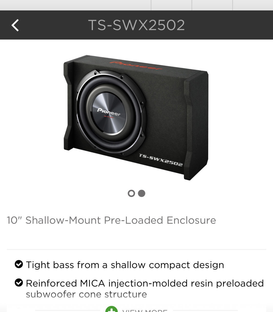

    Correct me if I’m wrong but would that mean an amp like the Kicker 400 ($149) and a subwoofer like this one might be better? I’m trying to educate myself a little bit and have concluded a 2 ohm subwoofer will utilize the amps smaller power better. Does that seem right?
    These Pioneer shallow ones might fit the cubby. ADBDA440-C567-4E3A-BCAB-8F4ADF669C4F.jpg

    You need the one that doesn’t have the little legs on the front of it. Those make it a bit too big to fit in the cubby. But they make the loaded enclosures without those legs too. The Kicker compRT 10” loaded enclosure fits too, and has a passive radiator to make it hit a little deeper than most shallow 10’s in a small box.

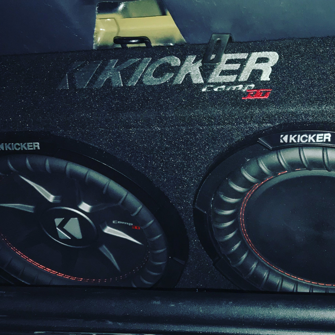

    here is a better picture, just removed the passenger cubby and it fits with room to spare.
