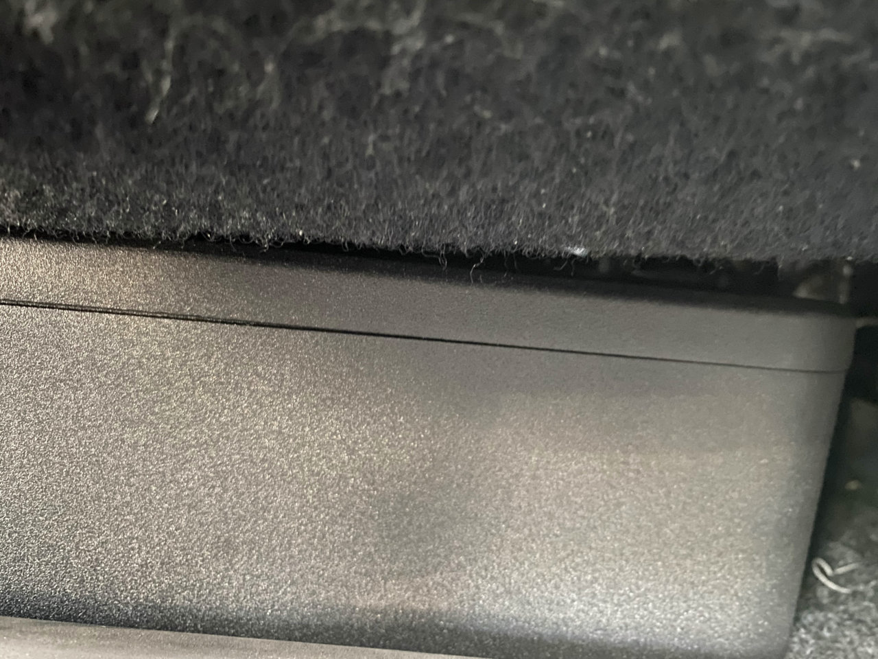

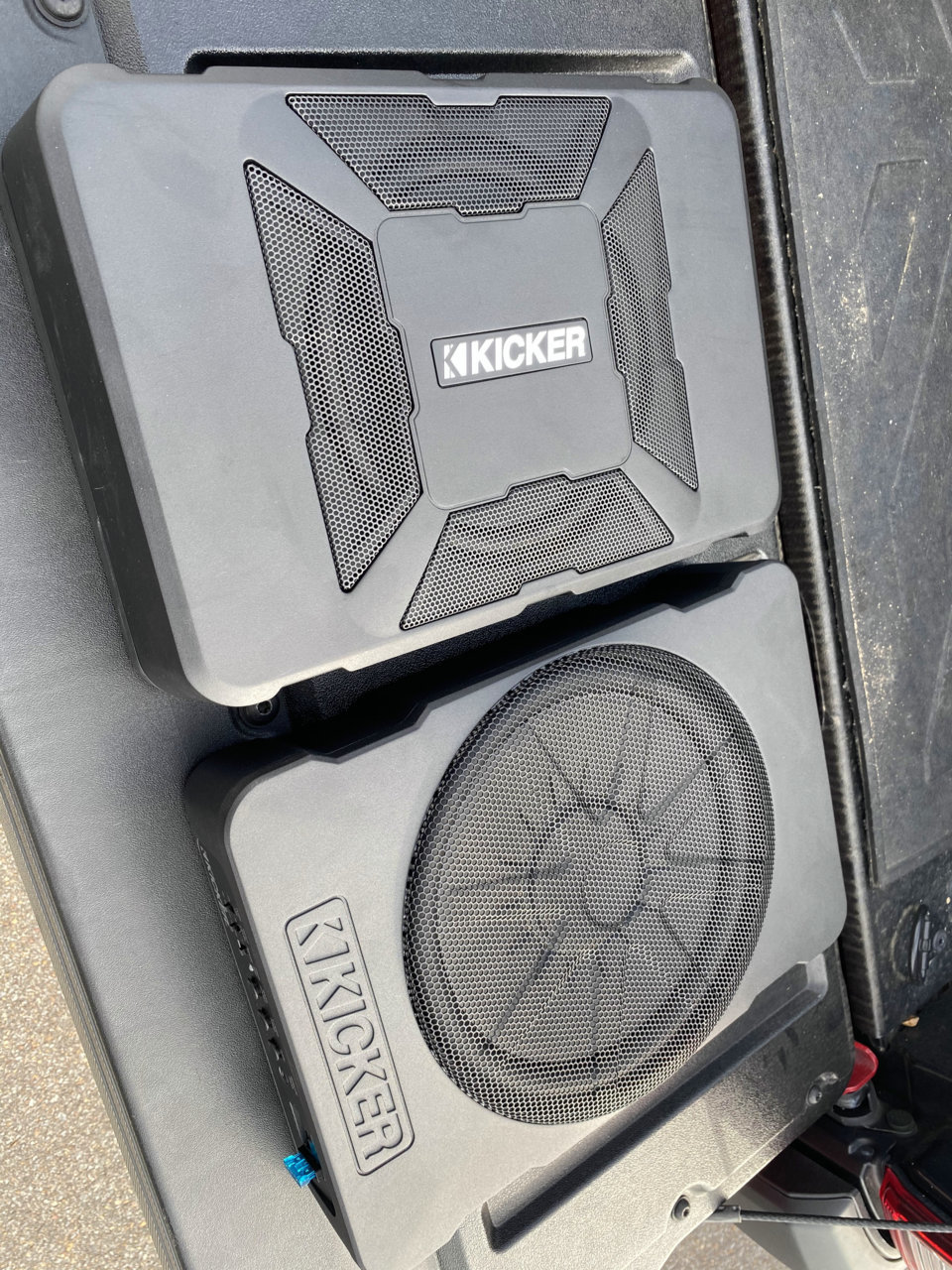

  12. Sep 18, 2020 at 8:34 AM
    #652
    AUTacoma18
    AUTacoma18 Well-Known Member
    Dec 28, 2017
    #239640
    100
    '19 TRD OR DCSB Barcelona Red

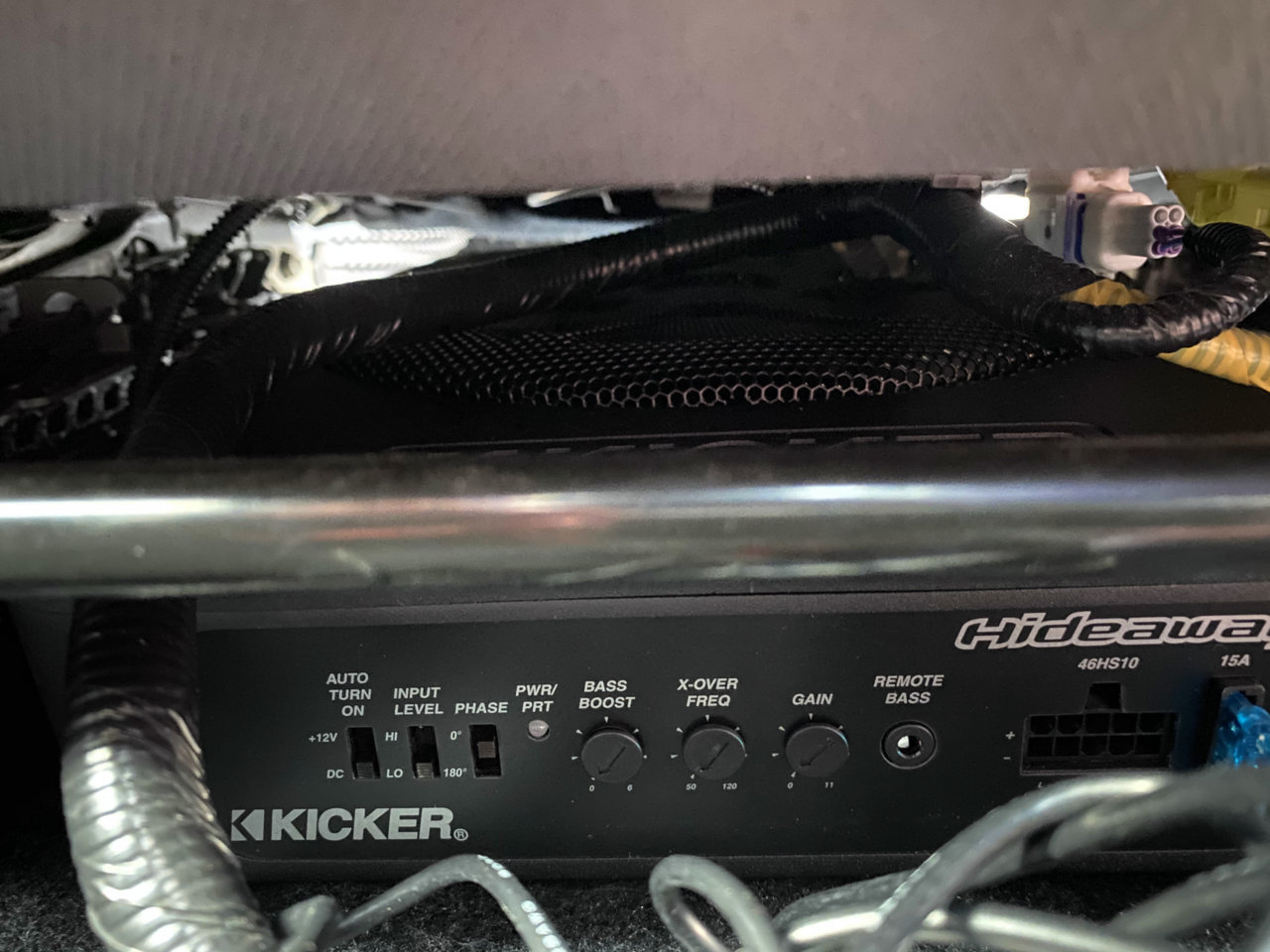

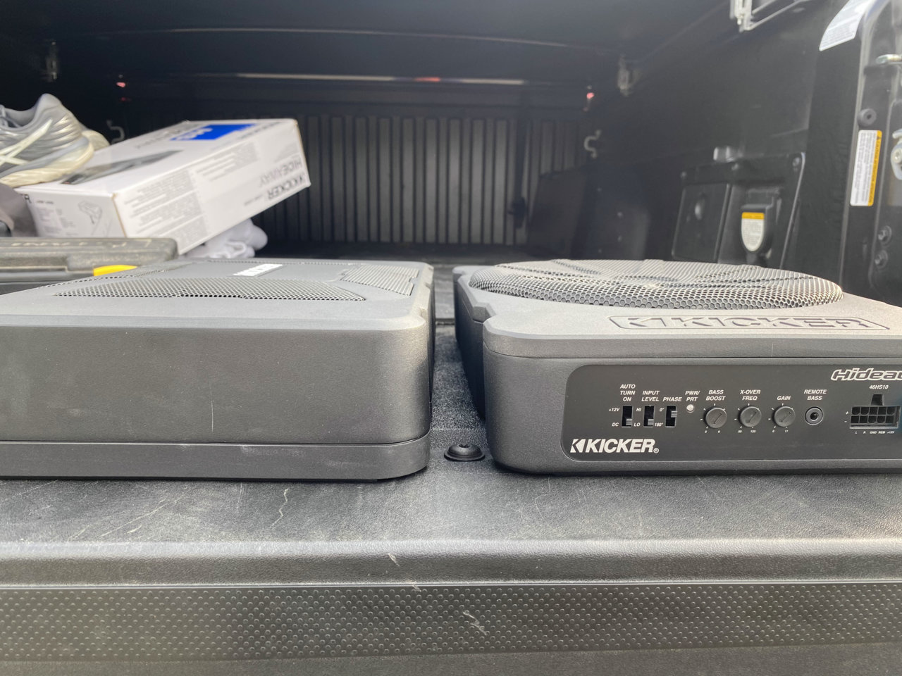

    Hideaway 10 came in. I've provided some pictures to compare it with the Hideaway 8. I can confirm that the harness is the same. It looks like the only difference with the input side is that the 10 uses a 15 rated fuse. I'm also excited to tell you guys that it does fit under the seat! The wires that are underneath the seat sit on top of it but I'm pretty sure they did with the 8 as well. I felt pretty confident that it would because the dimensions listed on the Kicker website are nearly identical for both of them. I'll update soon on whether there is a difference in sound once it breaks in a little. IMG_0589.HEIC.jpg IMG_0590.HEIC.jpg IMG_0591.HEIC.jpg IMG_0592.HEIC.jpg

  13. Sep 30, 2020 at 9:30 AM
    #653
    harpo1
    harpo1 Well-Known Member
    Sep 1, 2019
    #303921
    77
    So what's your thoughts on the 10 compared to the 8? Is it worth the extra $50?
  14. Sep 30, 2020 at 10:03 AM
    #654
    AUTacoma18
    Dec 28, 2017
    #239640
    100
    To my ears, no. I have been fiddling with the frequencies on the Key and the Hideaway. The 10 has an extra 30 watts of rms to push the 10 but it’s still to me going to round out the system like the 8 does. Neither will rattle the doors. If you have the Key, it might be an option to look at a an amp and a passive subwoofer.

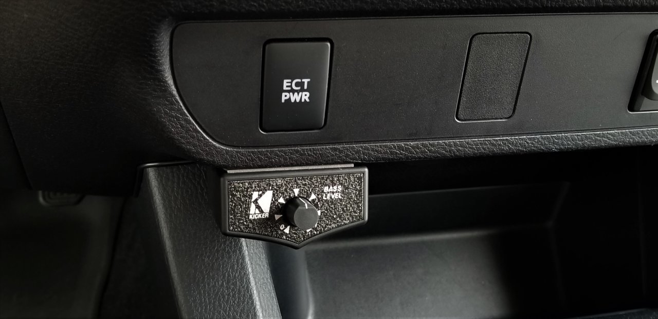

    Edit: Where is everyone putting the remote tuner knob?

    Underside of the dash below the ECT button. Attached with 3M automotive tape; degreased both surfaces really well and it's held for nearly 18 months now. The cable is just wedged into the seam between the dash and console, but could be totally hidden with a little more effort.

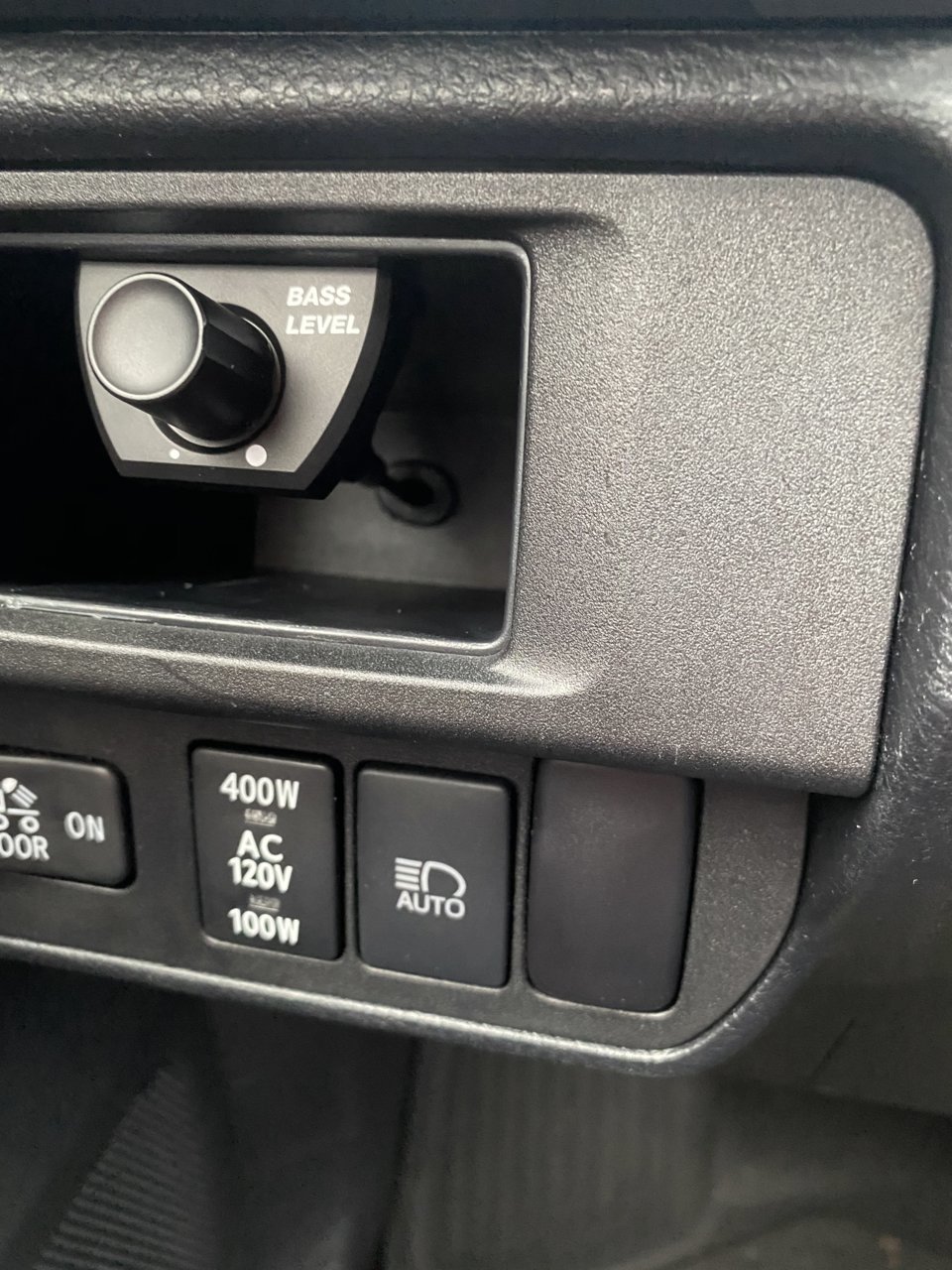

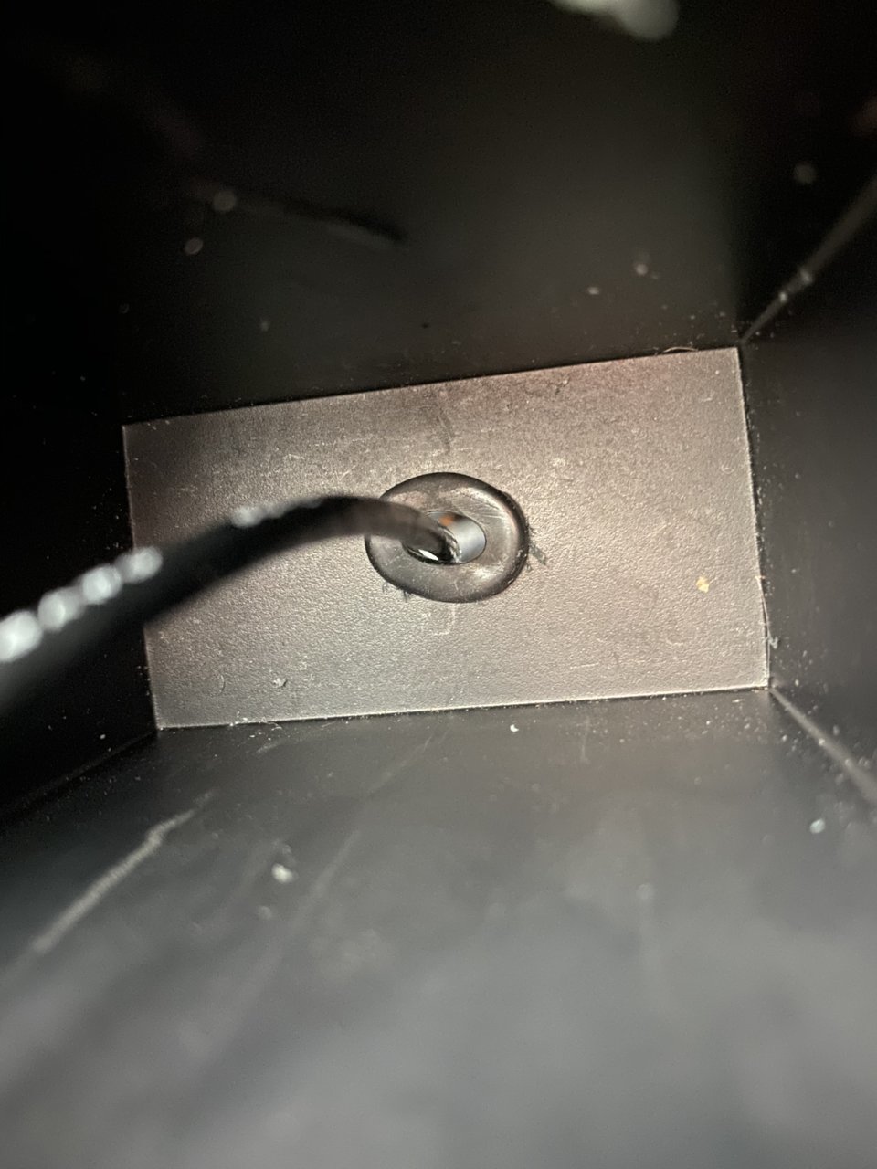

    Drilled a hole in back of cubby pocket, installed rubber grommet, and used screws screwed from top of cubby pocket to lock remote down. Cable is behind kick panel and underneath carpet. 526D15AE-290E-4298-B914-486782B5660C.jpg5C5776C3-2E09-4D1B-B3FA-890FBFEC7C22.jpg
