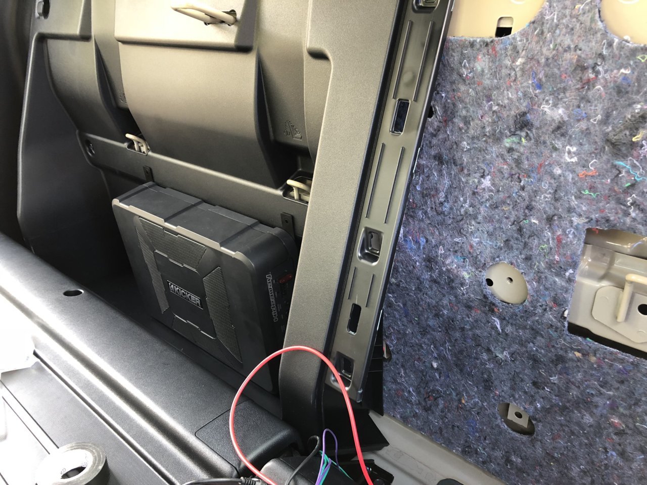

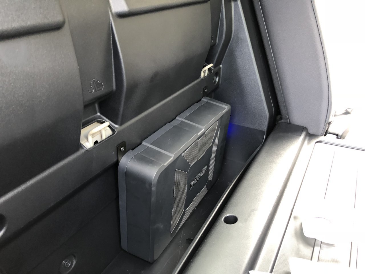

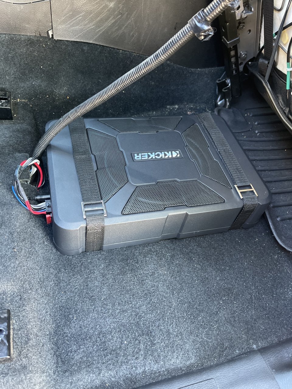

    I couldn’t fit mine under either seat. Passenger has a bar under it, power driver would not fit. I put it behind passenger side rear seat. 7769C531-493A-46DD-ADE5-CA63A7DFD2B1.jpg

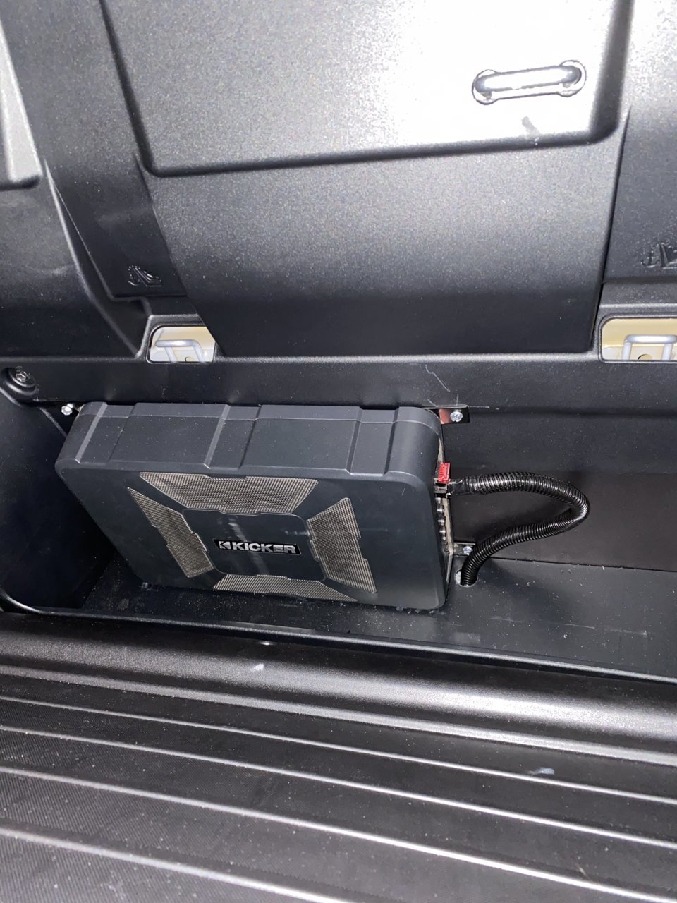

    I had them install under the driver seat and it seems top be working fine. I can feel the bass more than if under the passenger seat but overall a huge improvement. I did notice that not only is there a crossbar under the passenger seat but there are also two AC ducts that look like they blow air to the rear seats and the box would block them so I think the driver seat is the right decision if you can get it to fit and it is tight.

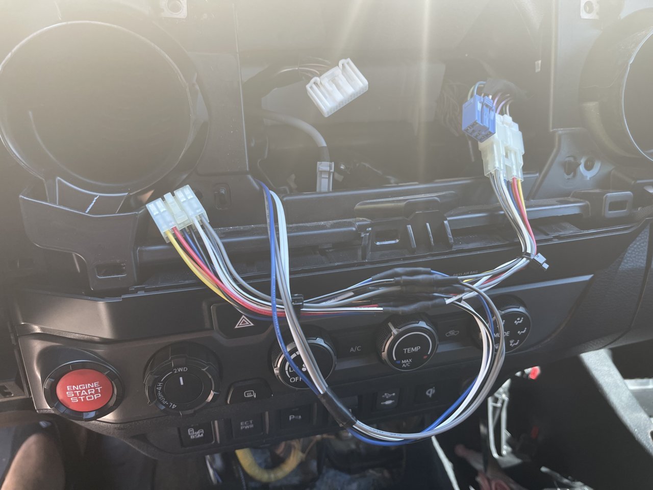

    got it installed today, everything went perfect until I go to test it and it has no sound. Got a bad unit, my fault for buying an open box to save 120$. Went and got a new one and the girl did it as an even exchange. Plugged it in and it works.

    Harness looks great! Wires at the amp look good too!

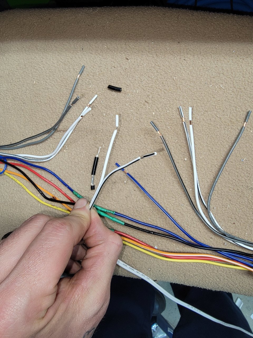

    When soldering the speaker wires into the harness,
    Is it both solid whites with the one solid white as one connection and then both white/black with the one white black? So 2 three way soldered connections. And same goes for the greys?
