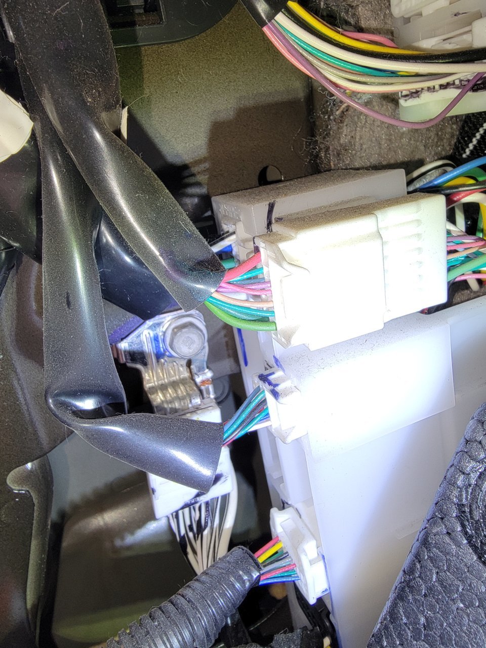

    Can I ground the hideaway to this bolt inside the kick panel?
    I'm reading conflicting things about the ground being a specific length away from the amp itself. So if I go into the engine bay and just ground off the same bolt as the batteries negative that would be too far away. I can't use the seat bolt because the connector that came with the hideaway is too small for the bolt and I'm not putting everything back together to just go get that...

    If you can reach that bolt, use it.
    Also, there’s no such thing as a ground being “too far away” as long as the ground wire is at least the same gauge as the power wire

    Well it was the first article when I googled "where to ground an amp" to weigh my options, said it should be no more than 18 inches away.
    Ended up using that bolt.
    Never done any car audio in my life or any soldering and between yesterday doing all the soldering and today the install. All set! Powered on and working first shot, woohoo. So if anybody is worried about taking this on, if I can do it, you can do it. Lol.
    Now I'm just not sure where to put the settings on the hideaway, but I just played with it til it sounded OK for now.

    I mean, in ideal situations, your power and ground runs are as short as possible. But the amp is getting connected to the battery’s negative terminal one way or another. That can be through the sheet metal of the vehicle, or through a dedicated wire.
    now you DO need a fuse on your positive wire as close to the battery as possible
