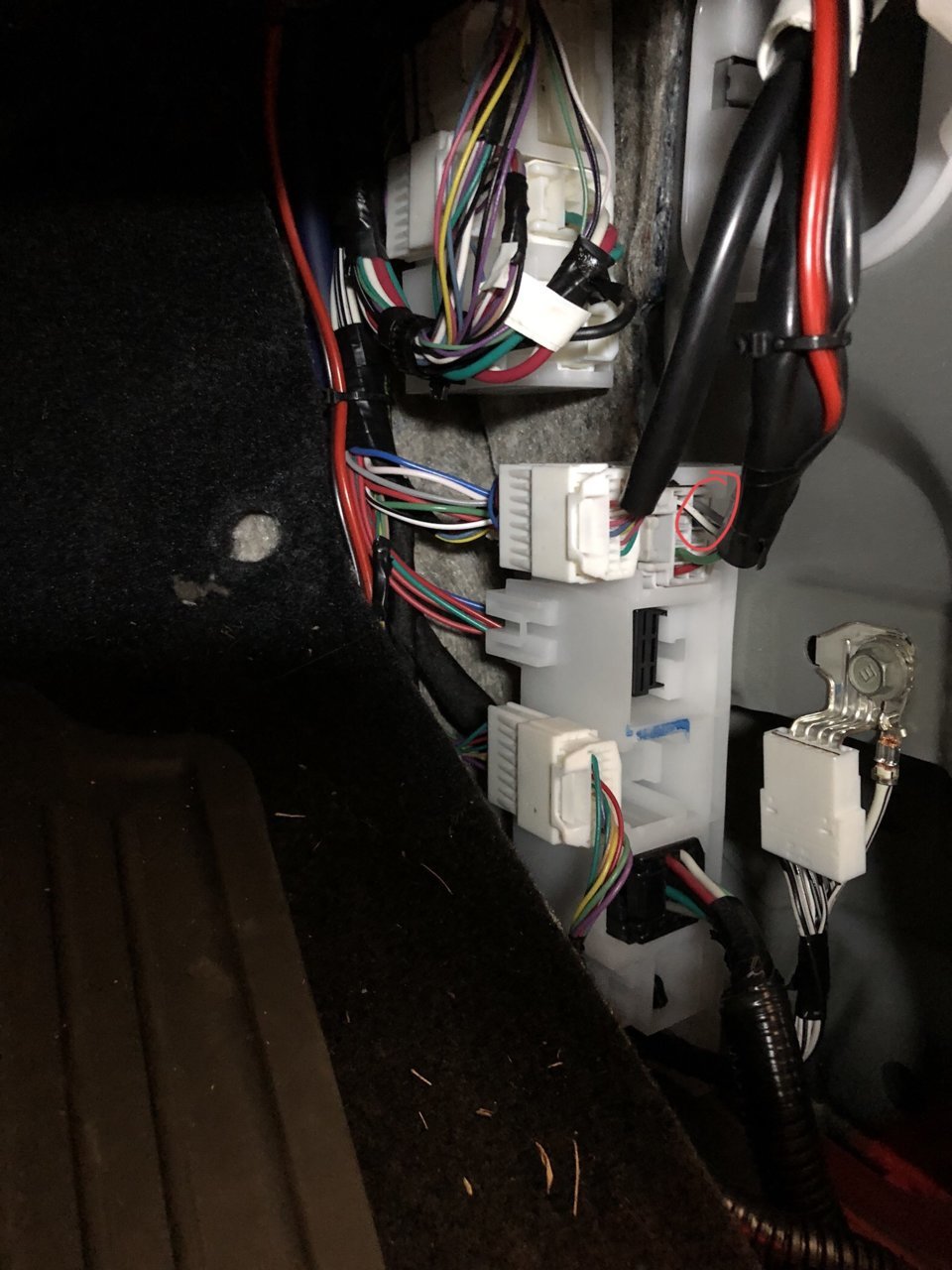

    Can anyone confirm which wires I need to splice? Is it better to do it at the kick panel, or behind the head unit??

    So hopefully you can answer my question. Where is the easiest place to splice my rear speaker wires on my double cab for the stock head unit?

    Right side kick panel in passenger footwell. You should see the connections

    Any chance you know which wires are for the rear speakers (color code)???

    I ordered Metra pigtails and did my connections that way. The pigtails plug between the head unit and the main harness. The kicker hideaway is a powered sub with the following connections: Power, speaker and remote turn on. Power I went right to the battery. Ground I connected to the kick panel area.
    All of the install information is in the first post including the Metra pigtail part numbers.
