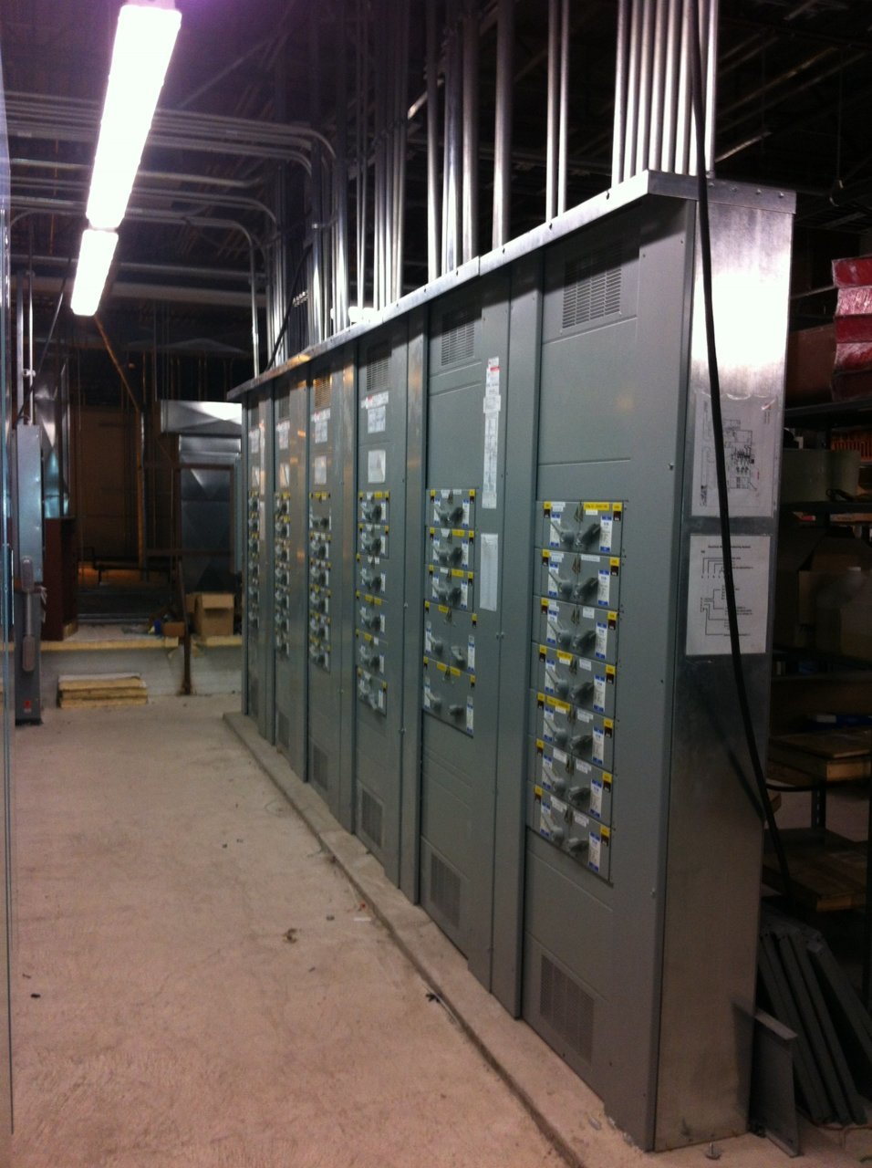

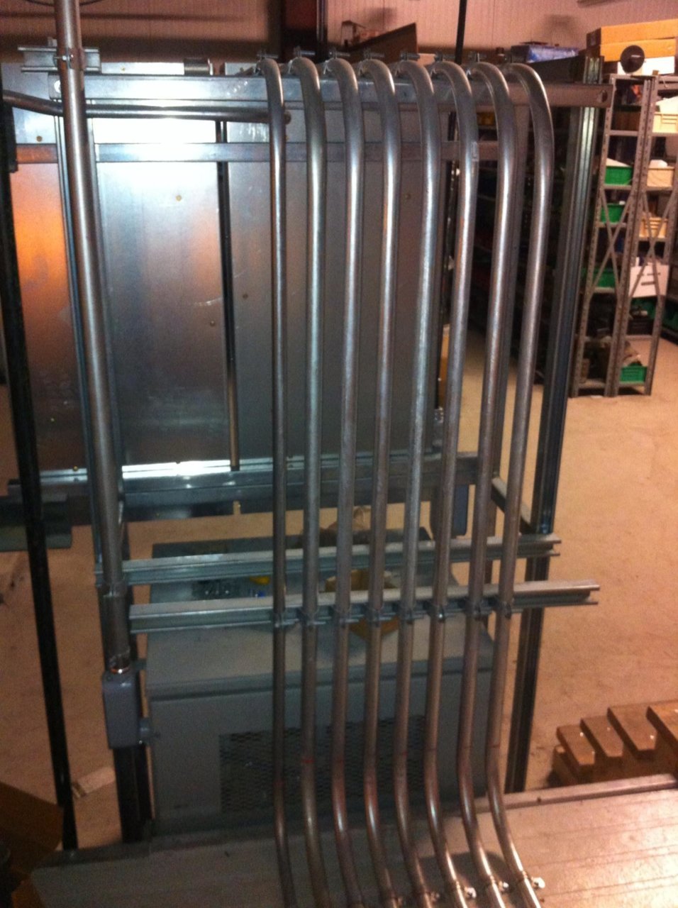

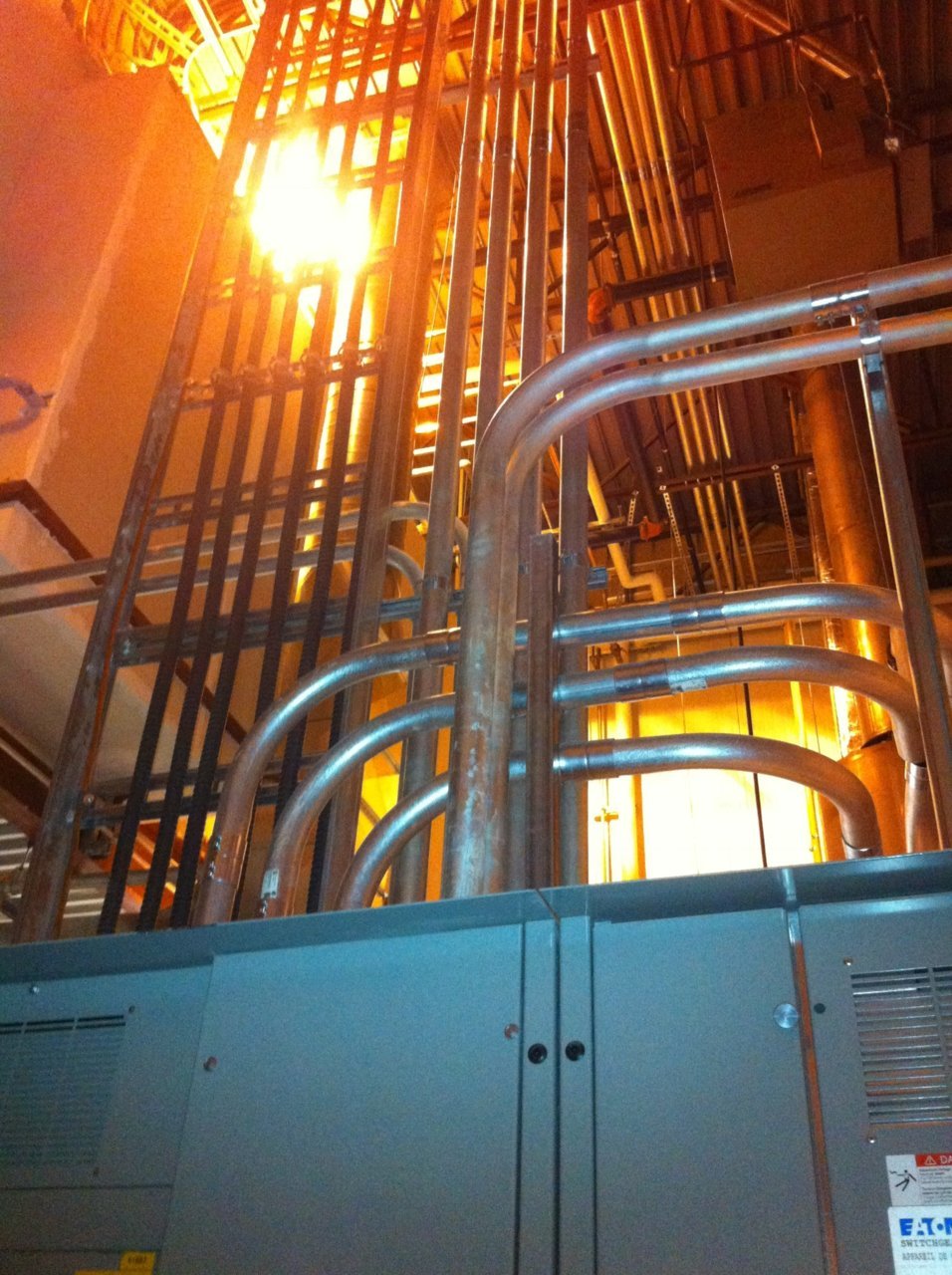

    I have done a lot of panel building in the past so training wires to go where they should and make it look factory was what was expected of us. Just because no one else can see it doesn’t mean you should allow yourself to do sloppy work. In the Canadian electrical code you can fail an inspection just due to poor workmanship even if everything is 100% to code. My panel work was tits and second only to my conduit work.

    Conduit porn is good stuff. And having experience with wires (especially thick 110/220v Romex and stuff) definitely helps. So many jobs that come in to my shop are technically wired right, but wires are just shoved under trim panels and loosely stuffed under the dash. Kills me to see lazy work
