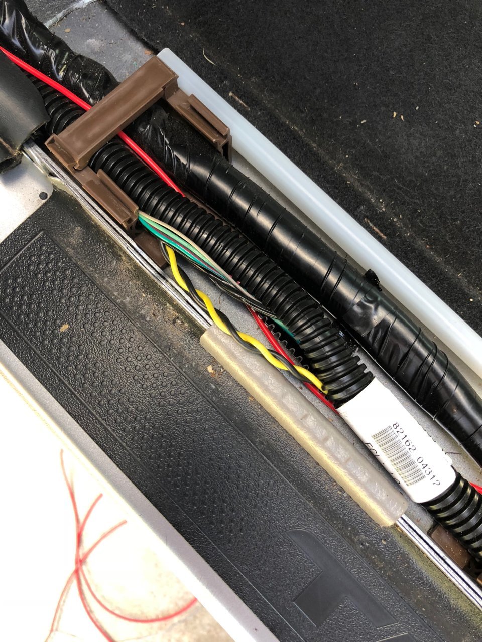

    Would you guys mind giving me your thoughts? I wish I would have seen this thread yesterday! I just installed the hideaway in my 2015 double cab this evening and tapped into the rear speaker wires on both sides...for some reason the High Level isn't sensing the signal and turning the amp on (I have it on DC setting). If I juice up the remote wire it works though. Also, I tapped in the sill plate area on both sides and am 99% sure I have the correct wiring. Left side rear I have Yellow (-) and Black (+), Right side rear I have White(-) and Red(+)...Thanks for the help, just got the truck a couple of months back and this is my 1st post in the group. I looked at the direct techs diagram for the 2013 you guys shared, but wasn't sure if it changed in the 2015 model (i'm sure it hasn't)
    1st photo is drivers side door sill wire loom and 2nd photo is passenger door sill wire loom

    Your wire colors are correct, so my first thought would be to make sure the Input Level switch is set to high. If it is set to low, it disables the signal sensing. If it still doesn't work, you may just be better off running a wire for remote turn on and calling it a day. I've wasted way too much time in way too many cars trying to troubleshoot dumb issues like that when I could have just run the remote wire and been done with it. Learn from my mistakes!

    Thanks for the quick response Destin! I will probably just do that lol. Just frustrating because this was one of the features that lead me to purchase the hideaway. Thanks again for your help man!! I also mounted it behind the back seat, I didn’t want my son kicking it all the time ;)

    I triple checked it all...wasn't a polarity issue unfortunately. Just ran a remote wire and all is good now ;)
