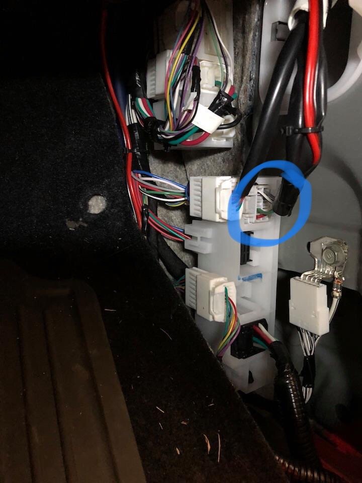

    I got the Hideway and started installing it today behind the passenger seats on my double cab. I got as far as routing the wires to the front by the kick panel on the drivers side but haven't connected anything yet. I have just a couple questions for you guys which I would really appreciate your help with.
    If I were to tap into the speaker wires without the Metra harnesses, where would I do that? Should I just get the harnesses?

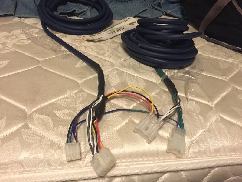

    78523022-1187-4B80-87EF-EB355FA4FCD5.jpg just follow this, you would only need the rear speaker harness. I depinned the blue from the main harness and used it on my rear speaker harnesses.

    Sorry Im not quite sure what Im looking at, since I haven't messed with the harnesses yet. Are these stock or the Metra harnesses? I'm guessing they attach to the head unit?

    These are the Metra, you use the smaller harness. Yeah one end attaches to the head unit, one to the stock speaker harness.

    Looks like getting the harnesses is the way to go

    You can easily tap into the front right door speaker in the passenger kick panel. Looking for this plug, and if I recal, the wires are grey+ blue-
    Just be sure to use a good military splice and a few (small, thin) zip ties. Those T-taps are known to not bite very well.
    All that being said, if you dont want to splice factory wiring, and if you ever plan on doing an amp (power pack, kicker key, or other) making the harness now will make future installs run smoothly
