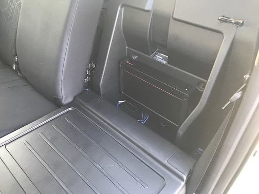

    Where did you mount your amp?

    Also - I noted earlier Dustin that you said you ran a KX800.5 - why run the 5 channel - is the 5th split between the two front tweeters? Or are you running a normal powered sub? Right now I am running the full CS setup (6.75 instead of 6.5) and want to wire in a power pack and the sub underseat. Just trying to ID a quality value component amp to wire in.

    Mine is in the drivers side cubby behind the back seat

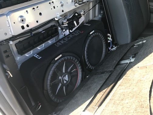

    I am running a passive subwoofer (kicker compRT 12 in the loaded box, 43tcwrt122)

    Did you have to cut the car seat harness for the subs to fit? Also, how is the bass with those?

    I did have to cut the middle and passenger side car seat connections to make the sub fit. I then had a local body shop weld them back on a bit higher to the box had clearance.
    For sound, I am extremely happy with it. I'm only feeding it 400w and it can handle 500w rms, so with a larger amp it could be even better. I mostly listen to rock and it is perfect for that. The sealed box keeps bass guitar and drum sets nice and tight while still having a good hard kick, and the passive radiator keeps the box a bit loose for the occasional bass heavy song.
