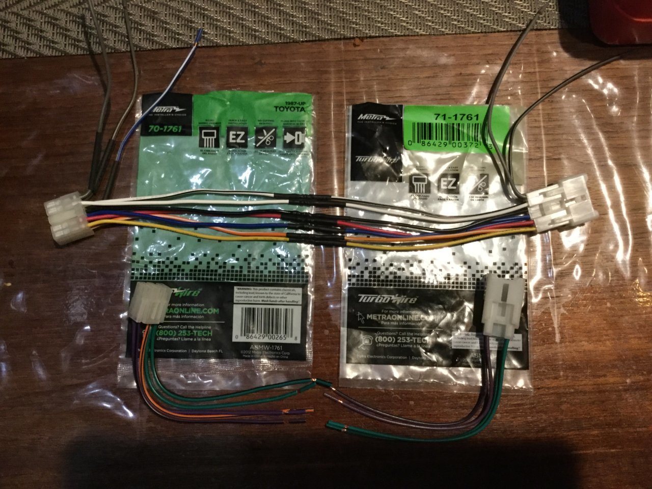

    The Metra harness spike of in that wrote up; is that essentially making it completely plug and play from head unit? Or do I still need to connect the ends from that harness to the hideaway? The picture provided doesn’t show the ends so mom just not sure

    Yes, the two Metras allow you to tie the Hideaway leads into the Metra wires, so you are not cutting/modifying the factory wiring.

    The Hideaway harness leads run up behind the head unit and tie into the Metra harness.

    Question on harnesses from that write up; are both needed just for the hideaway or is one for use with the kicker key. I got a little lost on the write up as he said he used them for both but I am only installing the hideaway. So wasn’t sure if I needed both

    I only used the top harness connectors (two) in the photo to install the Hideaway. I think Exracer2 references needing the other harness (again, two) for the Key install. I can't comment as I do not have the Kicker Key.

    So two of the 71s or the 70s? I was thinking I only needed two of the 70s

    You need to buy both bags, 70 and 71, because you will use one connector from each bag.

    Ohhh so one of each. Got it!

    +1 on the kicker hideaway sub and the kicker key amp. Really brought the sound out. The kicker sub slid right under the driver seat. I installed it there without pulling the seat out. I just fished the wires through the carpet from the driver door sill panel. I didn’t screw it down because it’s pretty tight and I’m not worried about it moving. For what ever reason the passenger seat has something extra under it and I couldn’t get it under that seat fwiw. The sub gain control knob fits nice in the cubby to the left of the steering wheel also.
    Toyota reverse harnesses help with the key amp to make it a little more “plug and play”
    these help
    http://metraonline.com/part/70-1761
    http://metraonline.com/part/71-1761

    IIRC you need one half from each kit for just the hideaway and the same for the key. In the end you use both “halves”. If you follow the Metra wiring harness wiring diagram it becomes crystal clear. I suggest if you do the speakers you do the hideaway and the key. I did the tweeters first and it was great. Then I did the Hideaway and it was more great. Then I did the Key and once again even more great. You are kidding yourself if you think you can stop without doing it all.
