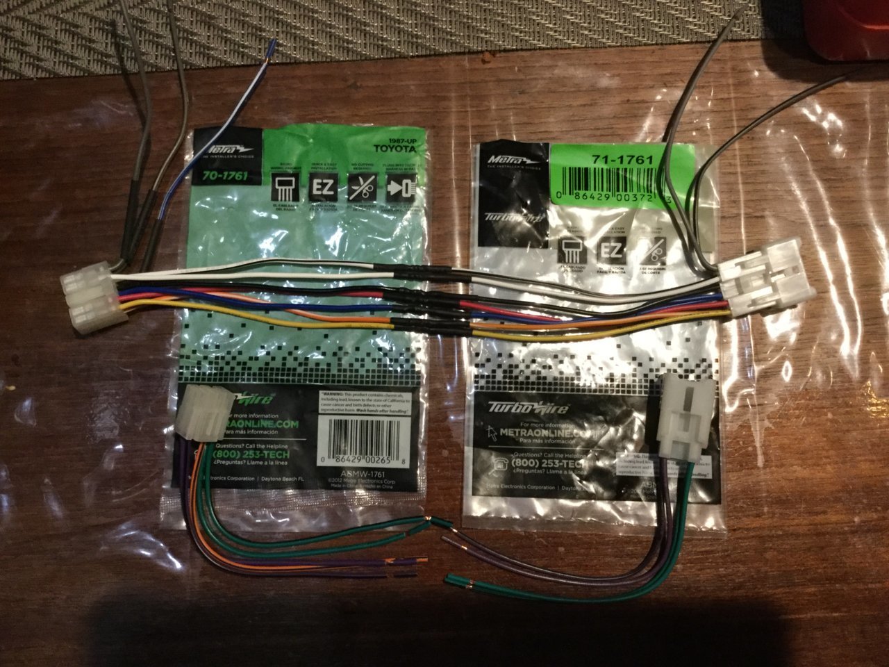

    This???
    Metra 70-1761
    I'm going to be super disappointed if I need this and crutch didnt add it to my custom cart. I was hoping to get a complete set and just figure it out from there....
    How many do I need?

    There are two part numbers. Each one is 1/2 of the required harness that you will solder together. It is all in the other thread.

    Yes those are the TWO harnesses. You match each half and then “T” in your Key and Hideaway connections. One set is the Head unit end and the other is the OEM harness end. Once completed you have one for front and one for rear connections.
    Crutchfield can’t read minds. Some people want to leave their OEM wiring unmolested and therefore they will go for the harnesses. Others will try and save a buck and just scotch lock into the OEM wiring. If you don’t ask you can’t assume they will automatically guess you want it.
