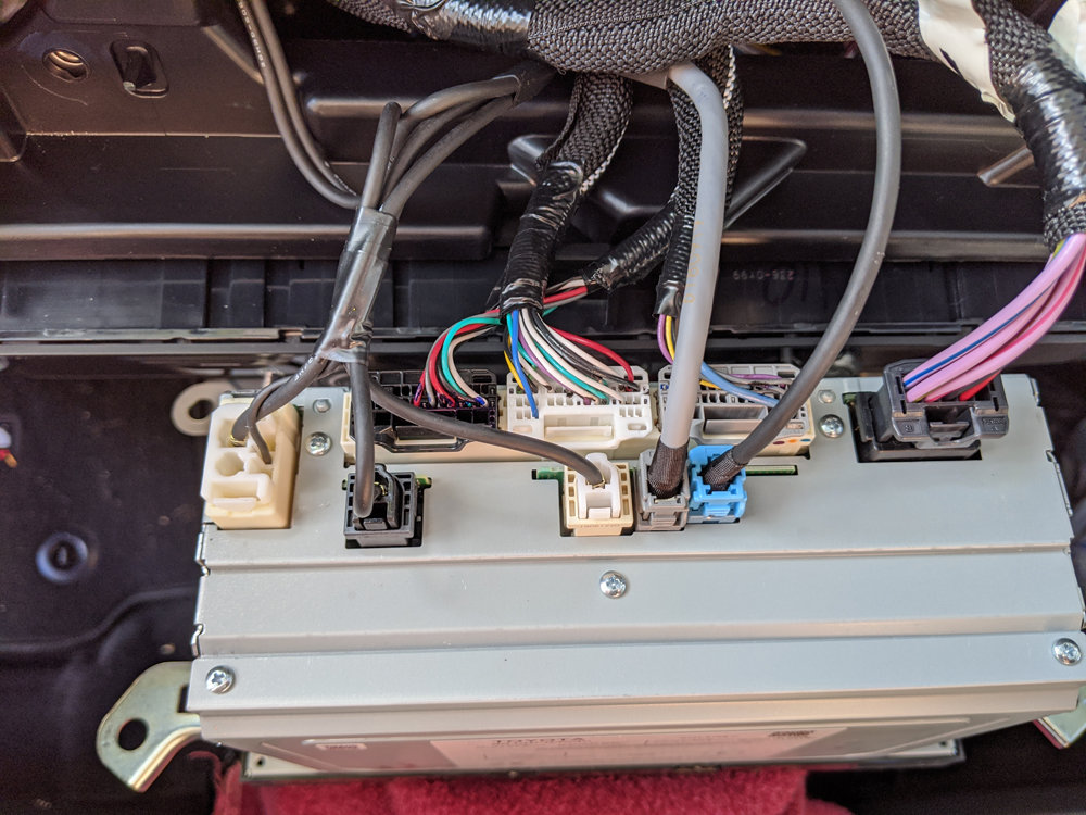

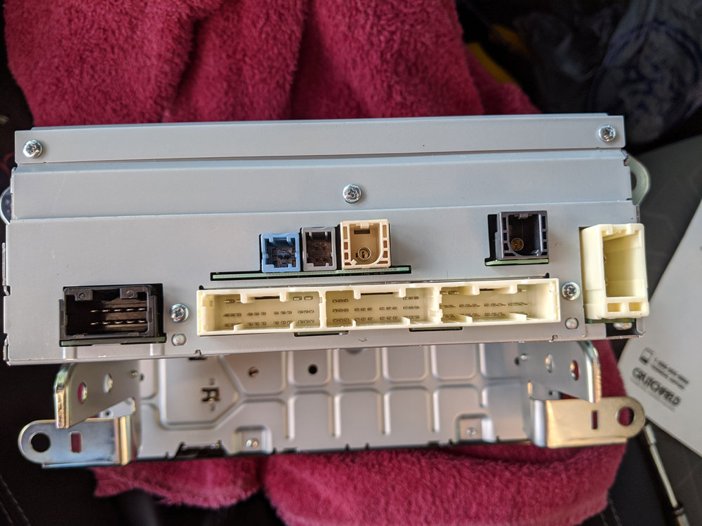

    no its not supposed to be. here's the back connectors with and without wiresIMG_20191130_152403[1775].jpg IMG_20191130_152116[1777].jpg

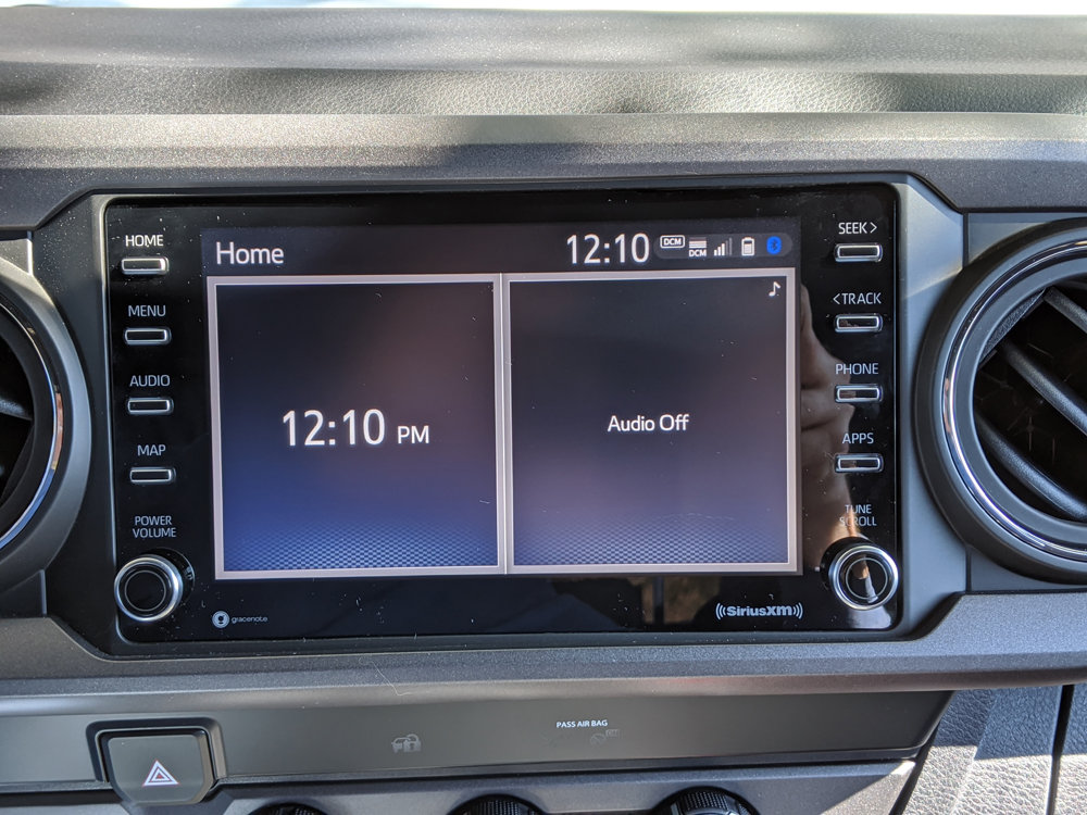

    Interesting. Can you snag a pic of the front face? Curious to see if it looks any different than previous years

    sorry about the dust. static cling is hell

    Definitely new design compared to previous years.
    by the looks of it. It is using the Metra 70-1765 harness. The black connector is conveniently all of the speaker wires. Unfortunately, I don’t think they make a “male” version of this plug so you could build the traditional t-harness

    Just got a response from *********, they say they have the new harness and have shipped it to me. Hopefully good news. Really wanted to avoid chopping up oem wires.

    I did get the replacement. Not sure why the name of the company (rhymes with jaco moons) gets blocked from my posts. destin_meeks, You were correct that the speaker wires all come out the one black connect. So a really simple wiring job connecting the kicker key input and output plugs.

    As an update to this thread
    the connectors ARE the Metra 70-1765 and 71-1765
    you can buy the Taco Toons 2018+ Camry add-a-sub wiring kit as well.
    This is a much cheaper option than buying both Metra pieces. You will be cutting off a lot of extra wiring length, but that’s ok.
