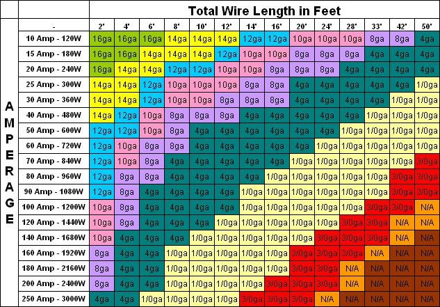

    circa my photobucket account in 2011, stolen from somewhere, but wattage don't change much ;)

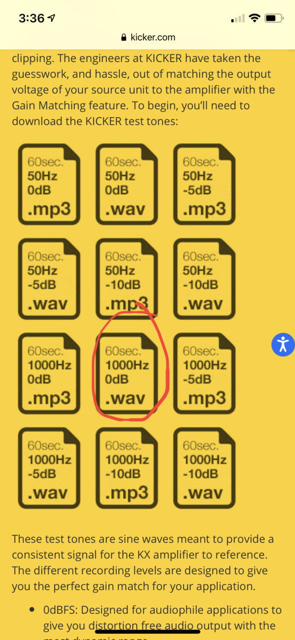

    That's about where I set my gains too. 09:00 front / 11:00 rear
