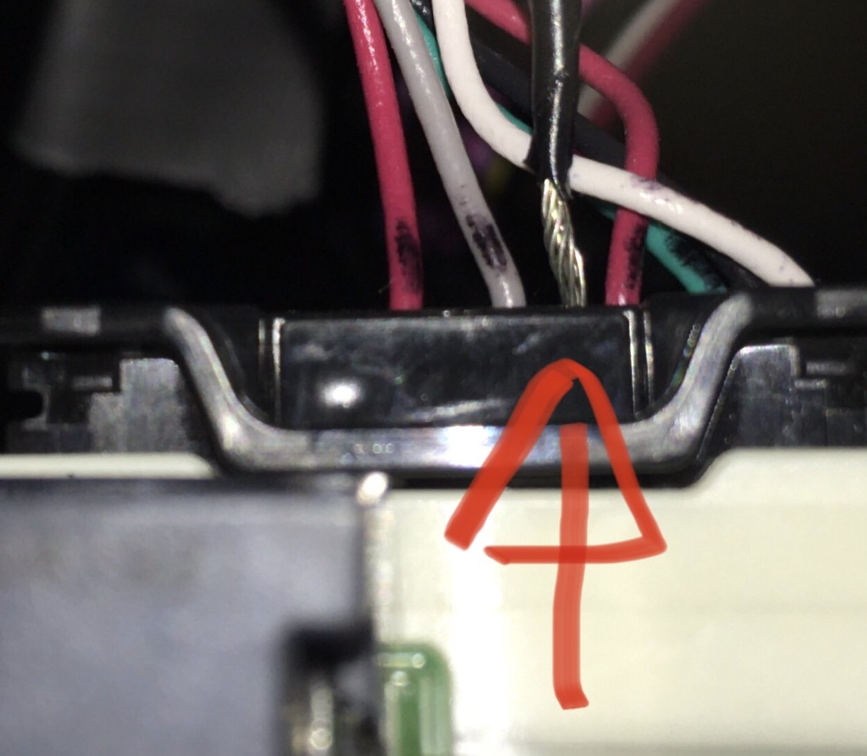

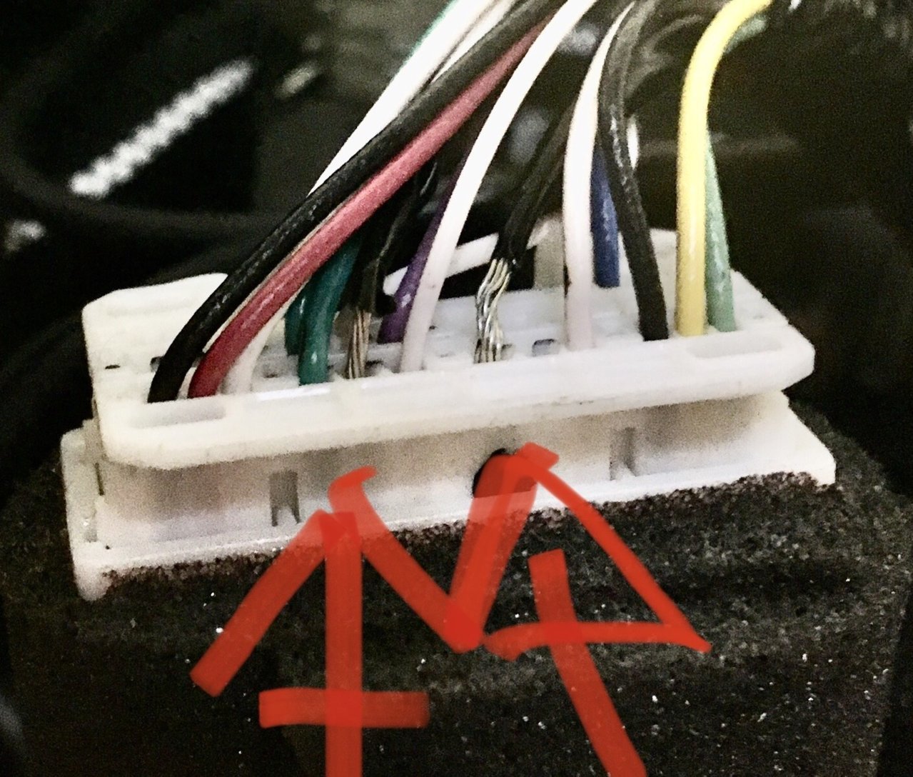

    2. Please see pictures below. Two connectors that go in the back of the HU have 3 black wires where the insulation appears to be trimmed too long and showing bare wire. Should I be worried? These are OEM connectors/wiring from factory.

    Those are shielding wires, not carrying power or data. Typically there will be shielding on the camera, aux, and USB wires to protect from interference.
