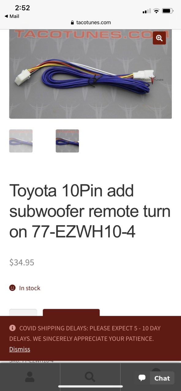

    This one? mwrood, keep me posted. I want to do same thing. I want to add line converter or tap into that harness with key amp now and a subwoofer amp at some point later down the line.

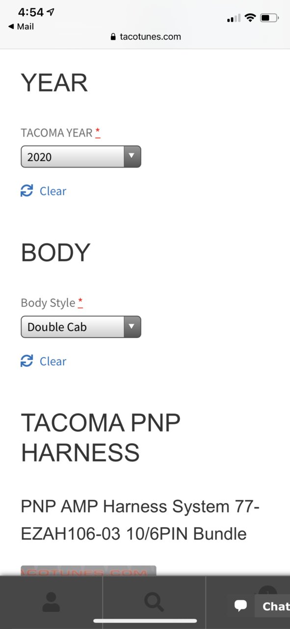

    This is what you need. Don’t pay attention to the 10/6 part. Just make sure you select the 2020 ad the year. It will come with one harness (male and female). 833172EA-4741-45C4-B315-556837805E31.jpg
