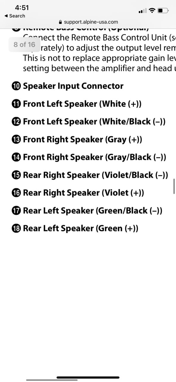

    A quick question? Do you have an idea where to tap a powered sub woofer? ( rear speaker or front ) - 2020 SR5 non JBL 8" Gracenote. Thank you :)

    Absolutely not rear in these trucks

    see image. on a 2020+ there’s a separate harness. it’s black with 8 wires. you can tap it there
    Tachcoma likes this.

    gracias. I changed my rear speakers ( kickers) and not much sound coming out from the rear speakers. I was thinking because it is a powered sub the source is negligible?

    it’s a toyota thing. super wierd even with jbl pro audio and lower in rear
