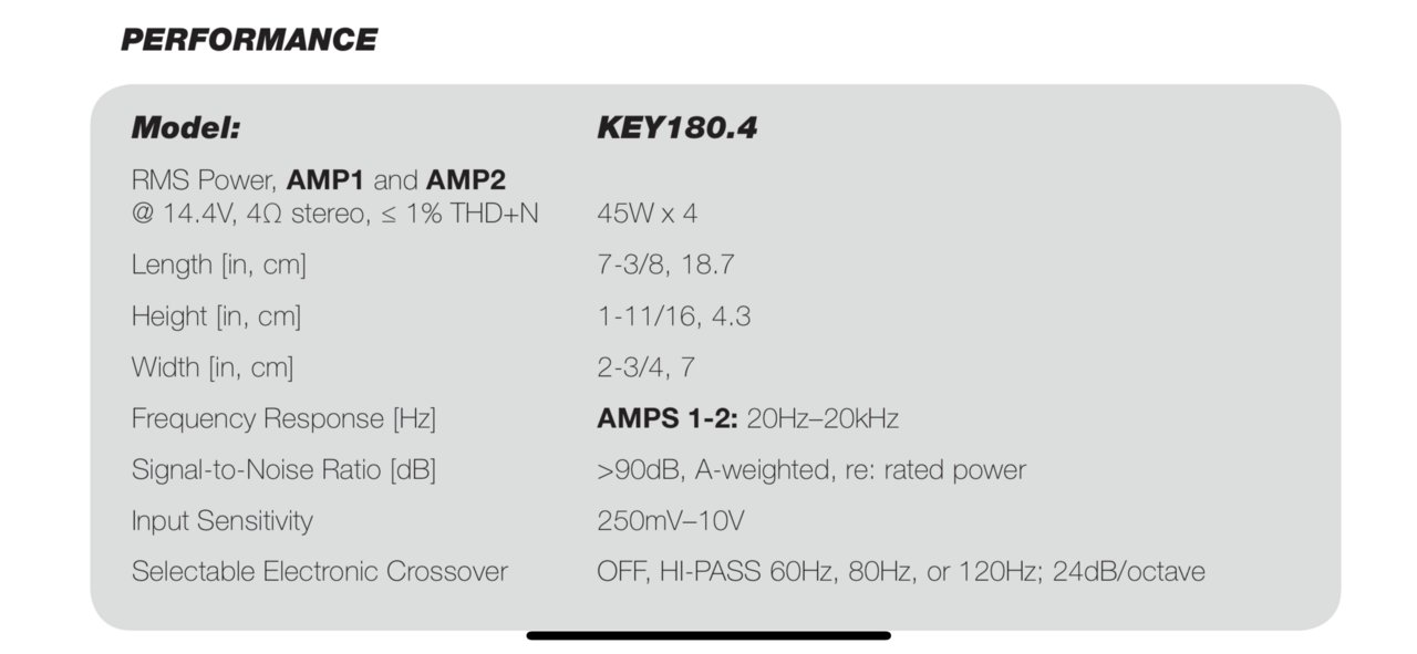

    Is the kicker key 45 W per channel RMS? The only thing the website and manual state is 45 per channel. All other kicker amps that I've looked are very clear about the ratings being RMS. I just emailed Kicker support and will report if I hear an answer.

    Yes, 45 rms

    Here’s a pull from the manual

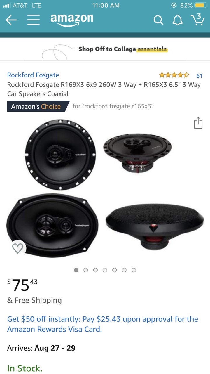

    looking to get new door speakers think i’m going to get these rockford fosgate’s i have a 2015 entune radio and was looking at amping them.
    anyone able to guide me in the right direction on an amp been reading about these power packs. and also i have no clue how to install to a factory radio. anyone able to help?

    Nice price on those speakers!
