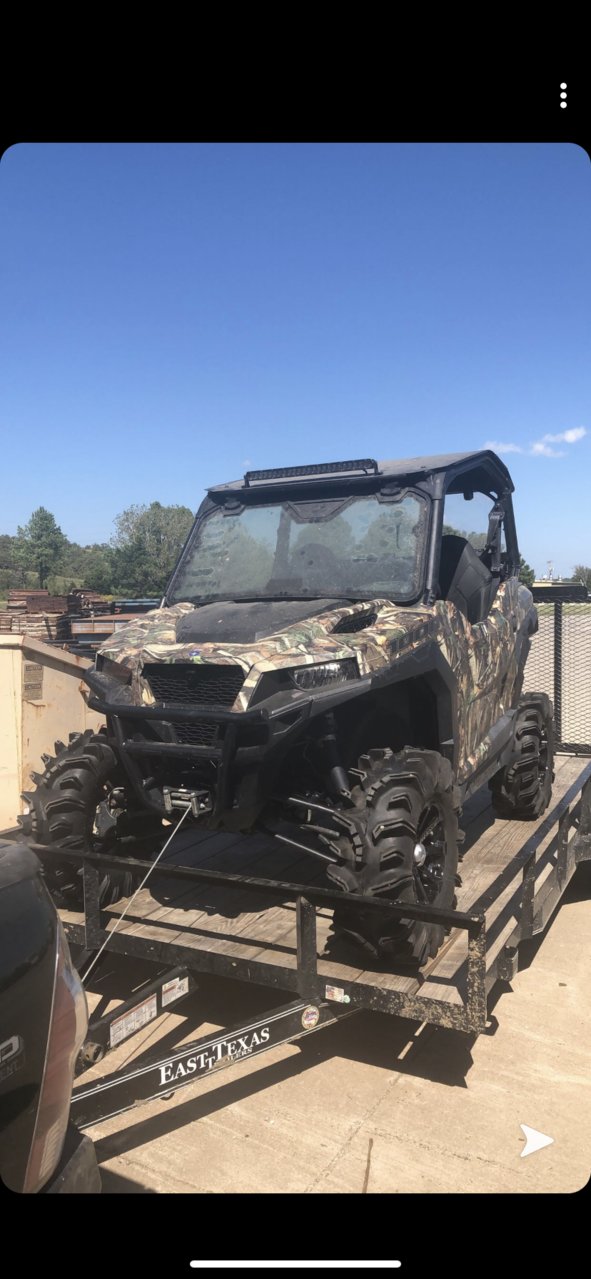

    Here’s how the buggy looks before i start this round of mods. Since we’ve talked about it enough lol. Building a chopped cage (9” lower flat top) lowered seats. Recessed roof light bar. Wake tower km8’s. Ssv works kick panel 6.5s glassing a enclosure to fit the factory doors to mount another set of 6.5s. Decided to go with the kicker pxa300.4 bridged for each set of km8’s gonna wore them up to be able to completely turn them off when i don’t want them (basically just for rednecks with paychecks type stuff) and a kicker 300.4 running four kicker 6.5s in the cab got everyday use.

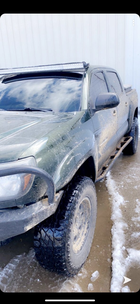

    Here’s a updated picture of the truck since i haven’t posted one in a few years
