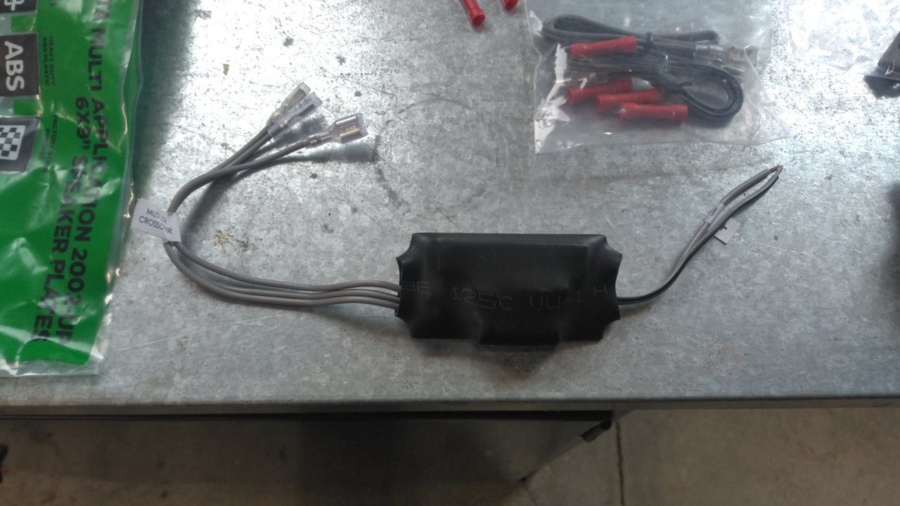

    So I just got my ks 3-way door speakers and noticed the 6x9's come with what looks like a separate crossover board bundled in heat shrink. I have the Subaru tweeters, is this something I will need to wire in ? The direction don't even mention them?

    Are you talking about the back of the kicker speaker? If so there’s nothing you need to wire in, just connect them.
    I just changed mine, got them at crutchfield and they came with the brackets and plug in connectors. Pretty easy.

    So I called crutchfield tech and the kid didn't know what I was talking about at first then he was reading through his notes and it stated it must be hooked up or it could possibly damage tweeters if not. Why wouldn't any of this be in the directions is behind me. Maybe I should call kicker direct. Not sure if it's a KS series issue apposed to the CS. Thoughts?

    Just got off the phone with kicker and they highly recommend using them. They said the CS series 6x9 3-ways don't use them.

    I wired in the cross overs and it sounds great. I have KS kickers for all speakers now.

    But looking to install KS speakers for the front doors and tweeters and want to double check before I open things up. Did you wire up the crossovers for both the doors and tweeters?

    Sorry. Just saw this. I did for the doors. I don’t remember for the tweeters. However, if it came from the kit, I wired everything. Sorry not more helpful
