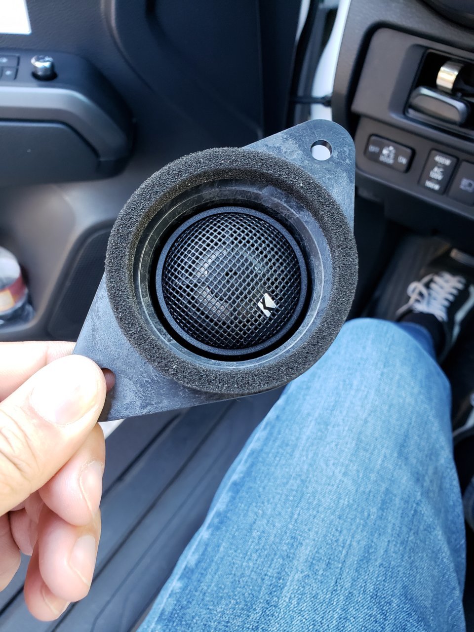

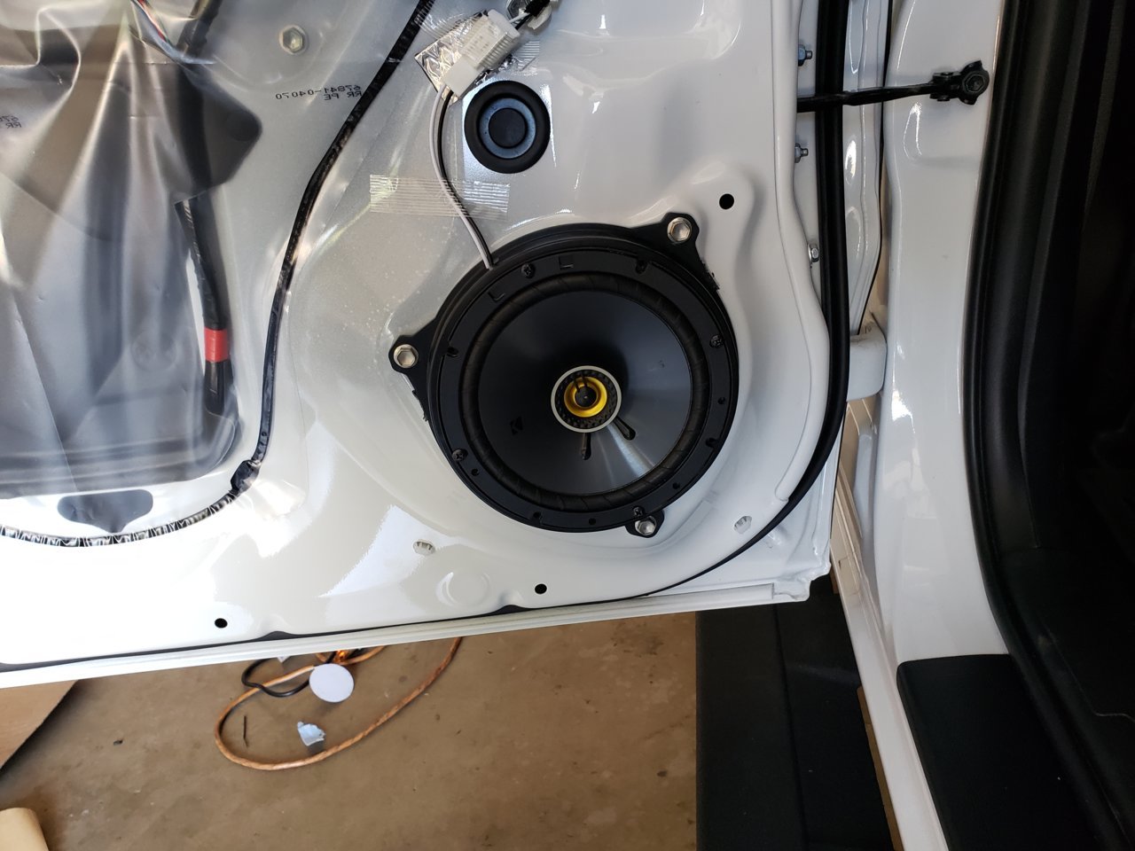

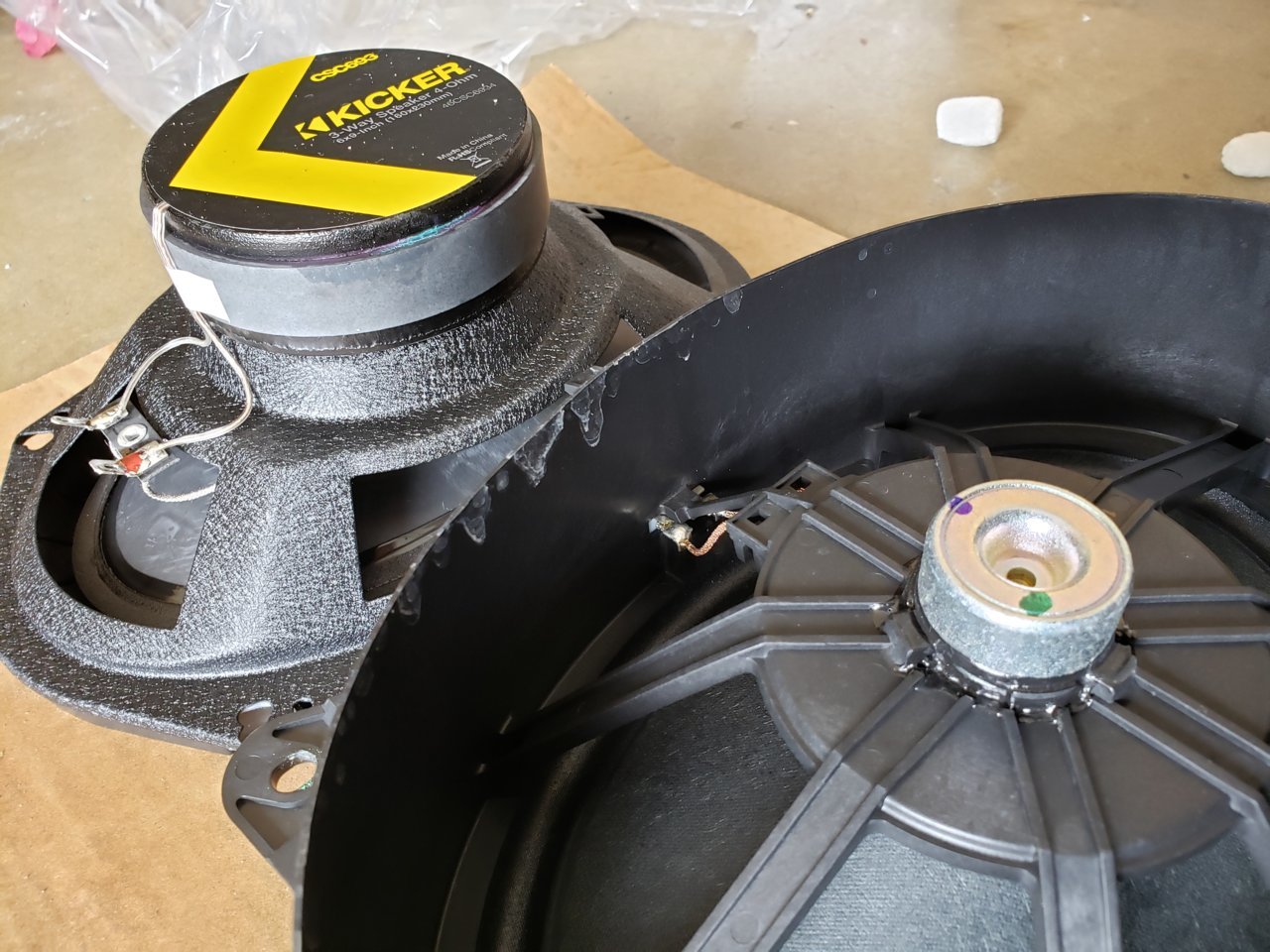

    I just got done installing kickers tweeters and kickers door speakers.
    The quality of sounds will be noticeable right away. The bass of woofers and tweeters increased, crisp and clarity is way awesome!!!
    It's perfectly loud enough for me, I usually have kids at the backseats... I have no use for subwoofers but for sure this set up cost me around $225 is worth it!!!
    I highly recommended, I would say less than 2hrs install for 4door speakers and dash tweeters.

    So question, some people experienced that the brackets for the new Kicker speakers doesn't align with the holes on the door. Is that true? I can see that yours aligned perfectly.

    I think you mean the inner screws. The door holes seem to align for people, but people mention that the screws that mount the speaker to the adapter are not perfect. For the Kickers they arent and you just need to leave them loose until you have all the screws threaded a little. You'll also have to angle them when putting them in. I recommend getting bolts and nuts for mounting them rather than using the screw and the speed clip Crutchfield supplies. Their speed nuts are too small and dont actually captivate the screw but rather just hold onto a thread or two. Bolts are harder to thread in because the threads dont have a driving angle to them, but bolts with nuts hold the speaker securely.
