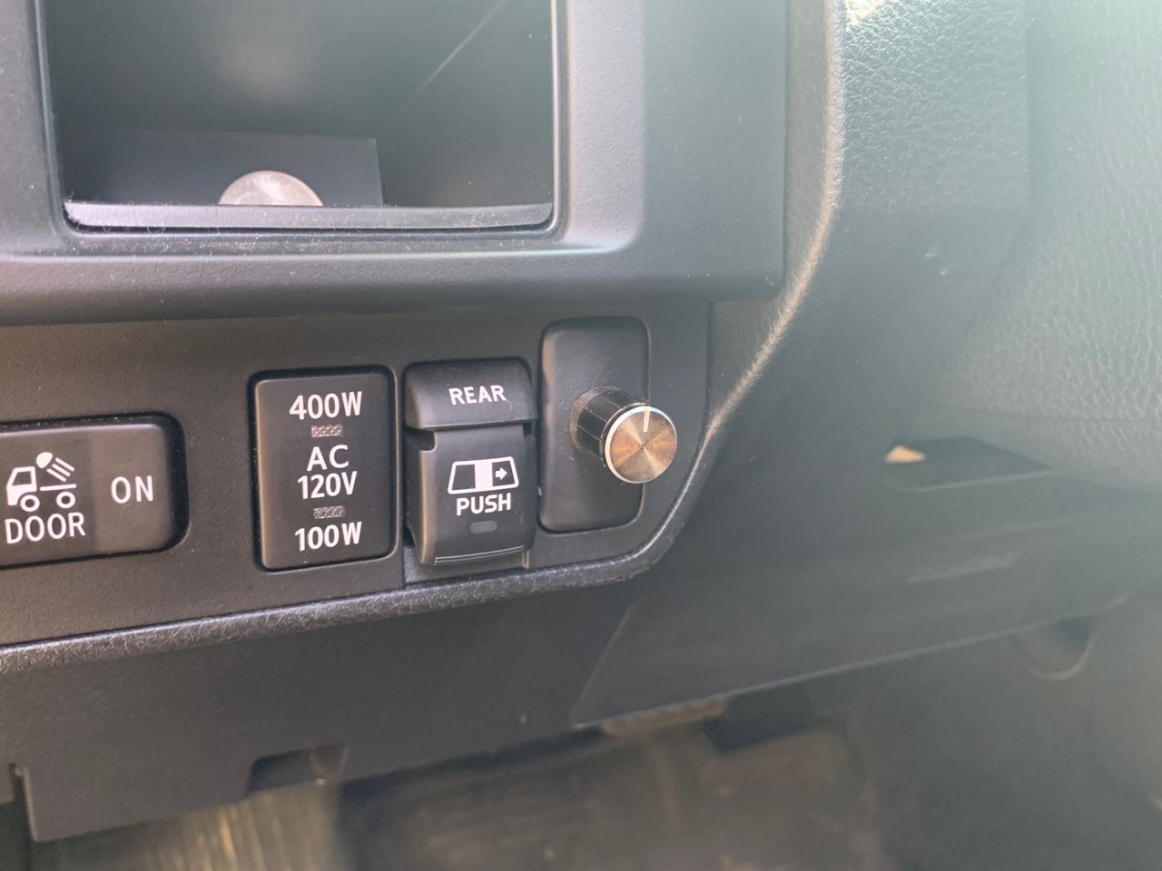

    I have 2 kids as well. I installed a Bass control knob so I can turn it down if kids are in the back and turn it up when I'm alone (or just with the wife).
