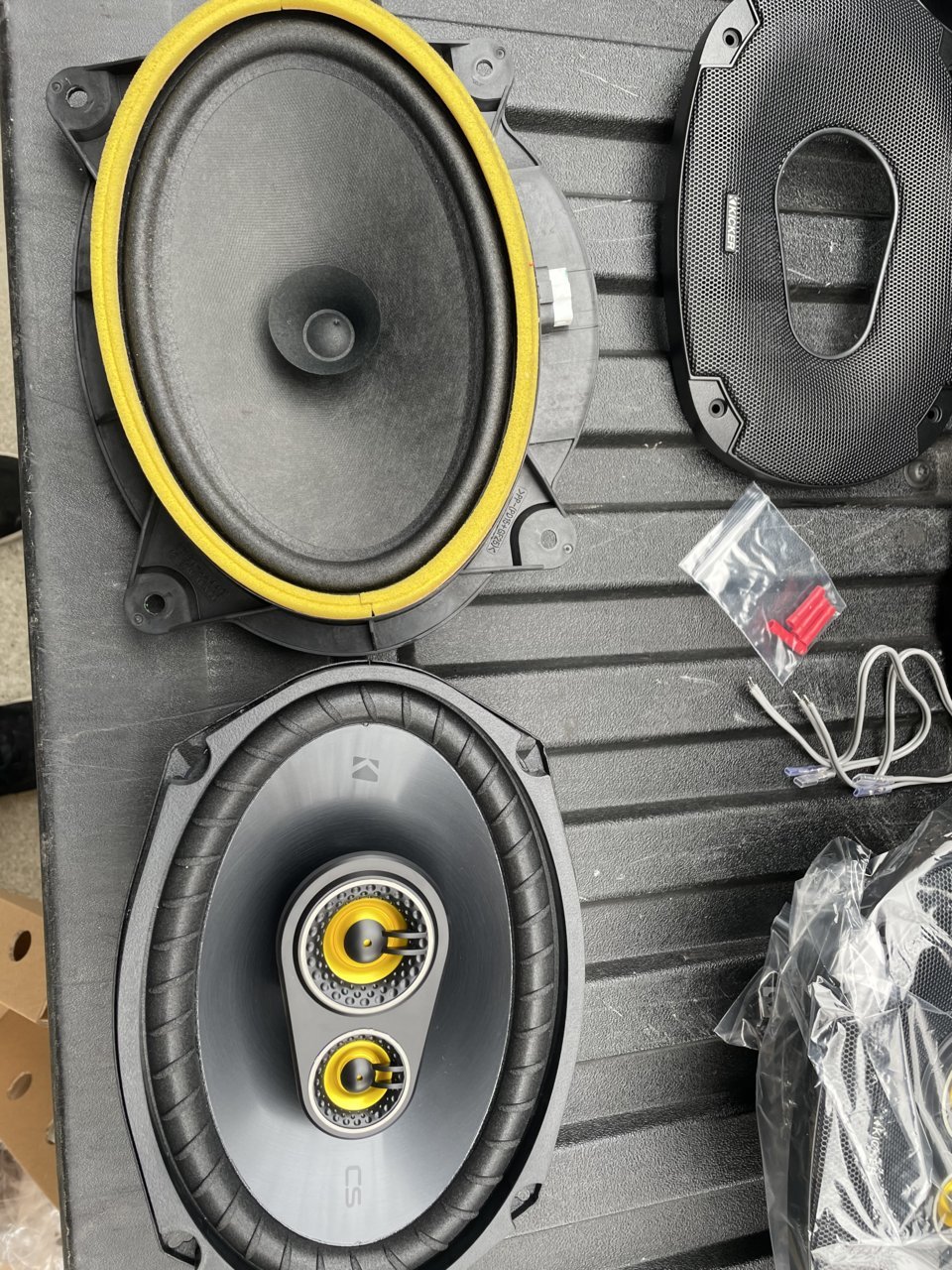

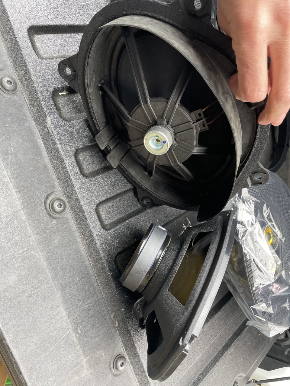

    The adapter brackets lined up with the holes in the door just fine, but the 6x9 speaker's mounting holes didn't line up with all four holes in the adapter no matter what I did. Ended up drilling a new hole in the adapter. No big deal.

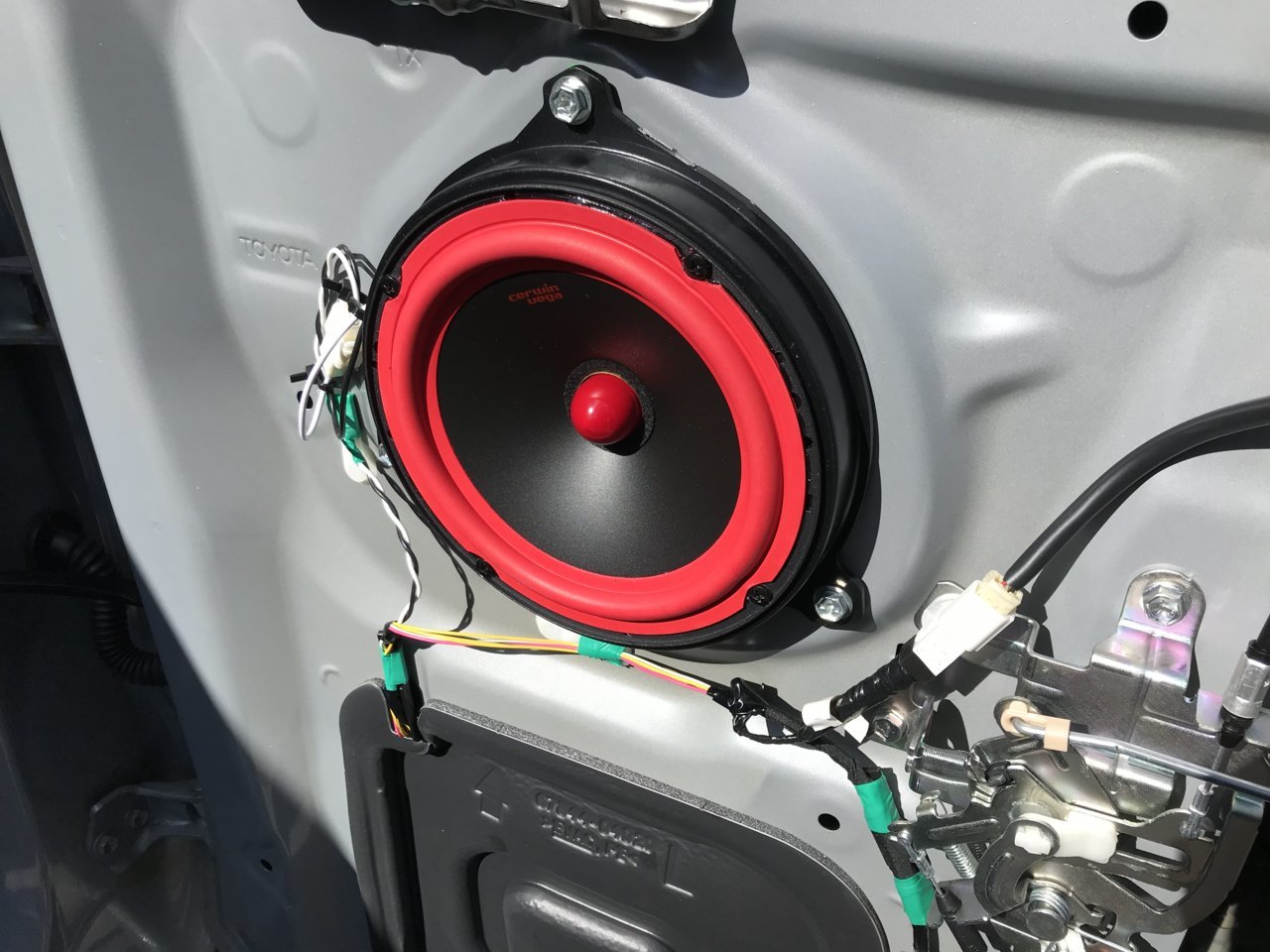

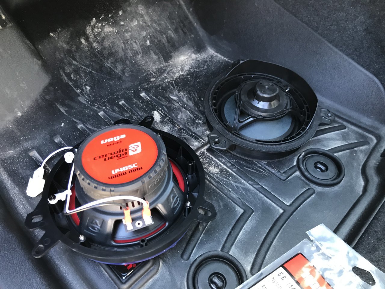

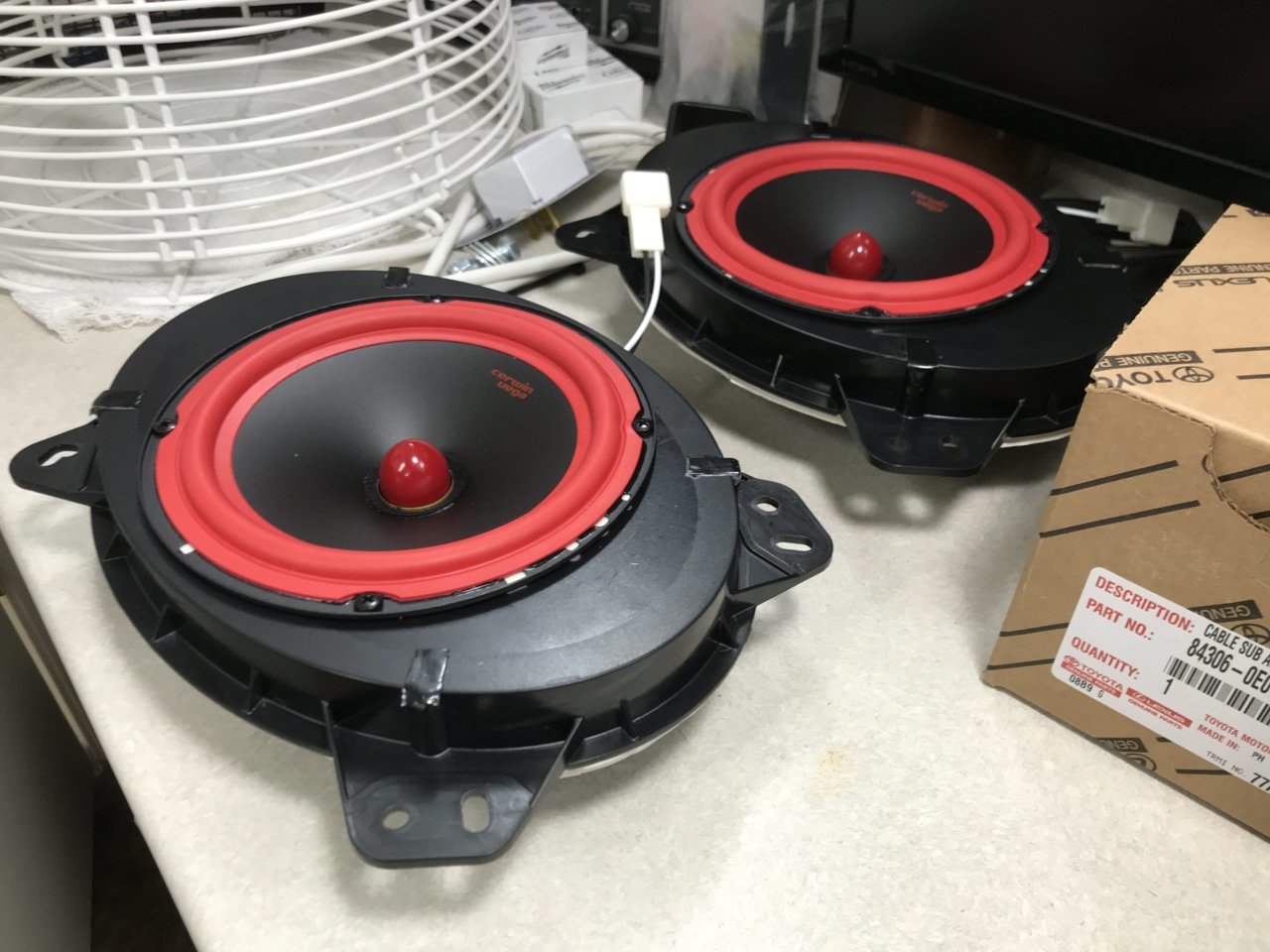

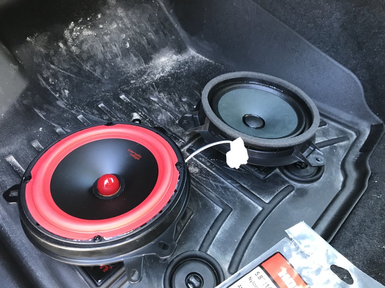

    I replaced the factory door drivers with 6.5” Cerwin-Vega midbass drivers a month or two ago, and the sound quality difference and additional bass I’ve gained is astounding to me. I used a thin foam tape to seal the drivers and bracket to the door as well. A week or so later I did the Subaru tweeters mod and the sound just got even better. The stock Entune units amplification pushes the speakers pretty nicely. I was surprised, but the woofers I used have a good sensitivity rating. The little cups behind the inside door handles is the only rattle I’ve had, and a small strip of foam tape behind them eliminates that.

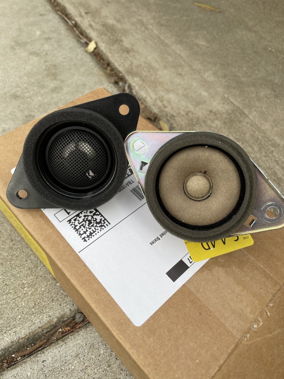

  16. Mar 14, 2021 at 1:12 PM
    #96
    Maffee88
    Maffee88 Active Member
    Apr 12, 2019
    #289890
    42
    Michael
    Calimesa, CA
    2018 Tacoma SR5 DCLB
    3" Bilstein 6112 and AAL 265/70/17 OVTune and CGS Exhaust
    I can’t believe it took me so long to do this mod on my 18 SR5. Factory speakers are crap and these kicker speakers and tweeters sound awesome!
