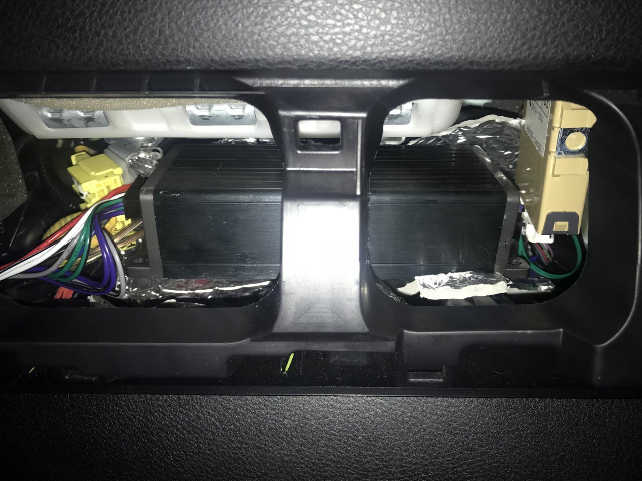

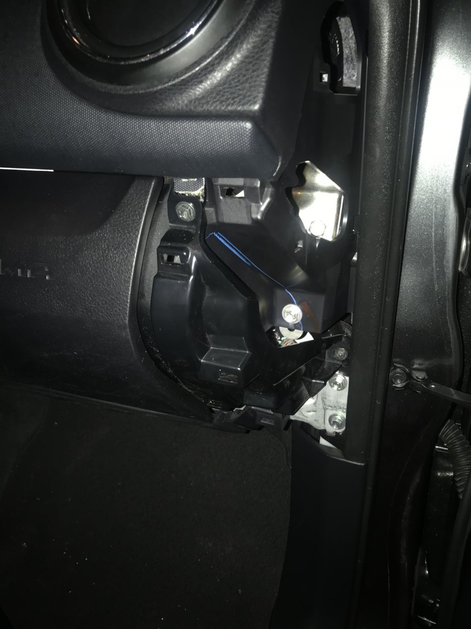

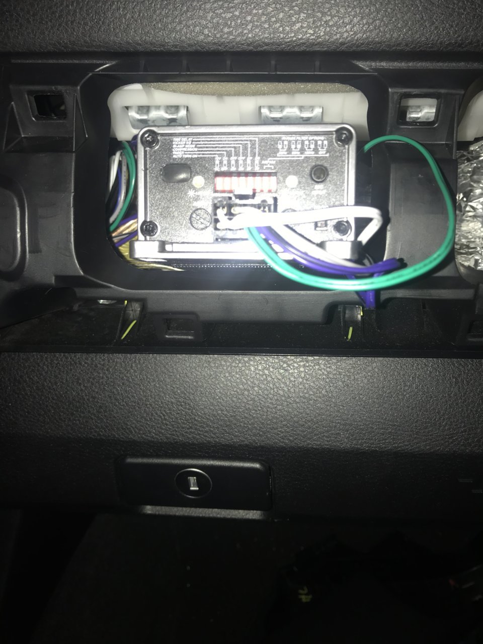

    I put mine above the glove box also. I have to get back in there to adjust so I’ll snap some pics when I do. Maybe this evening if I have time.
    02Duck likes this.
  18. Dec 2, 2018 at 5:15 PM
    #18
    Bach88
    Bach88 Well-Known Member
    Feb 8, 2018
    #243814
    81
    Florida
    2016 Tacoma OR DC
    You have to remove the plastics on the side of the glove box to get to the screw for the padded panel then you can pull it right out.

    How hot does it get inside there? You might want to leave a thermometer in that little area to see what the ambient temperature is over time.
  20. Dec 2, 2018 at 6:46 PM
    #20
    Bach88
    Feb 8, 2018
    #243814
    81
    Florida
    2016 Tacoma OR DC
    Well I live I Florida so it’s gonna be hot most of the time. The ac ducts are right next to it on both sides so I figured it would be ok. The manual says it has built in protection from overheating so I’m assuming it will just shut off if it overheats. Right now it’s sitting on a piece of pipe insulation so it doesn’t rattle around. When I finalize the install I will remove that and zip tie it in place.
