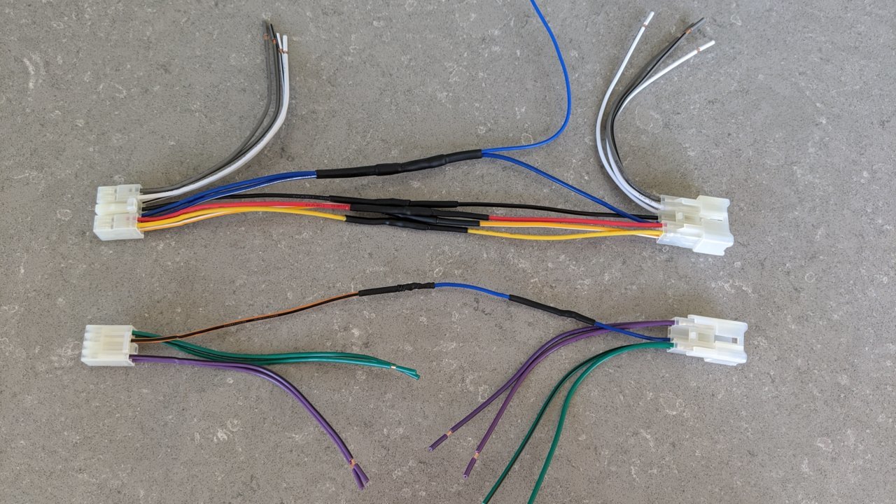

    You definitely need it. The yellow, black, red, and orange wires at 1 and 3 are getting ties together because they are providing power and all that to the radio itself. They are just going straight across without touching the Key
    Like so

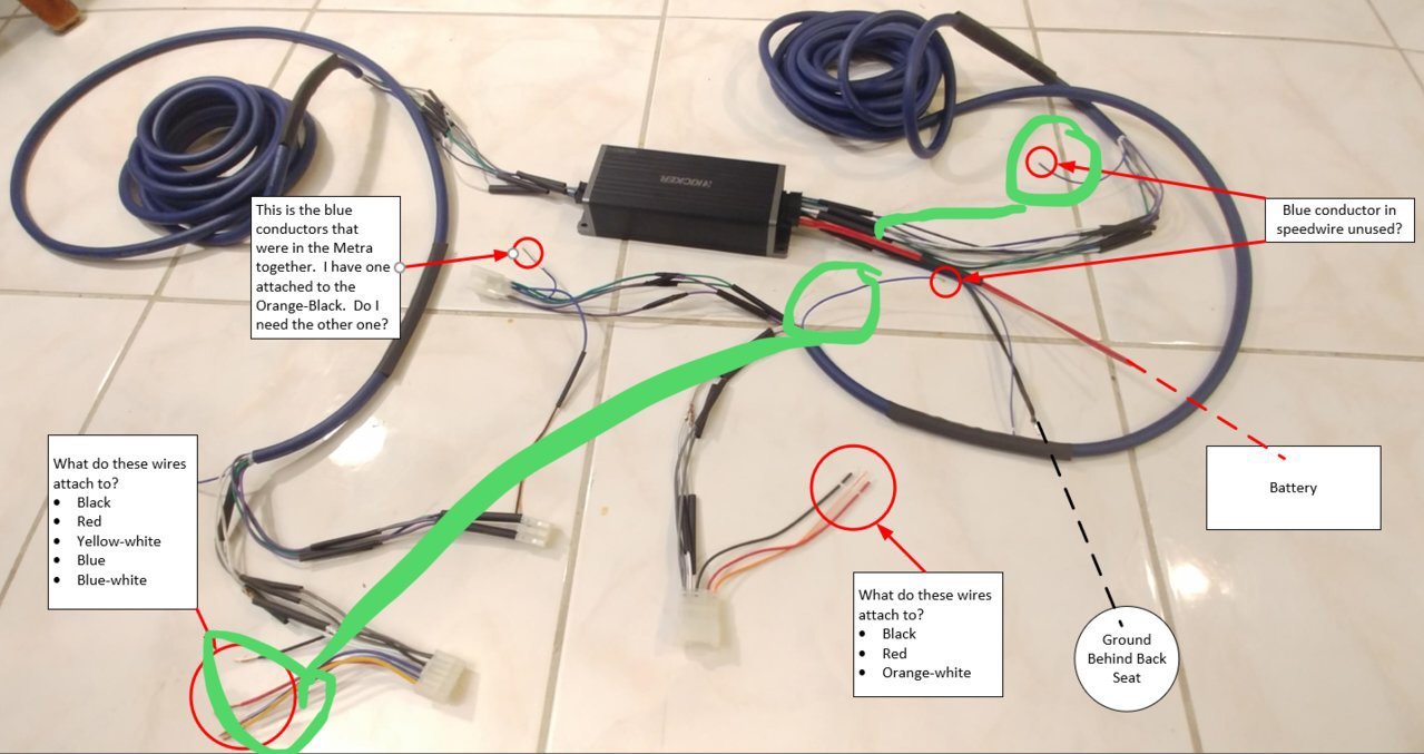

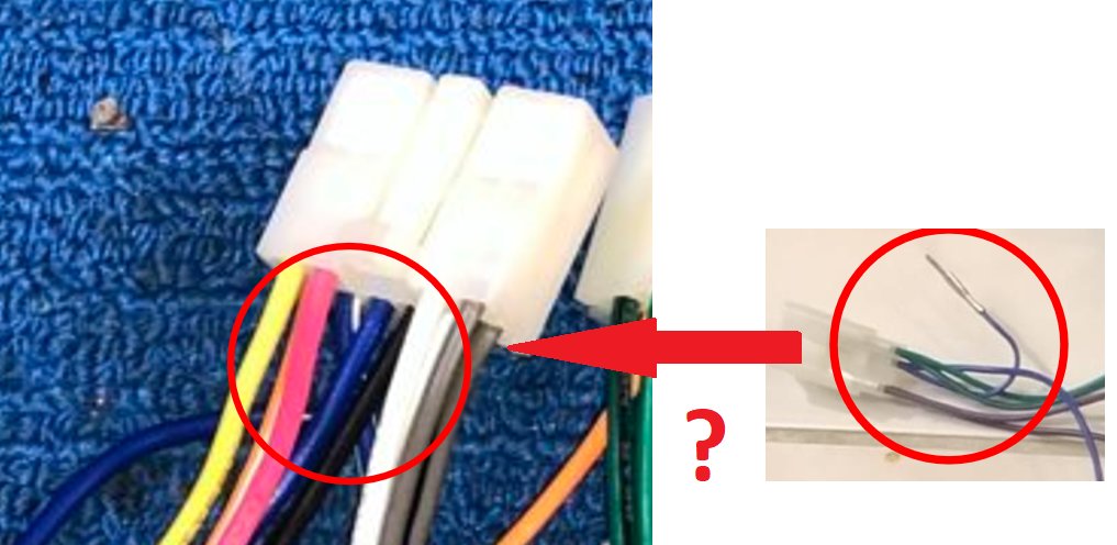

    In your harness, did you cut the additional stacked wires that were in the single slot (forgive my not knowing the exact terms) and add them into your harness like I have the arrow pointing here? Also, I see another blue wire (which I don't have marked) coming from a splice, where is it leading to?

    yes you can cut the small loose wire in your picture.
    as for the blue wires in the larger connector, you only actually need one of them on the male connector (which will splice into the speed wire headed to the blue wire on the key
    These wires are 12v outputs from the factory radio for amp turn-on and powered antenna. If you don't have JBL, you don't need the amp turn-on, and our antenna is powered through the actual antenna connector which we aren't dealing with in this install.

    Thank you for being so patient Dustin. If I am getting my power from the battery, do I still need the blue for amp turn-on? Also, the blue for the amp turn on is going through the male side. I am praying I have just wired my harness completely backwards as that appears to lead to the smaller of the black connectors to the amp, and the smaller connector doesn't have a blue wire.

    you will still want the amp turn-on wired up.
    your harness is wired correctly. The only place that can get confusing is that blue turn-on wire. it needs to go from the male connector over to the other roll of speedwire. It may need to be extended but no biggie. Then the other end of that roll needs to tie to the Key blue

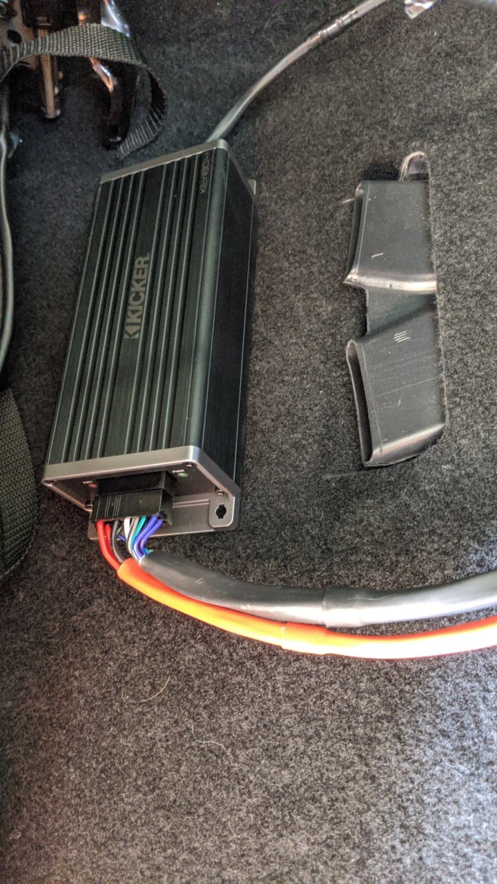

    Holy double-shit. I got the amp in, along with sound deadening the back wall, and this thing sounds spectacular. Below is the final product of the harness.
    As a side note of humor. My son (15 years old) is next to me when I go to perform the auto-setup. I start the pink noise, beeping starts, close the doors and tuning begins. It gets to a certain point and everything just stops, no more noise at all from the truck. So, I start looking at the book and reading the troubleshooting section. Put my head directly beside the front door where the speaker is located (in case it paused for some reason to process) then look up at my son, and say, "Not sure why it stopped, this thing should keep going until we hear a happy tone". He looks back at me as if I was the new jester of the court, and asks me, "Are you serious? Its blaring at a super high pitch". I just stare, "Hearing loss is the byproduct of a misspent youth."
    One of the reasons I bought the speakers was for better, more crisp highs...at least the kids will love it!
    This setup is great. I really sincerely appreciate the help you guys have provided.

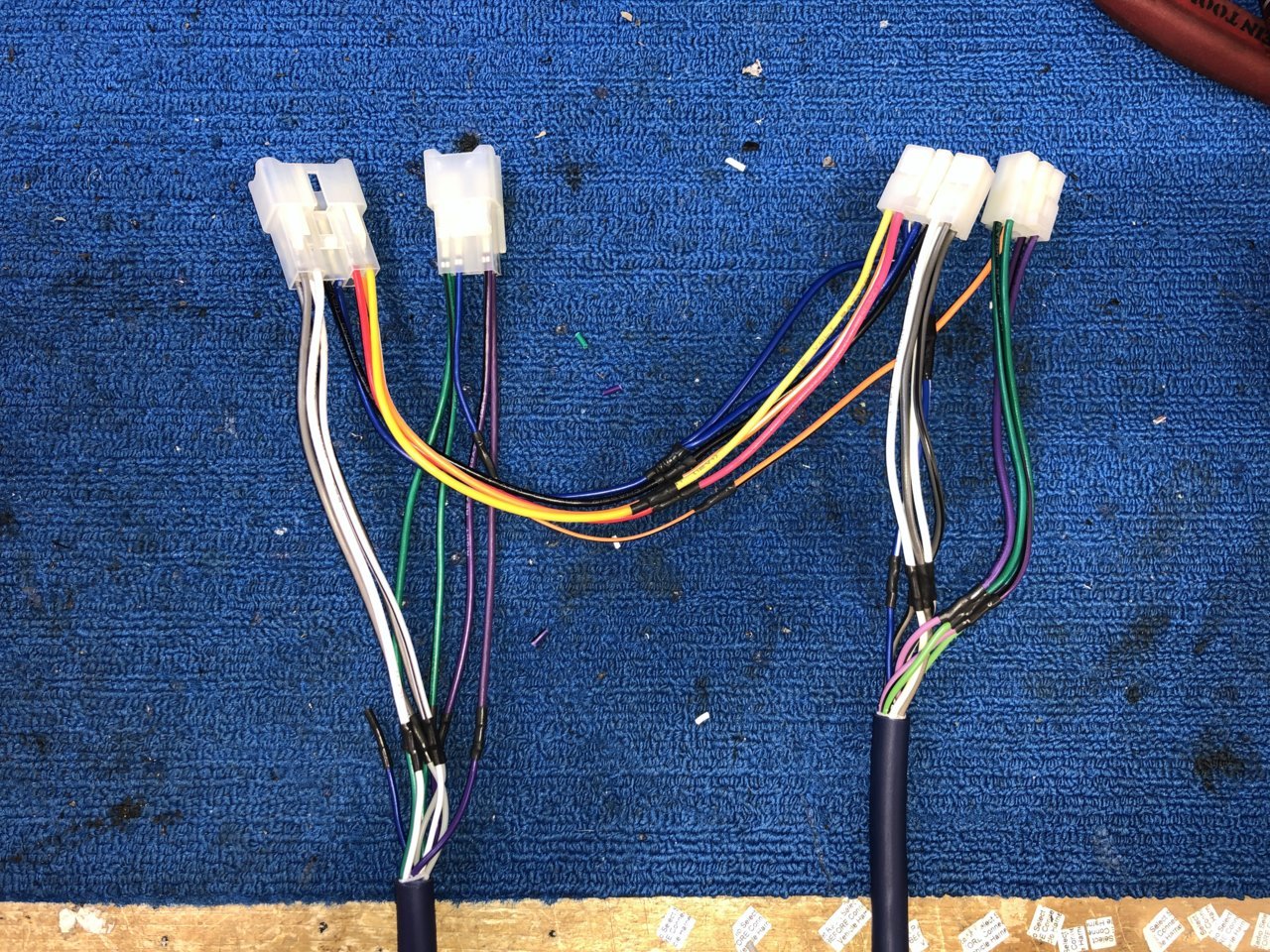

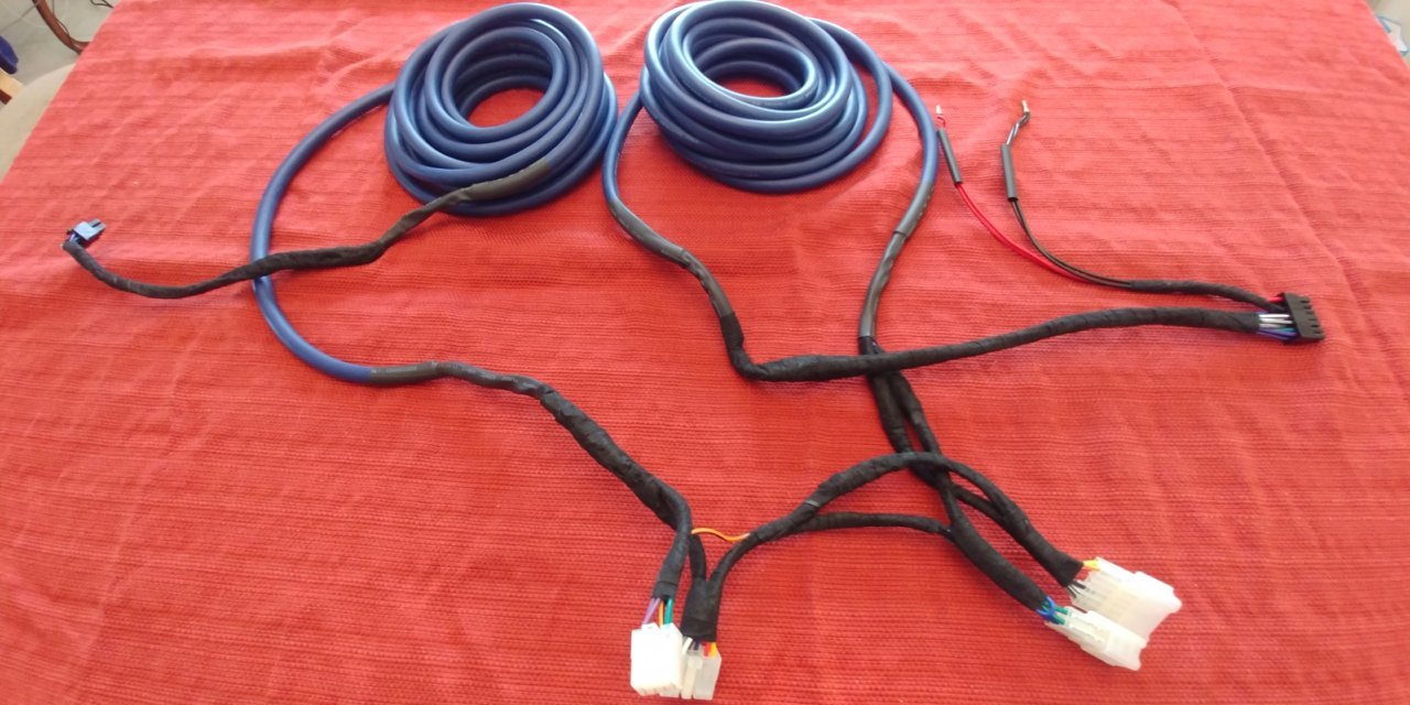

    Other than connecting the speaker inputs and outputs to speedwires; how's my harness look?

    I'm assuming you're getting power and ground for the amp elsewhere, which is perfectly fine
    As long as that's the case, I'd say that's one good looking harness!

    You even got your blue remote wire pigtail on the correct side! Props on that one!
    I’m not crazy that kicker put the remote wire in the output harness and not the input harness. But they didn’t ask me for my thoughts so oh well
