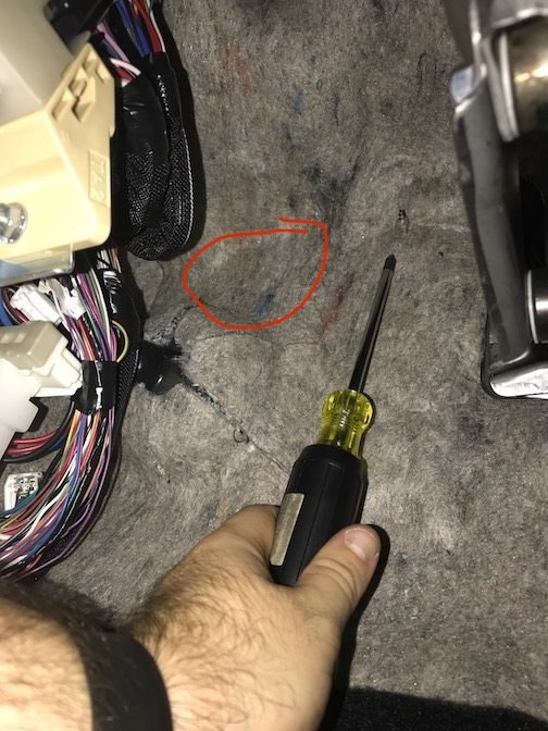

    There is a screw poking through at the top of the screwdriver. That is the grommet location i mentioned. The circled area is where the kidney shape is

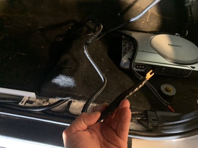

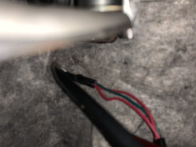

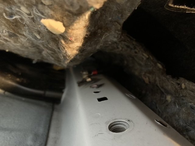

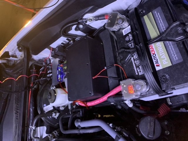

    41A148F2-7406-4865-B6E8-B69035864D4F.jpg Well I’ve done it froze my ass off and still thawing our but this thing is just exactly what I needed it sounds AMAZING! I’m tired af and I’ll probably wake up sick in the morning but what a relief I really made that seem much harder than it was and idk why I can’t use punctuation right now lol I tapped into the right speaker wire behind harness using T taps I took my time and ran loom and flex tube around everything I ground under seat where a ground was already made but I sanded the heck out of it to make sure I had a good solid ground super excited to be done with this I’ll have to bolt seats back down and rehang and straigten up some of the under hood wiring. Installed lights under hood tonight also just and led strip from wal mart in the morning was too tired I’m out! It was nearly 3 am when i finished EA77D294-7E5A-46DD-B82E-02D89AC8519E.jpg 38D29679-FE07-4CBF-BAB6-709E38FE8EB8.jpg E5D9F207-95B1-49DC-807D-72CAC1ABB41F.jpg

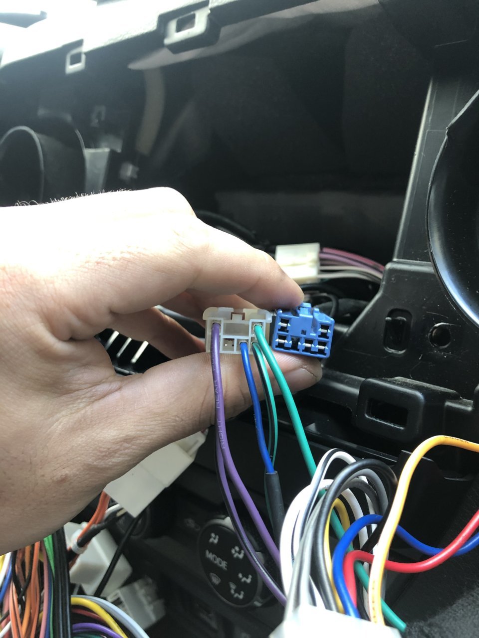

    On my small connector for the key harness I have on pin on the lower row that goes into a blank spot on the trucks harness; and vice versa on the other connector. Should those make contact or are they supposed to stay “open”?

    Can you grab a pic of what you’re referring to?
